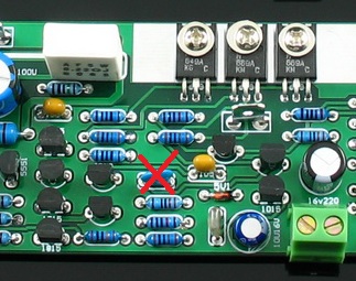

No, I don't know the different ones. As the discussions progressed, I know Ljm recommended removing a capacitor in a specific location, then I imagine he made small adjustments.

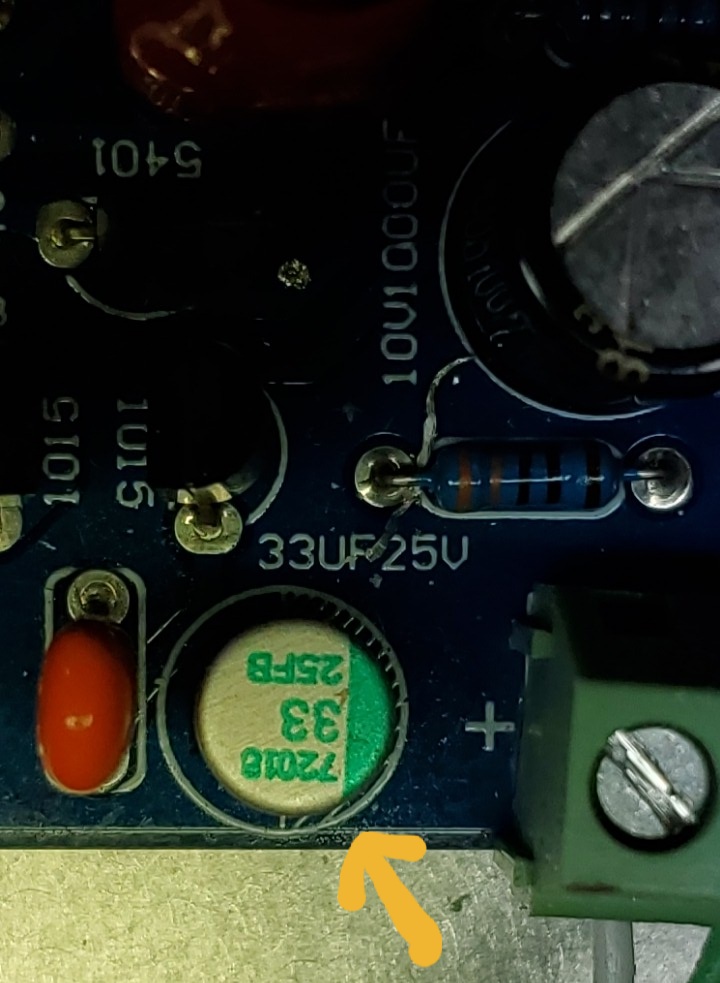

I received my parts for the bypass on the condos as proposed by Calvin's. Also I received Elna Silmic II 33uf 25v to replace the signal input one. I put a photo with the value on the pcb.

You said a capacitor removed; This cap. was in the early versions. It changes the bandwidth of L12, it's not related with any current of L12.

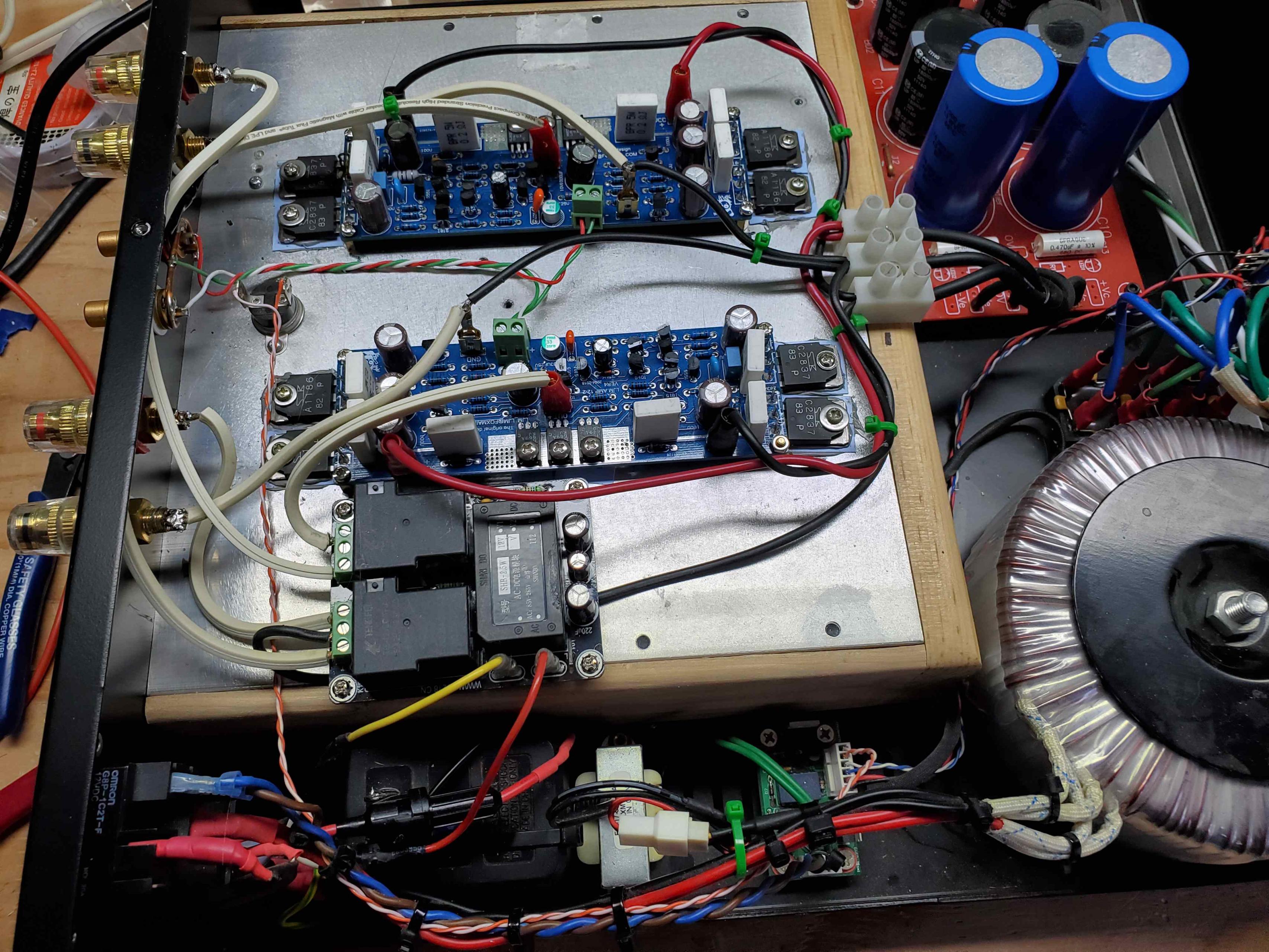

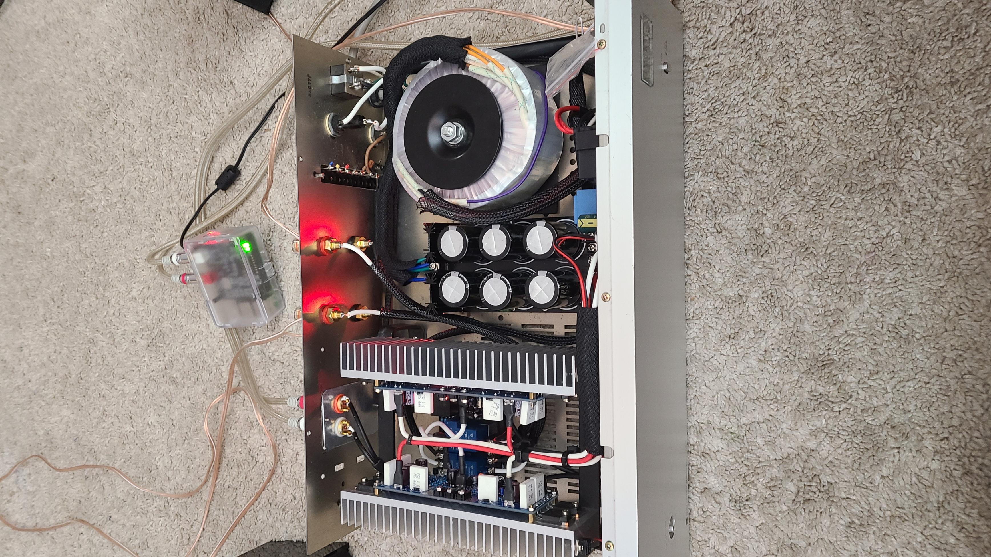

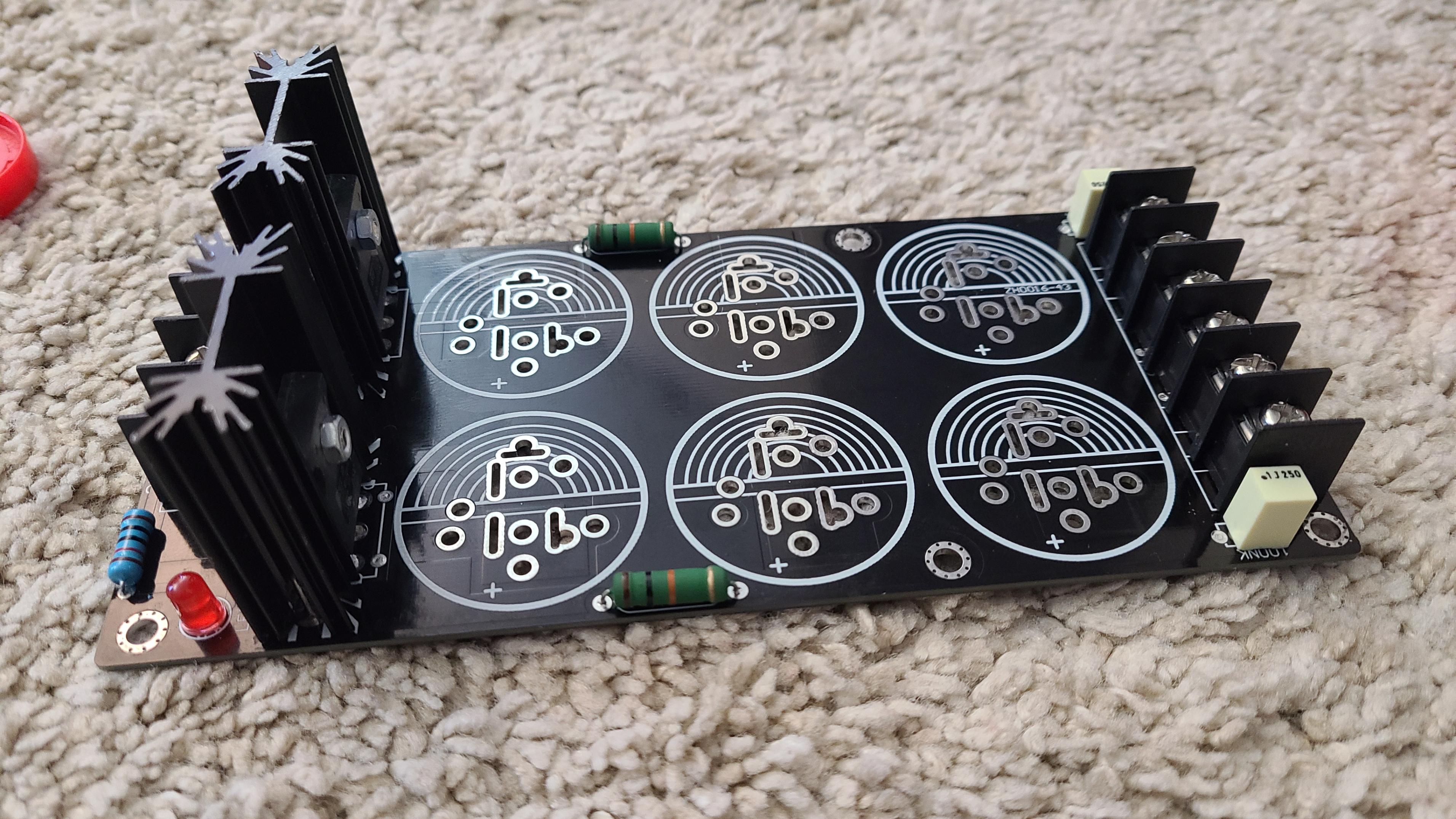

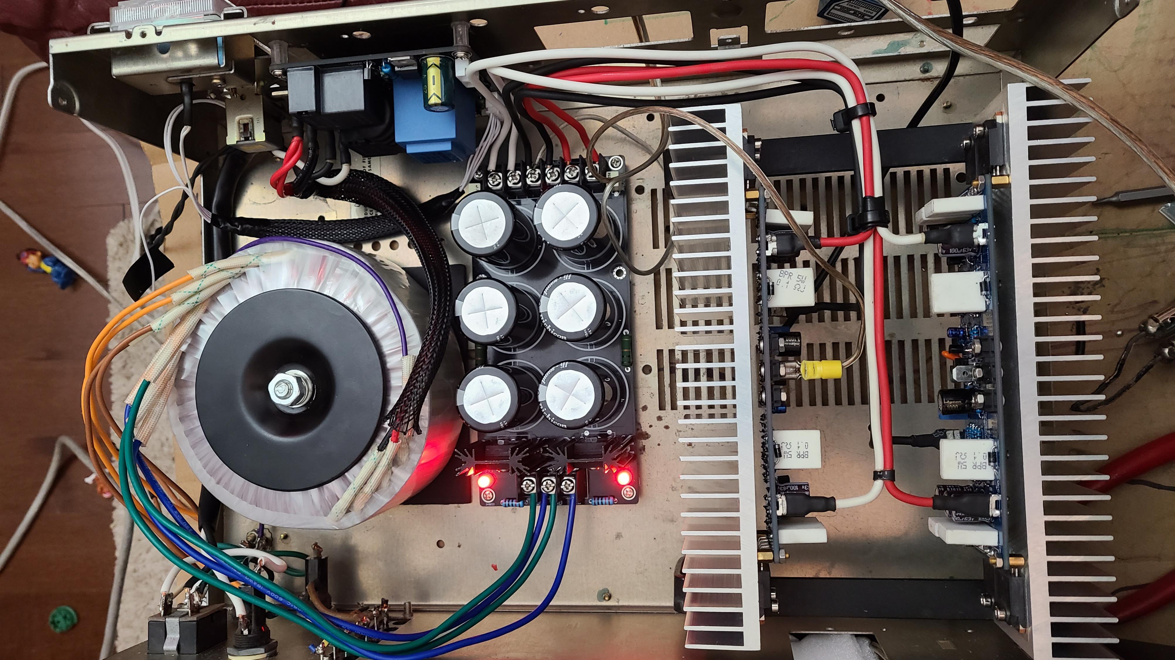

Finally got together everything and tried how it sounds. As my first diy amp it sound not bad. Will need to do more testing, but so far I like it. Running on 400 va 34 ac to 46vdc. 6x 8200uf Nichicon LKS. Soft start board, speaker protection board ( without it can play for half minute on capacitors only). It is not fully assembled yet. Trying to organize cables.

What capacitor board, soft start and speaker protection are you using?

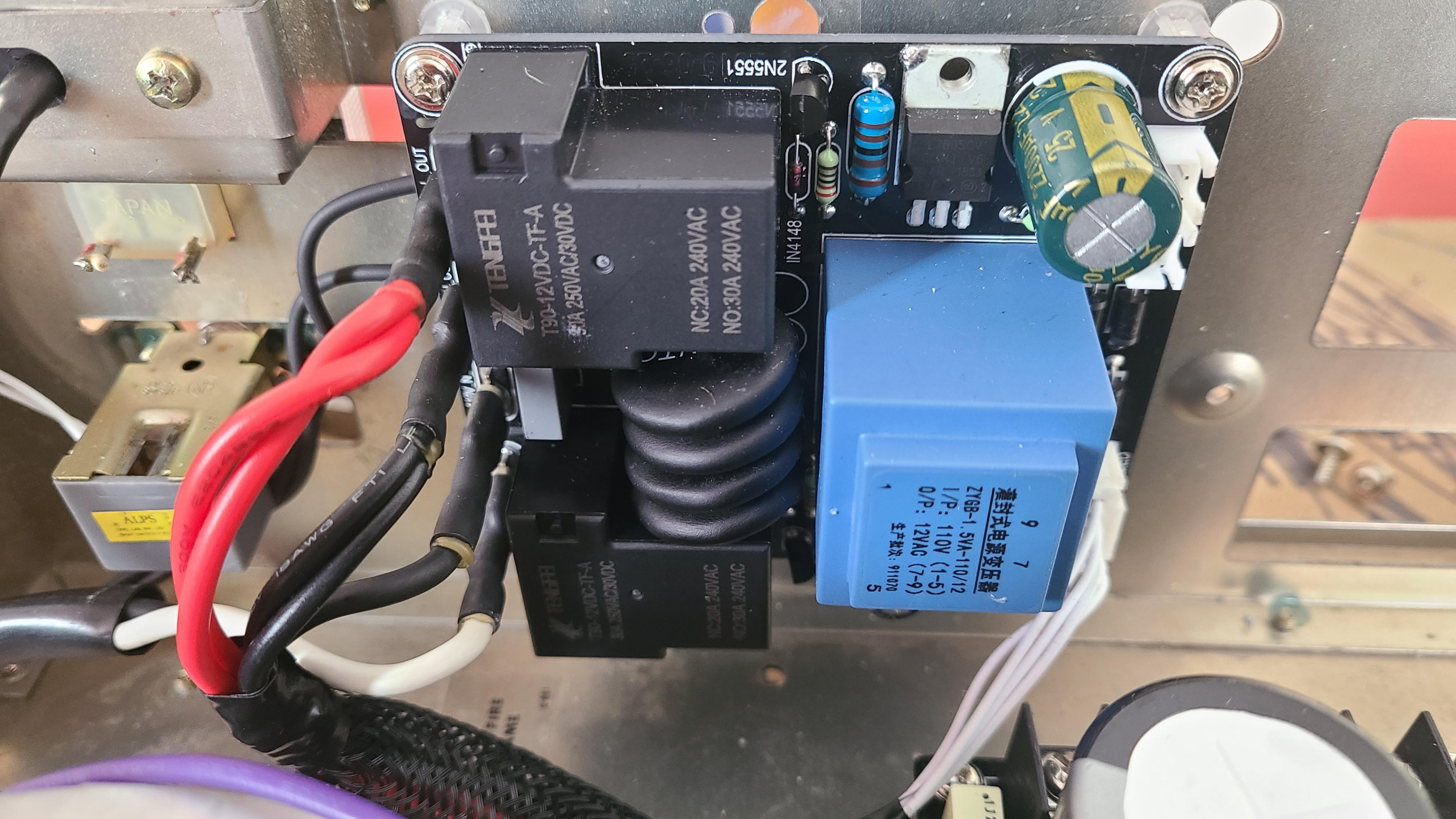

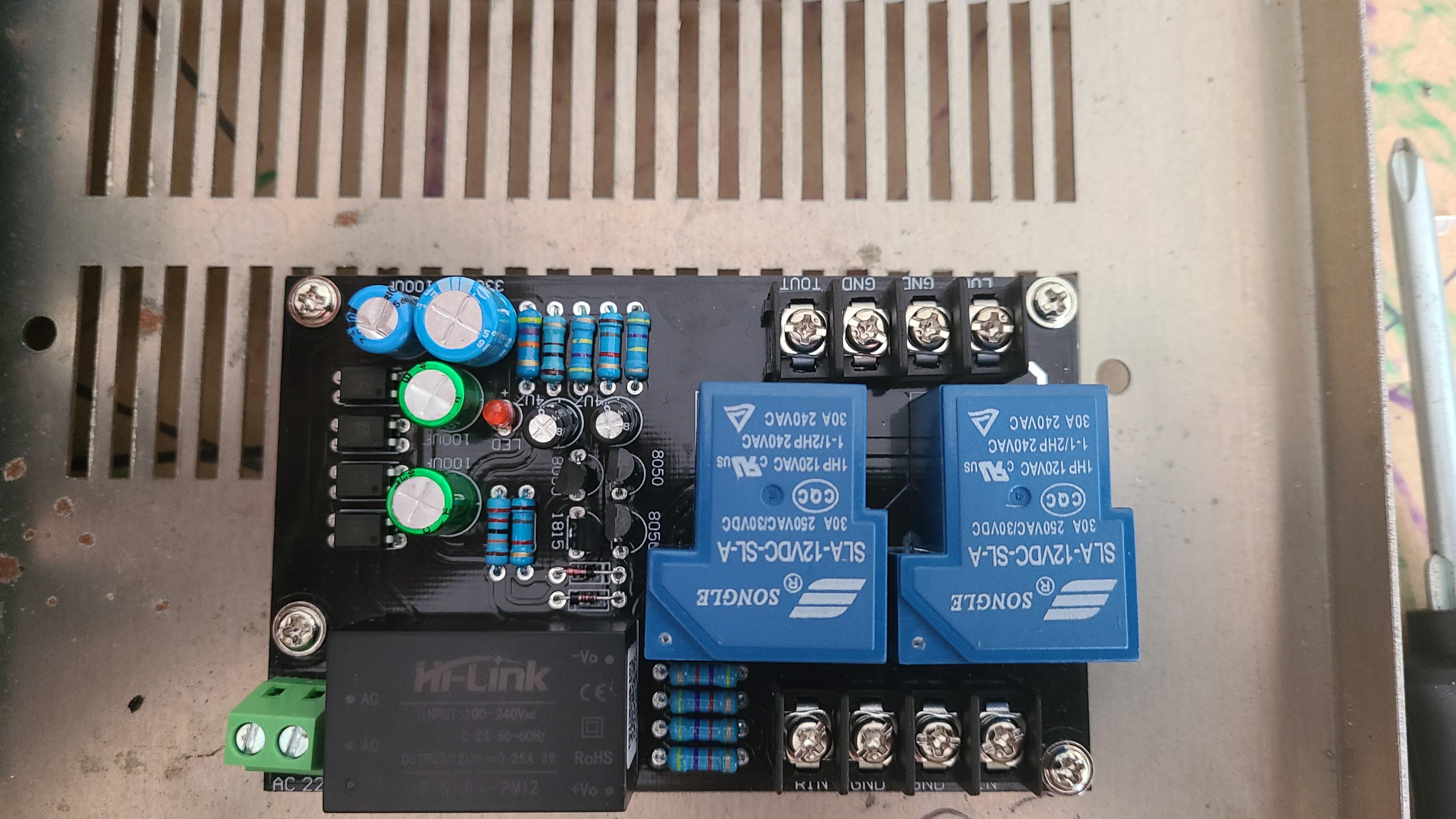

All bought on aliexpress. Rectifier comes with schottky diodes but without capacitors. Soft start and protection boards comes with its own power supply on board(110v). For soft start you can use low amperage push button switch( works with self locking and self reset switch). Also has thermal protection circuit with sensors included. Works Good.
Speaker protection board also has delayed turning on and disconnect speakers when no supply ( before it was running for half minute on capacitors). It works and no issues for now.
here is the hp protection that I have installed.
30A High power amplifier speaker protection board AC110V-220V | eBay
Looks good.
Very nice job yuradams!!!
I have not yet added and change the capacitors.
For now the sound is excellent.
Thanks. It plays very good.
