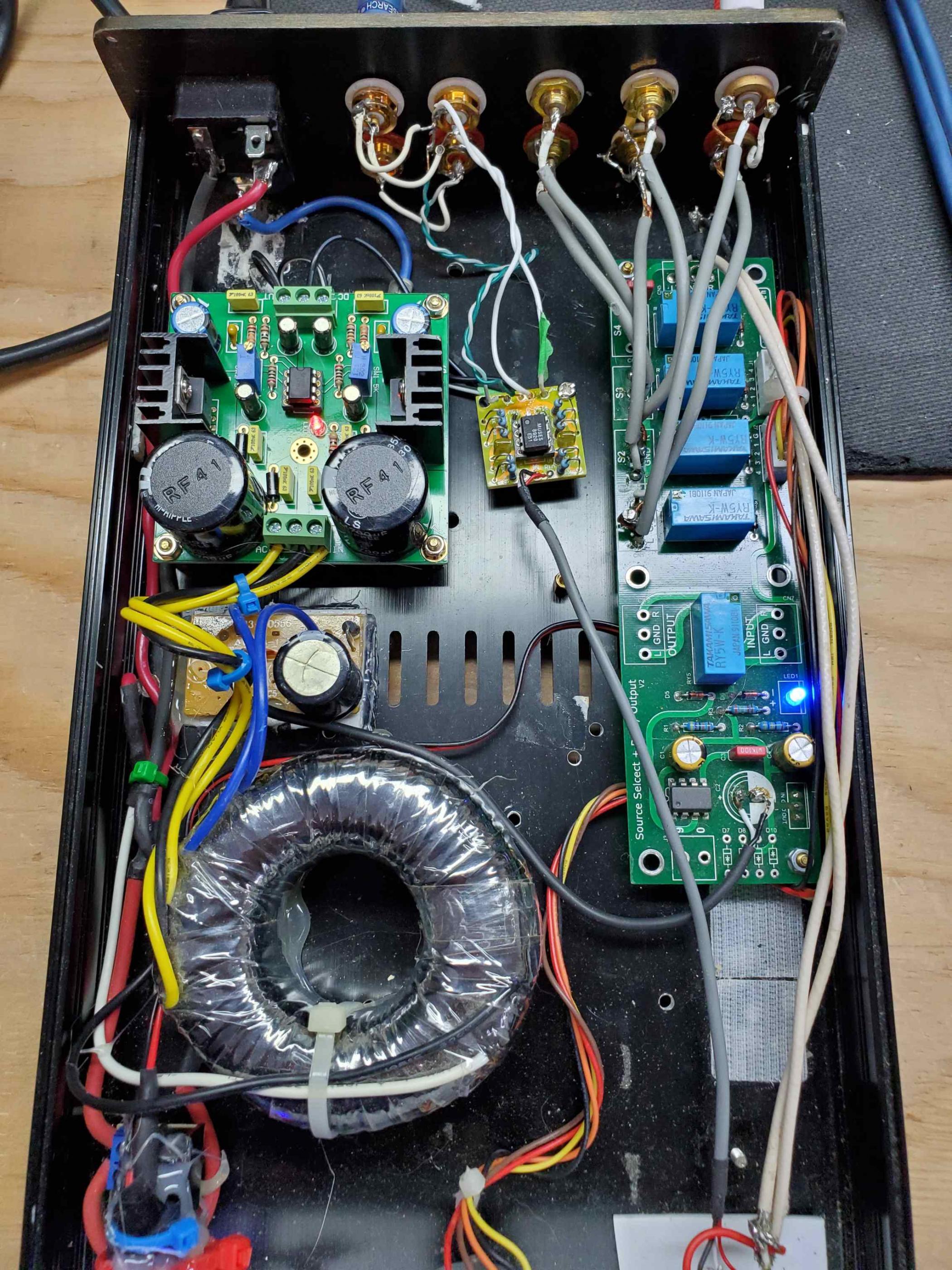

Hi everyone,
I'm still waiting for my parts for additions.
So far I have advanced in my preamp comparisons with the L12.2. Unlike other amps I own, the L12.2 plugged directly into the DAC output doesn't sound quite right.
This amplifier is very analytical and moreover it needs a good preamp to calm it down a bit and add a bit of warm tone. I started with the DCB1 Hotroad active buffer preamp from Salas. The sound is more balanced with a soundstage which is growing especially in depth. The bass as always with the DBC1 is powerful and dynamic.
But the L12.2 is not at its maximum, for having compared the DCB1 with my other Diamond buffer preamp, which has more definition and opening in the top, but oddly it sounds worse than with my other amplifiers .

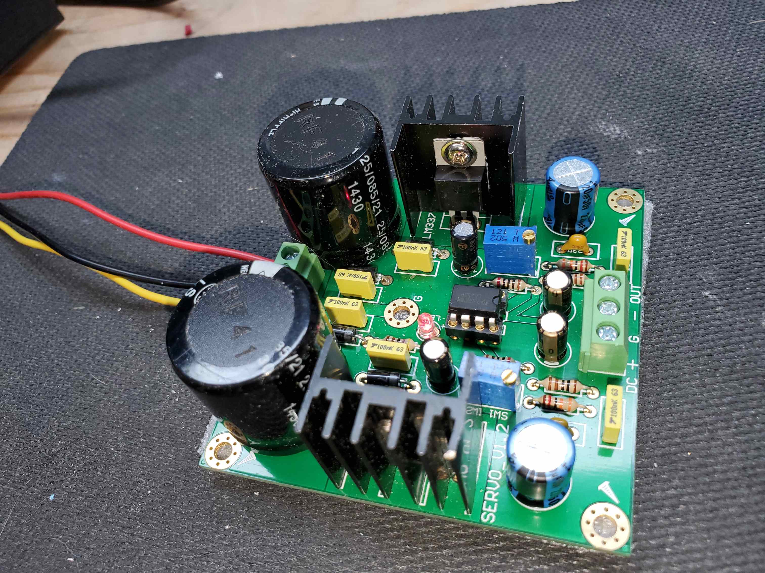

I decided to replace the Diamond Buffer with an OP. So I installed a support for OP, so I took the opportunity to change the PSU by another which has a regulator.
In addition I changed the capacitors, the fake Elna by Nover HI-Ripple of higher capacity at the AC input, and Nichicon at the DC output.
Currently I put an OP Muses 8920, then I will test an ADA4898. I have several OPs like OPA16, 32, but not the 1656.
With the Muses 8920, the sound is very balanced and really musical. I have some pictures of the preamp.
I will then compare with the OP ADA4898, which is excellent and come back to you with a little review, when the PCBs have the bypasses. My speakers are very detailed and dynamic, the slightest change in the system is easily heard. So far the L12.2 is for me the current best offer for a low price.

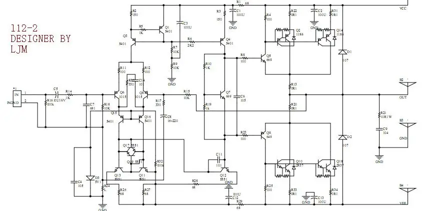

Idle current on my L12-2 bought from Aliexpress/Aiyima is about 1 Amp. That current is estimated from the power drawn from the wall; approx 55w for +/- 25v power supply. I bought two assembled boards and both are showing the same behavior. Input terminals are shorted for testing.
Aiyima title says that it is a Class A amplifier, and the description says that the quiescent current should be about 80mA.
Has anyone else experienced this issue?
Thanks!
LJM design rigorously tested high performance amplifier. Static current per channel is 40MA working at CLASS AB. Output Power 120W+120W (at 8ohm load).
Check pinout Q7 and R10 (Vbe).
Are there two different versions of L12-2 (Class-A and Class-B)? Can they be switched between Class-A and Class-B by changing bias resistor?

I don't think this plan is good. At the beginning of the thread they talk about it. For example C5 on my version is not 10uf 16v, but rather 33uf 25v.

@OldDIY: Vbe is about 613mV for Q7 and about 632mV between collector and base.
I was using the following schematic also for reference:
