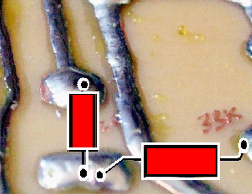

Here is the 100W amp. The schematic now almost matches the boards I have in stock. There are some small deviations. R15 has been split into R15 and R25. Simply stand both resistors on end in the holes for R15 and tie them together so they are in series. There is no provision on the boards for trim pots R32 and R33. There is also no provision for R30 and R31. The trace between the transistors will need to be cut and these components added. The easiest place to do this is on the bottom of the board. The trace to cut is on top of the board. I would recommend soldering the trim pot to the fixed resistor first then soldering the pair onto the board using the leads of the fixed resistor.

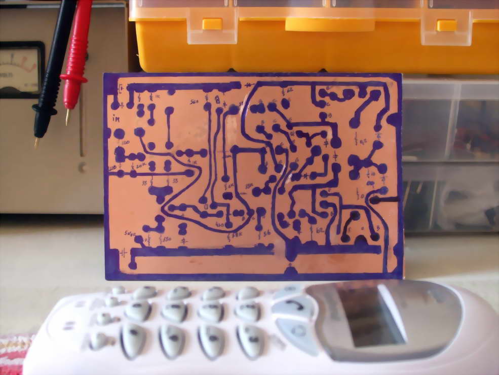

hehehehe..... Lol.... this is reality..no real long therm in my life
I am always searching for something new.
This amplifier is lasting for long...it is really nice.... also because i am waiting the real boards to assemble... after that..for sure i will be buiding other amplifiers.
The boards are reliable, and i use them to other amplifiers too...running wires... p2p and a big mess...i don't care about...my interest... what i want is to listen and to listen as soon as possible...life is short...i want to be happy... this drives me happy..so...let's do more!
This same Dunlap Krill amp board...made for the Krill, will be used into the future to other amplifiers...all them use differential, voltage stages and output...so... other needed things will be p2p... or aerial...or subboards.
I use to watch schematic and to paint boards using permanent ink pen from U.S. .... and then all wires are converted to copper...just that..then i corrode them using some dark ferric compound and just solder the copper lines...melting solder over them...it is nice and fast... i can glue the board into chassis...nothing need to be inverted or checked into the other board side...
The care we must have is to build from the left to the rigth... because we need room to the soldering iron tip and body to solder... all parts are pré soldered..some solder is melted into the leads..and them is to apply them watching schematic.... super simple.
Do not worry about the 33K resistance... this is 33K plus 33K (result 66K)...in series with a third one of 2K i have the 68K Dunlap has asked for his amplifier...i use resistances as jumpers too.
I use to make those boards since 1970...because more simple, easier and faster...and we do not need to think..just copy lines that interconnect parts and ready to go!
