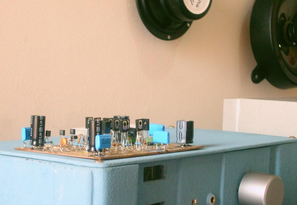

Krill - The little amp that might...
I am still building.... very slowly this time
regards,
Carlos
