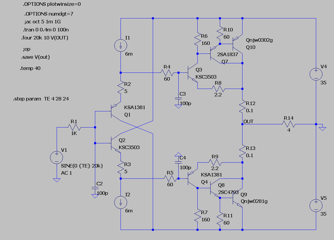

I work on a zero feedback buffer like the krill
I found THD 20k 0.004% 1W and 0.005% 100W

Your circuit has impressive results from your simulations.
However, the Krill has two key features - in my opinion - that your circuit is missing:
a) Steve's unique biasing
b) Restricted charge suck-out of minority charge carriers which I believe is responsible for the great treble this amplifier is reported to produce.
