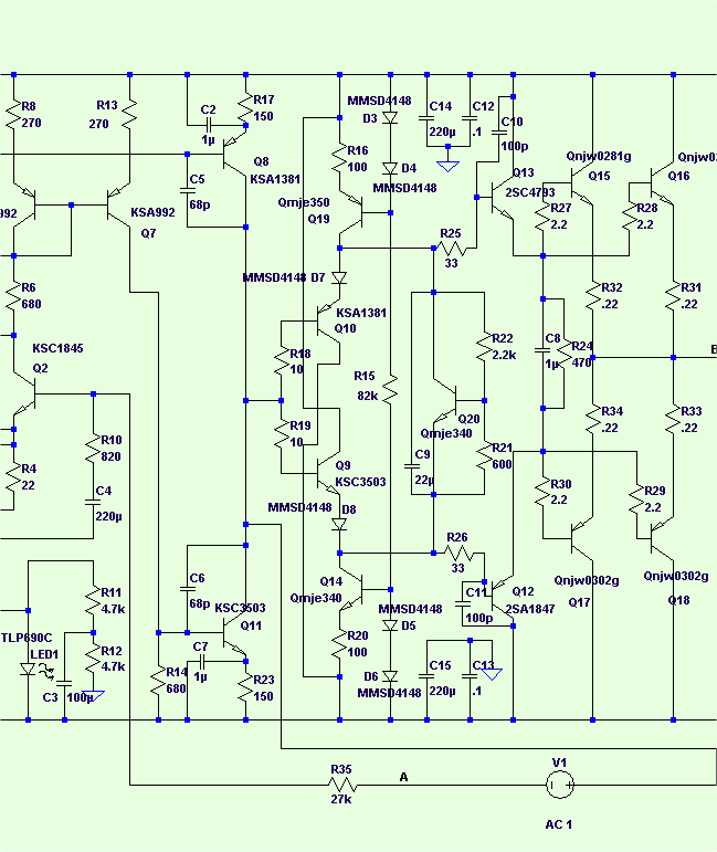

Q001 has wrong base-collector connection.
Q003+Q713 makes the right side diamond, Q711+(Q720//Q722//R734) makes left side diamond, R732(with help of C725 bootstrapp) makes the diamond CCS.
Steve, is it sufficient to use only R+bootstrapp (R732, R733=8k2 + C725=10uF) for powering an output diamond buffer, instead of using CCS like your version?

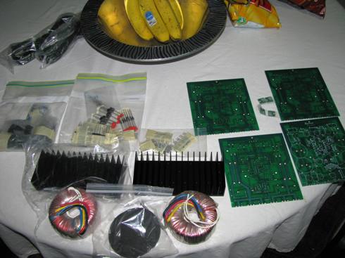

I drove over to Steve's today and let him bleed my wallet of a few $$$ for parts to build his Krill monoblock's.
Two amplifiers are for me and two are for ................. (the envelope - please) ........... Andypairo from Milano
No - the bowl of banana's was not included in the price. :whazzat:

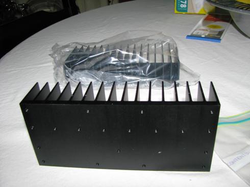

Please Steve, show us your skills in machining. Did you also make your own heat sinks?
PS. When you attach someones answer to your reply, make a mark in the little white square in the right corner (Quote).
I did not make the heat sinks shown in the photos earlier in the thread. These were made by Thermalloy from drawings I provided. It would be a lot of work to machine 250 heat sinks!
The intent was not to show my skills as a machinist, but rather to show how to build nice looking cases at affordable prices. Very few tools are needed. The amp shown here is one of my first cases built this way (actually the first 25 were built this way) and cost me $25 in Aluminum (each). The Al was pre cut to size when I bought it. With over 20 years of experience building my own, I now do a better job. This was before I studied machining and I didn't own a machine shop at the time.

Q7/10 are the diamond buffer, Q8/11 are just a diode biased
VBE ,Q9/12 are current sources used for the current stage to
improve psrr to counter the lack of global NFB, and 13-16
are very high gain darlington pairs (carlos doesn't like darlingtons
,by the way 😀 ).
I really like the topology and what it does for the Op stage,
By looking at the marantz , anything (VAS/input wise)
can be the source..😎 I am playing with the NFB factor
now, comparing how irt reacts with different VAS's and
NFB configs.

Sorry, I still don't see it. At least to me, this does not resemble my output stage. It is biased differently, thermal tracking is different and I really don't believe a resistor is an acceptable replacement for a current source. I believe that also answers your question about the CCS.
I don't believe Q001 is the only mistake in that schematic.

No, not exactly , but they are both diamond based. I agree,
that with real CCS's, performance is MUCH better. I used
a Standard Vbe (for ease of construction) and lowered the
darlingtons gain slightly (more of a high gain EF instead)
because of oscillations with fast devices at saturation.
Because the krill/diamond stage presents almost no load on the
vas , i could run at 2-3mA..😎 which might allow for
faster SMD or to-92 devices.

The Marantz was not the only amp to use what people these days are calling a diamond buffer and certainly not the first. If Q7/Q10 are what you are calling a diamond buffer then this is a really old configuration going back at least 35 years. That is when I first saw it. I have no idea how long before that.
There are good reasons for its use as an input stage. First, you can DC couple. Second, it gives .6V on the emitter of Q7 and -.6V on the emitter of Q10. This gives you bias for the next power stage so it has an idle current. Understand that I am describing the circuit as I first saw it but using the schematic designations from my schematic to make this easier to follow. In the original that would on been Q13/Q15. Their emitters would have been tied to the load through emitter resistors. Drive for the Q13/Q15 was supplied by the current sources of Q9/Q12. Q7/Q10 sink all current that does not flow in the bases of Q13/Q15. The emitters of Q7/Q10 follow the base connection allowing the current sources to track the emitters up and down swings and Q13/Q15 are emitter followers. This makes a simple 6 transistor buffer that is reasonably well behaved. This was my starting point.
The drawback to this is the amount of heat generated by the current sources for higher output power such as an amplifier. All the base current for outputs is from the current sources. With the power transistors available 35 years ago the gain was usually low so the current sources needed to supply .5A to 1A to achieve reasonable output power. With 50V or higher rails this made for some serious heat - 200 to 300W at idle.
Another drawback was the fact that the only way to adjust output bias was by changing the value of the emitter resistors.
I addressed the first problem by using a Darlington output. This greatly reduced the heat in the current sources as now they could be run at 50mA or less. This then required me to provide a second .6V drop for each output. I didn't like using a diode or resistor because I did not feel they were the optimum solution. The solution was to repeat the input pair to give the additional .6V drop. I then added the diodes and trim resistor so the output bias could be adjusted over a wide range. Placing the diodes on the heat sink gave thermal compensation. This solution also had the benefit of having the only source of base current for either Q8/Q11being the base of the other. When one output Darlington (say Q13/Q14) draws base current from its current source (Q9) then less current flows in Q7. This reduces the current flowing in the bases of both Q7 and Q10. This makes less base current available to Q10 causing Q10 to try to turn off. This increases the resistance of Q10 which increases the base voltage of the other output Darlington causing it to stay in conduction during more or even all of the output voltage swing.
Proper output bias is set using a distortion meter and observing the sharp null in distortion as you reach the optimum.
Does this help understand the circuit?
