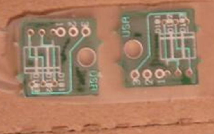

Hi Steve, Thanks for share your very interesting design.
I will make a try very sooner.
But, as you asked for errors on schematic, I did find a missing connection between the node of two zeners to ground, in Power supply schematic. (both 50 and 100W versions)
Marcos
Hi Steve,
Just another correction - the boards you sent out have C3 & C4 which isn't on the schematic sent with the boards - I believe these Cs are correctly shown on your recently posted 100W schematic.
Also, early in the thread you mentioned you would be post high power schematic (which you've done, thanks) & circuit improvements. Are there any other suggested circuit improvements besides the DC offset R30&R31 bypassed with pots ?(on the latest 100W schematic)
OStripper is correct - in the stuffing guide there is a daughter card with a Q, R, D C component - this is beside the 3 diodes you refer to MJL. The actual boards only come with a small daughter board for the 3 diodes which act as thermal bias correction. So maybe the other components were also related to this function? Steve will clarify, I'm sure
