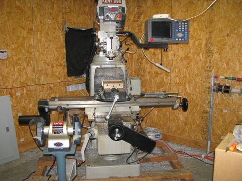

As long as I don't need to come over and use your mill to machine something out of solid stock - I'm game!
