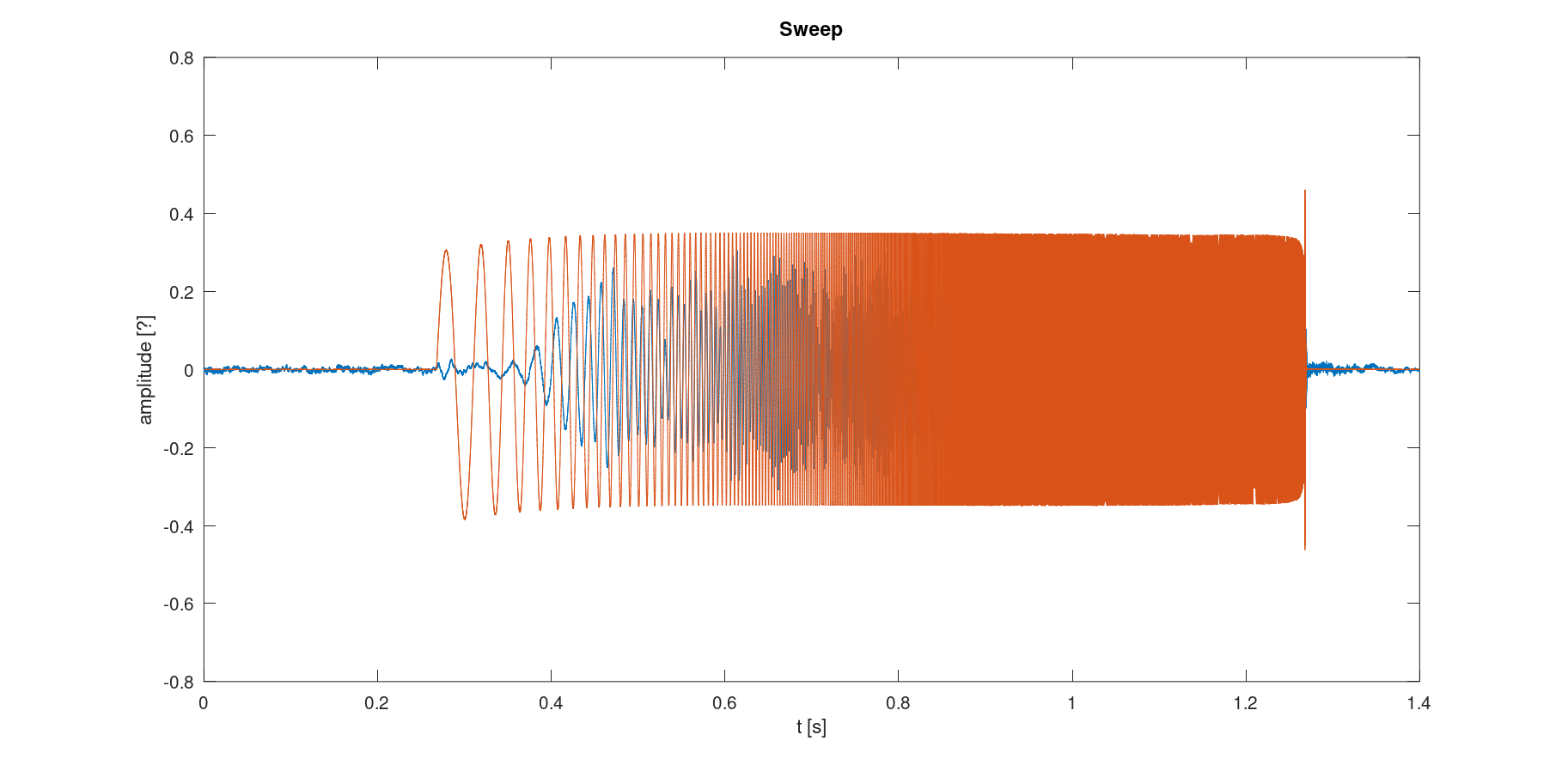

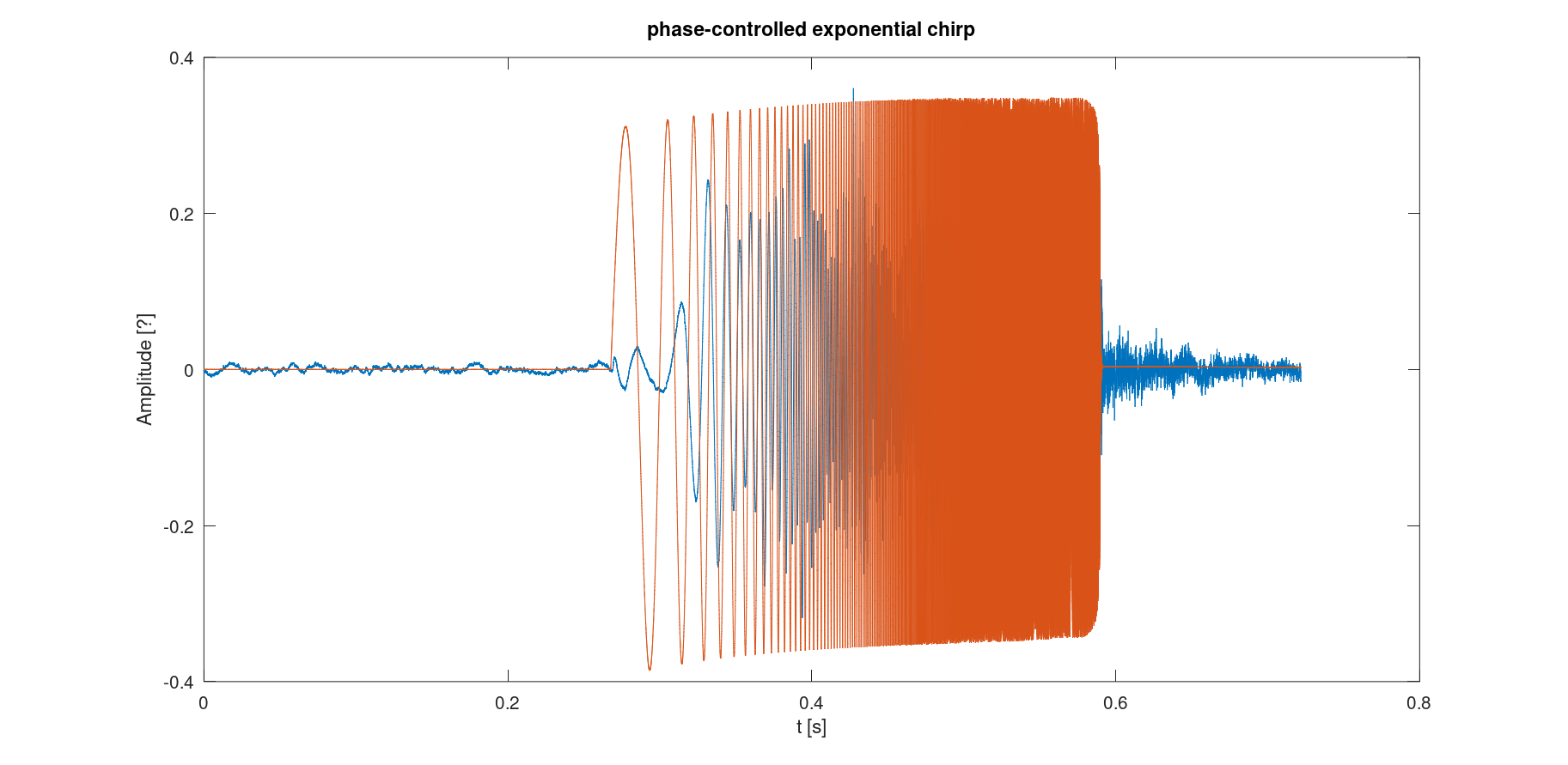

Please try using the mataa_measure_signal_response(...) function for audio I/O instead of the mataa_measure_IR(...) so you can take a look at the data you get from the microphone and from the loopback channel. Check for things like clipping or cutoff at the beginning or end of the signals, or other undesired effects.
Here it is:
There is some kind of mean drift and a (little) spike at the end.
I also implemented a 'phase controlled exponential chirp' from https://www.uni-weimar.de/kunst-und...ation_of_ESS_impulse_response_measurement.pdf
The peak at the end is gone, but the mean drift is still present and also the preringing (not shown).
So, putting the samplerate at 192kHz iso 44.1kHz solved the problem. I don't know why, but will simply use 192kHz.

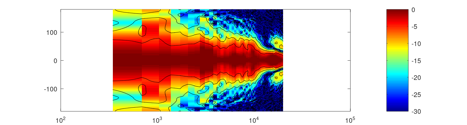

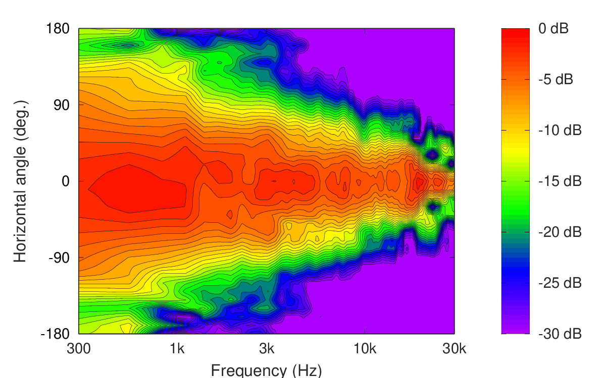

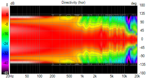

I measured my Elac Debut 2.0 from 0 to 180 degrees in 1 degree steps (still with my crappy test setup). I seriously doubt whether the 2D modal fitting and reevaluation is worth it once you have the measurement process automated. Get yourselves a cup of coffee and its done.

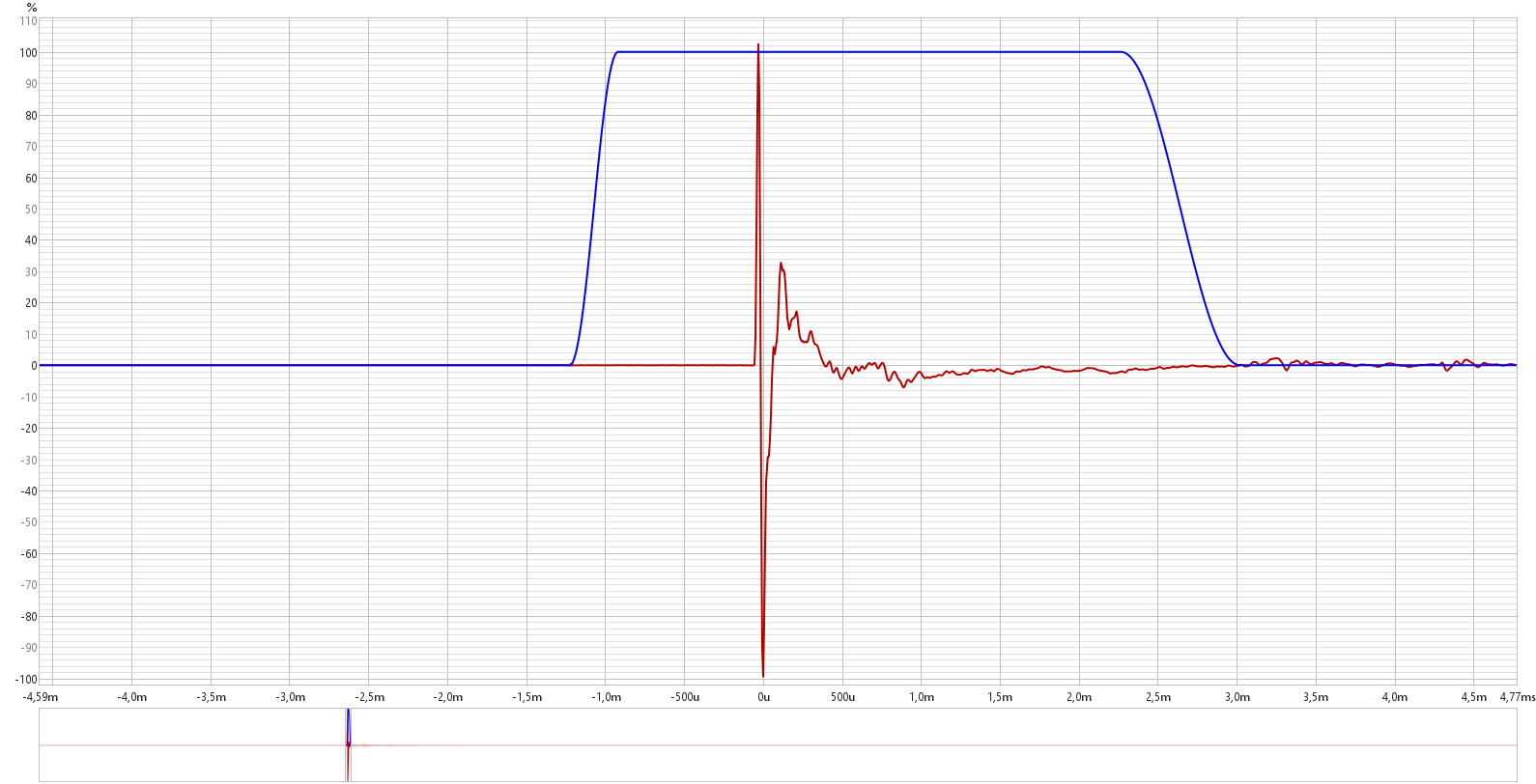

I measured with Octave, saved the impulse response to a wav file, read that into REW (see image above), applied a window too all* measurements and exported FRD data for use in VituixCad:
* I only could load ~120 measurements into REW before I ran out of memory.

Both the drift and the spike at the end looks wrong. Do you have a filter somewhere? Also, the loudspeaker signal looks like it has not fully died off to zero when the recording stopped.Here it is:
Ok, that smells like some anti-aliasing somehow.So, putting the samplerate at 192kHz iso 44.1kHz solved the problem. I don't know why, but will simply use 192kHz.
That's all pretty nice!I measured my Elac Debut 2.0 from 0 to 180 degrees in 1 degree steps (still with my crappy test setup). I seriously doubt whether the 2D modal fitting and reevaluation is worth it once you have the measurement process automated. Get yourselves a cup of coffee and its done.
But I wonder:
- Why do you export the data to REW to apply a time window and then export to VituixCad for plotting? You can do all of this right in Octave, fully automated. I attached an example I did in Octave a while back with the OSMC. Once you're done with the coffee, the plot shows up on your screen with not extra work.
- Did you export the full impulse response data? 180 x 1.3 seconds at 192 kHz is quite a bit of data! Cropping the data before to the relevant 3 ms before exporting would reduce the size of the dataset by about 500x.
I didn't deliberately put a filter somewhere. My room is far from anechoic...

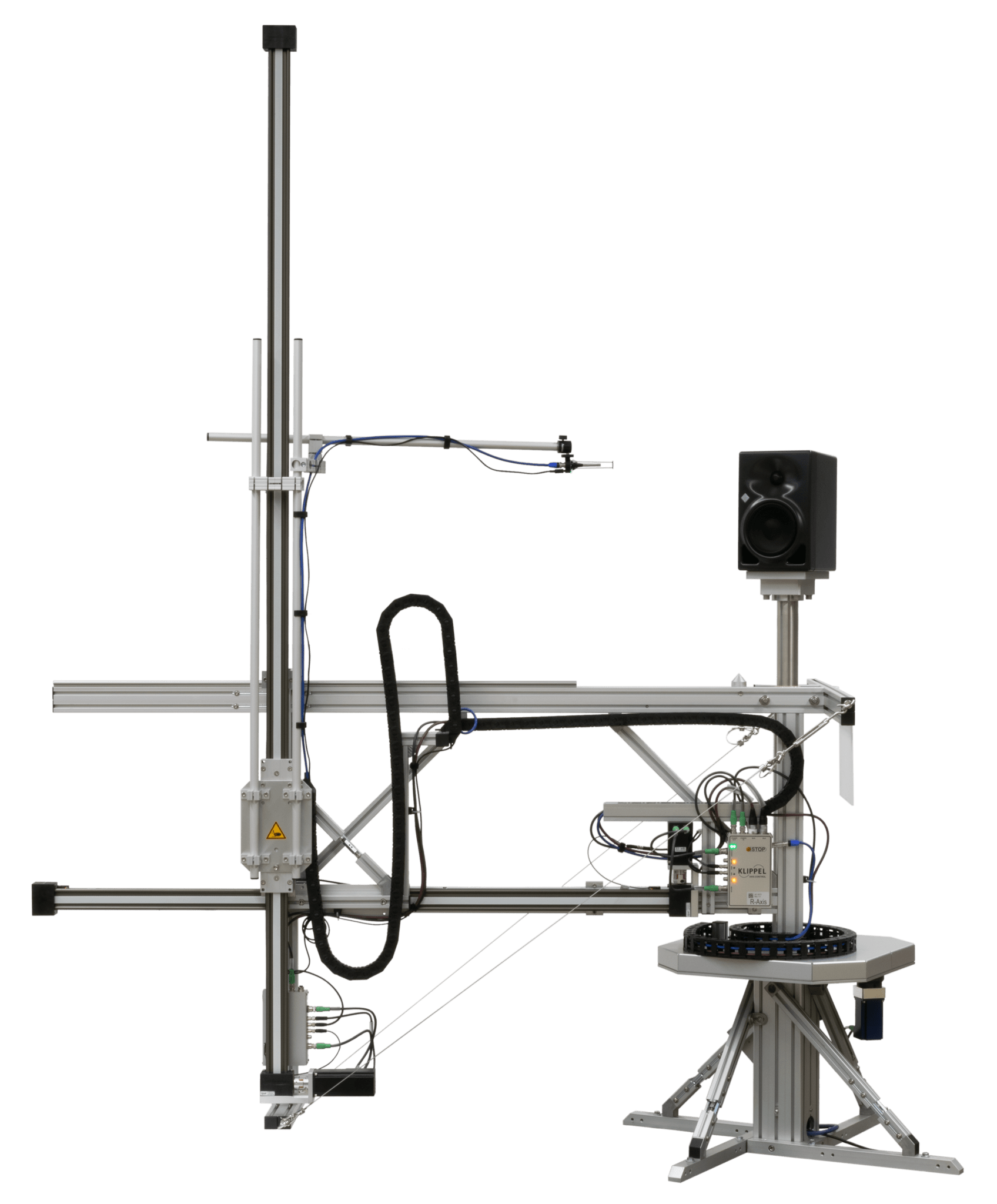

As I understand it, we want the microphone moving in 3D to do what the Klippel system does. So we need to move the microphone in 3D.

Here's the best picture that I have been able to find.
https://www.klippel.de/fileadmin/user_upload/NFS_1.0.7_StudioMonitor.png

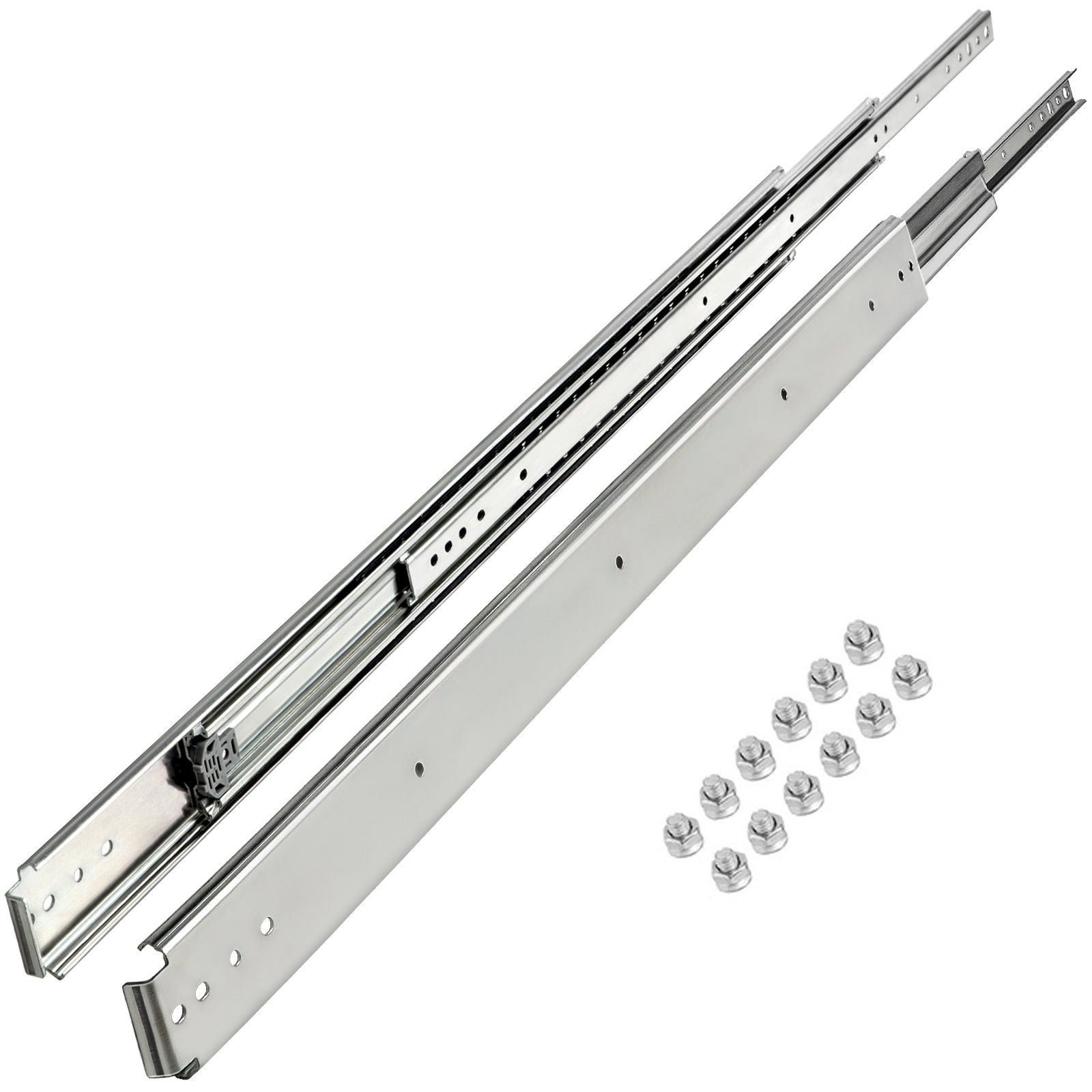

https://www.vevor.ca/drawer-slide-c...l-bearing-full-extension-500lb-p_010873950531
60 inch drawer slides. Reasonably priced. You can us these for vertical and horizontal movements. 2 pair would be enough for horizontal and vertical movement of the microphones. And provide a fair degree of built in rigidity.
A little perspective on the size of these. They are more than adequate for the task at hand.
I'll try and put together a list of parts and places to order as I cobble together something for myself.

Klippel manual gives physical dimensions to the system for our reference.
https://www.klippel.de/fileadmin/kl...D_System/PDF/C8 Near Field Scanner System.pdf
Page 8
Page 8
