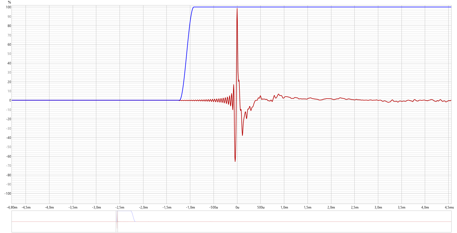

Now I have pre-ringing:
A measurement done in REW doesn't show this.
@mbrennwa : any idea what I'm doing wrong?

Not sure. Can share a minimal code example?@mbrennwa : any idea what I'm doing wrong?
Not at the moment. Full code is in GitHub: https://github.com/TomKamphuys/Audio/blob/main/angular_measurement.m
I tried fade in, fade out. REW seems to use that. I tried continuing to the Nyquist frequency and putting zeros from the last zero crossing onwards. All to no avail.
What happens if you use an MLS or pink noise instead of the sweep?
What happens if you don't use loopback?
What happens if you don't use a calfile on line 41?

I usually see pre-ringing explained as resulting from the type of filtering applied. Here's a synopsis from Sound on Sound:
Pre-ringing
Pre-ringing refers to an inherent character of the impulse response of linear-phase filters employed in D-A or A-D converters. In a conventional analogue or minimum phase filter, an input impulse signal will generate an output impulse response with a strong initial spike followed by a string of ripples of decrasing magnitude. In a linear-phase filter the impulse spike is preceded by a build-up of ripples in advance of the impulse arriving, and a symmetrical string of decaying ripples afterwards.
Might there be different filtering buried somewhere in the two processes?
MLS : pre ringing present
no loopback : different, but still looks like ringing
no calfile : pre ringing present
Tom one thing you can do to look at it in REW is to change the window settings to only look at the response before the peak. By looking at the frequency response or filtering the IR you can see the spectrum of the preringing. If it is an antialias filter or similar linear phase induced bandwith limit it should show around the Nyquist frequency.
I have seen a similar thing in REW when the timing is slightly off from where it thinks it should be. You can manually change the T=0 time and see if it changes anything.
Please try using the mataa_measure_signal_response(...) function for audio I/O instead of the mataa_measure_IR(...) so you can take a look at the data you get from the microphone and from the loopback channel. Check for things like clipping or cutoff at the beginning or end of the signals, or other undesired effects.no loopback : different, but still looks like ringing
