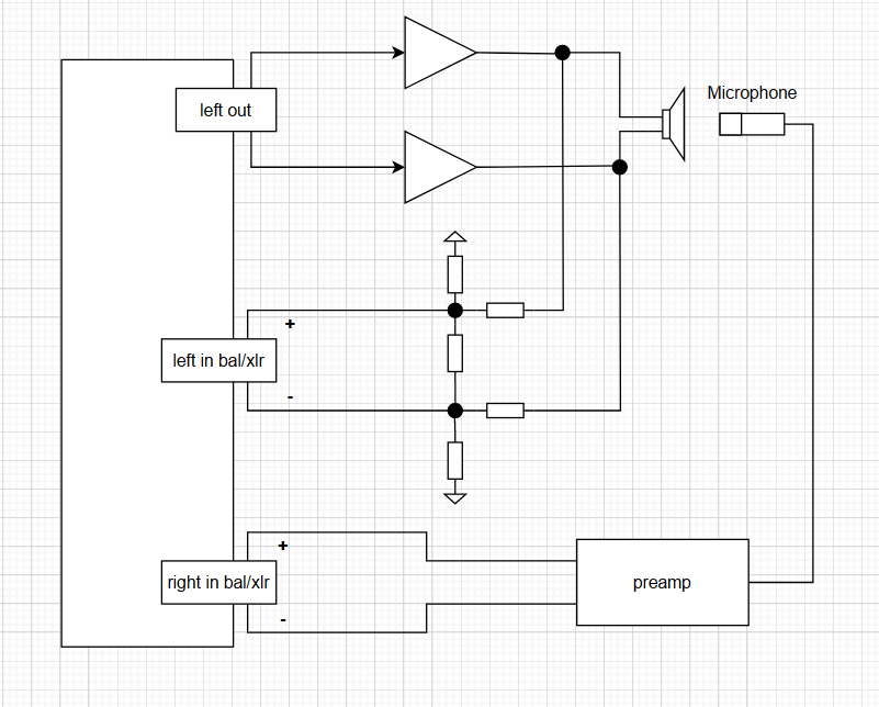

No it's not, since USB audio interfaces have a balanced input (xlr).If the amplifier is bridged there is no ground at the output terminals and it is problematic
Something that has never been updated in the ARTA manual.
Also things like impedance measurements work perfectly fine with bridged amplifiers.
ARTA's manual still assumes that people use an old fashioned single ended soundcard input.
Btw, measuring with balanced inputs is always preferred, even with a grounded amplifier.
Since a bridged amplifier is nothing more than a balanced power driver, it's probably even preferred.
Having a fully balanced system can be beneficial against noise.
So here the proper global schematic for a balanced (bridged) output and balanced inputARTA describes two types of dual channel measurements

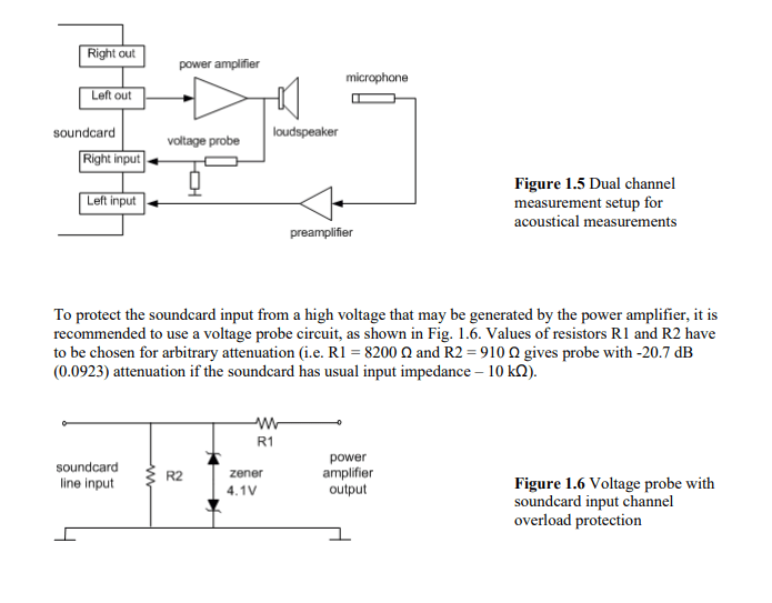

What they call dual channel takes the output from the amplifier with a voltage probe.
If the amplifier is bridged there is no ground at the output terminals and it is problematic.

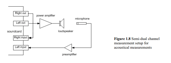

What many people call dual channel, ARTA classifies as semi dual channel, where the loopback is just the line level output from the soundcard.
This causes no problems.
The resistor divider is not really necessary, since most good quality audio interfaces can handle something like 7-10Vrms input + have a input gain knob (= attenuator)
Since they also can handle the 48V phantom power for microphones, this also automatically means they are protected for at least 50Vdc (poor quality) but more often 63Vdc.
The mic preamp is obviously build inside the mic itself and being fed by the phantom power and has a balanced output.
