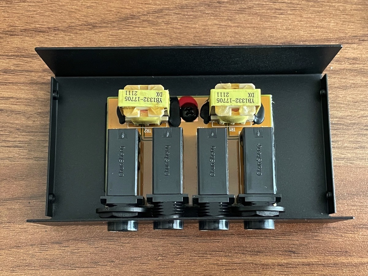

I use my Aiyima A07 amplifier that I have lying around. However when I connect the loopback the amp goes into some kind of safe mode and I have to remove the power to get it to work again. I just measured some voltages in order to find out what is going on. I found out that there is 16V between the input and output of the amplifier. Normally that isn't a problem, but when I complete the circle DAC -> amplifier -> (speaker&) ADC this gets troublesome. DAC/ADC is a Behringer U-Phoria UMC204HD
Is this normal? How to get around it? Capacitor somewhere? 'lift'ground?
Or this, the Behringer HD400, which seems to have some transformers inside:
You generally don't want a transformer in the signal path if you want a wide bandwidth measurement. I know that there are exceptions to this. But as a normal way of setting up a measurement I would stay away from a transformer that you do not know the characteristics of.Or this, the Behringer HD400, which seems to have some transformers inside:

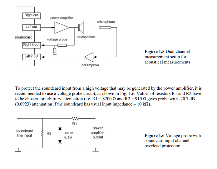

ARTA describes two types of dual channel measurements
What they call dual channel takes the output from the amplifier with a voltage probe.
If the amplifier is bridged there is no ground at the output terminals and it is problematic.

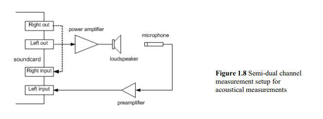

What many people call dual channel, ARTA classifies as semi dual channel, where the loopback is just the line level output from the soundcard.
This causes no problems.
You could use a DC blocking cap to avoid the DC in the loopback. However, you may not need to include the power amp in the loop back because it does not affect thd latency of the audio processing. To get the timing right, just connect the loopback at the computer audio interface.I found out that there is 16V between the input and output of the amplifier
I just like the concept measuring at the speaker terminals, but semi dual channel works.Just run semi dual channel by looping back from one interface output channel to an input channel and set that as the reference.
