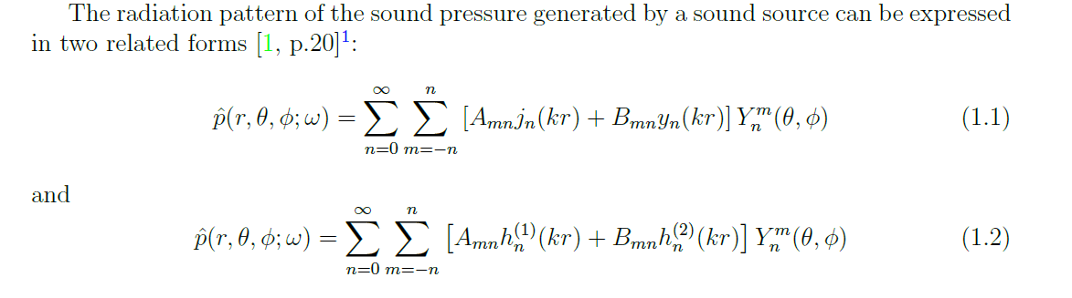

NTK's code uses these functions:
The 'r' is present in these functions and are thus used when 'fitting' the coefficients. Why do we need different functions?

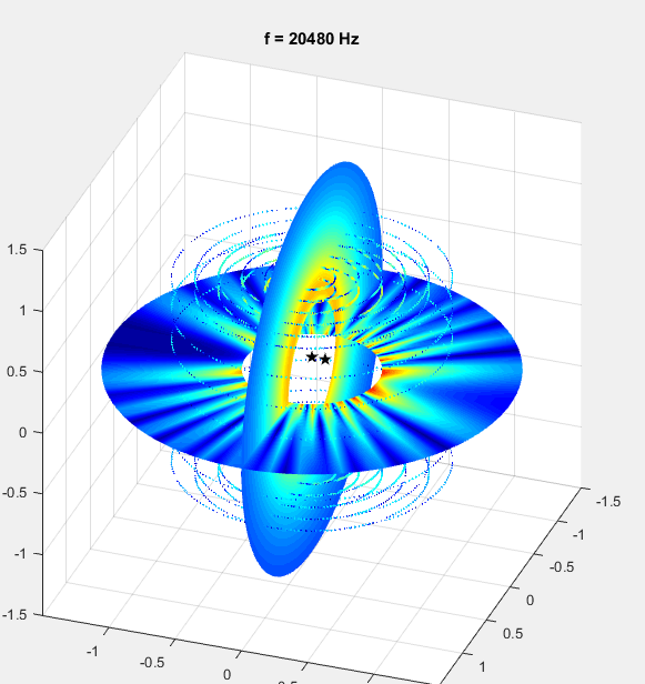

Here is a figure made with his code where the 'measurements' were taken resulting in a cylindrical data set (with cap). The sound pressure is then re-evaluated at the two planes.

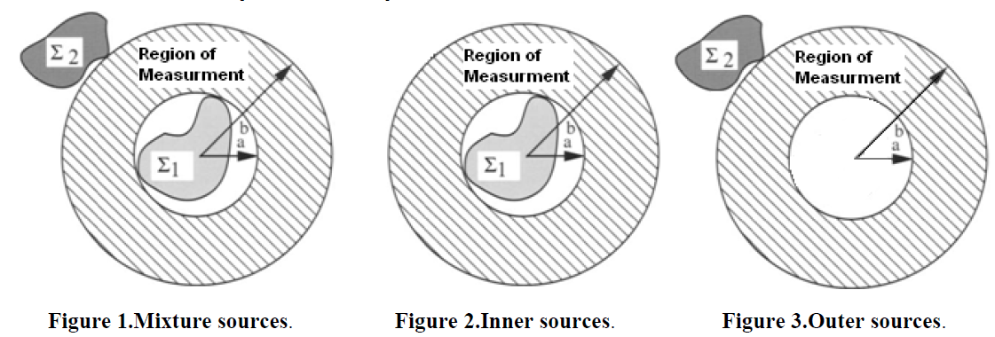

It's so obvious to me now, in hindsight: We know from Green's theorem that if I know the field variable and it's gradient on any closed surface then I know its solution everywhere. This is the basis of BEM as well as many other concepts such as the Green's function. We get the pressure on the surface and then the gradient from a second surface and we have the complete solution. Any closed surface will do with the origin anywhere inside this surface.

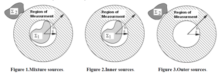

Yes, any (set of 2) closed surface in free space with only sources inside and outside of the (set of) surfaces:
But not limited to circles as in the image above.
I started typing a hole story that that might mean that everywhere one could place a mic would be free space as sound sources and reflectors need to be physical things and thus prevent a microphone from being placed there. But I guess you don't want to be in a space 'affected by diffraction', like around a corner. But I think that is only a theoretical limitation; just don't place a mic there.
