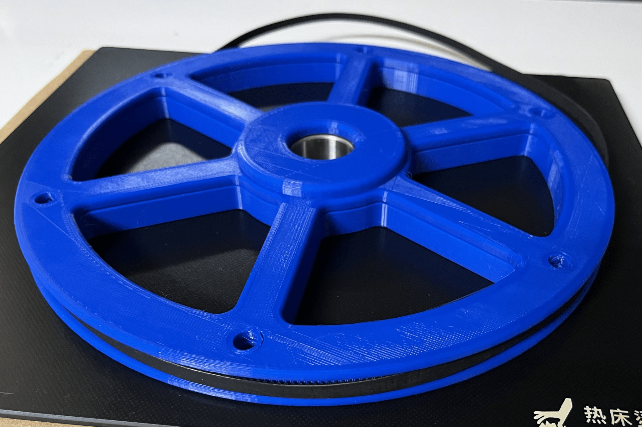

I built my original GT2 gear to spin around a central pole by putting a 1" bearing in it, using one of those fancy hot glue gun machines 🙂

The 1" bearing was what I used because I had some 1" pipe and the bearing was available at the local hardware store. This was still designed for spinning the speaker.

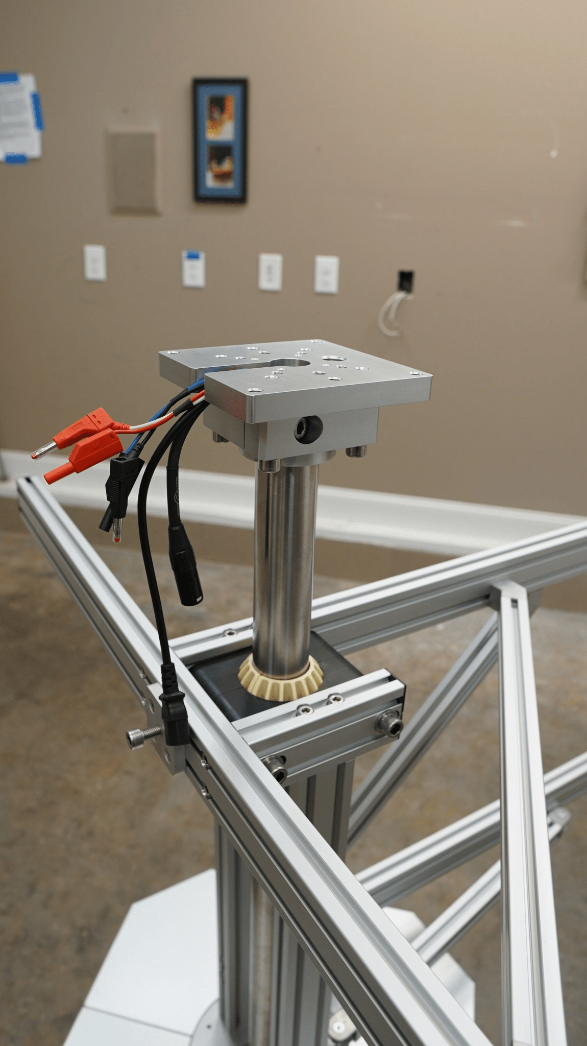

Klippel looks like they have some sort of plastic bushing

Yes that is a bushing. Probably from IGUS. Your flanged bearing idea is a good one. If you go that route you need upper and lower bearings. Otherwise you will have a very wobbly setup for the moving mic. There are a number of ways to make this work. PVC pipe, American schedule 80 is thick enough to support considerable weight when it is in a 50 or 75mm diameter. There are readily available flanges for toilet mounting that are robust enough to fasten the bottom of the pipe and allow a large enough platform for the DUT. This could serve easily as the central post to mount the loudspeaker and allow easy access for the cables. 75mm pipe is not that expensive. And lastly the pipe and the fittings are not expensive. With PVC you have pipe easily cut with common wood working equipment. And another trick is possible. Run steam through the pipe and you will soften it enough to bend it. Another way is to use a hot air gun. This will allow an easily made curved mic arm. Our mic arm can be attached to our Slewing bearing. I think that the key for us keeping this open source is ease of manufacture. I'll get this together soon and make some mock ups. Our base needs to be wide enough to provide a stable foundation to the test structure with a high centre of gravity. So the use of concrete pavers as a ballast may be an idea. Or simply a half sheet of material of choice.

Indeed. I like what Klippel have done by using the Extrusions to form a box around the central rod. The turn table and mic arm then connect to that box.Your flanged bearing idea is a good one. If you go that route you need upper and lower bearings. Otherwise you will have a very wobbly setup for the moving mic.

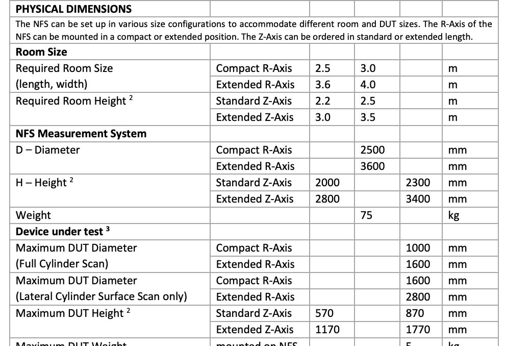

I am following this thread with interest, a question: would this scanner work in a room of size 4.5x3x2.4m ?
You would be limited on the size of speaker you could measure based on the furthest distance the arm can rotate.I am following this thread with interest, a question: would this scanner work in a room of size 4.5x3x2.4m ?
You can get a better idea from looking at Klippel's datasheet. The compact R axis would fit in that room and they give maximum dimensions for the speaker it can measure
