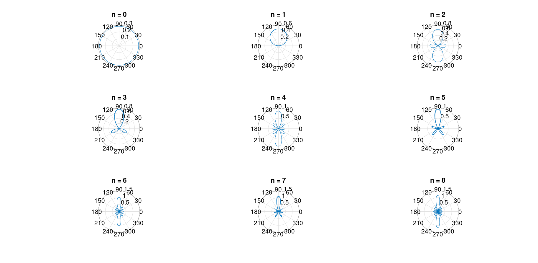

These are the function I get for the 2D fit:
Unfortunately the legendre function in octave doesn't seem to result in these images. I use the spherical harmonics with m=0 and show the intersection of them with a plane.
n=1, 3, 5 and 7 seem to have two lines. You need to look closely 🙂 Is that expected?

Which plane did you use for the intersection? A vertical one containing the z axis?
You might try using different colors for the positive and negative portions of the graphs. Many of the legendre polynomials have negative values over some range and putting those on a polar plot is tricky. Octave may ignore the sign and overlay the negative values on the positive ones. You might try a conventional plot of each legendre function vs. a straight theta axis to see if the functions look right.

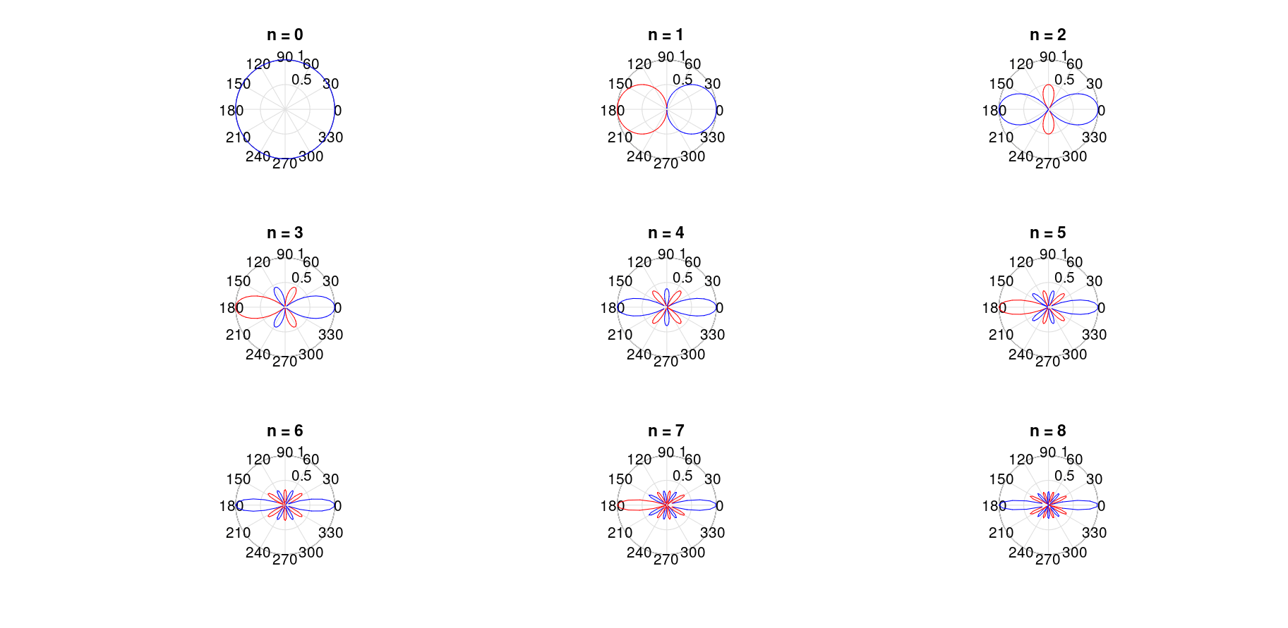

The Legendre polynomials are all symmetric for even index and antisymmetric for odd. For n = 1 the pattern is Cos(theta) which the plots do not show, so something is wrong.

Our assumptions or interpretation was wrong. Negative values of the 'legendre polynome' for an angle were plotted at the same position as positive values and an angle 180 degrees away.The Legendre polynomials are all symmetric for even index and antisymmetric for odd. For n = 1 the pattern is Cos(theta) which the plots do not show, so something is wrong.

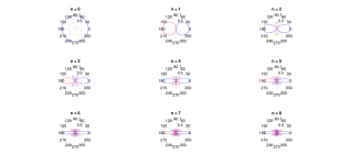

In the mean time I implemented the legendre polynomials myself and plotted the absolute value and color-coded the sign of the values.

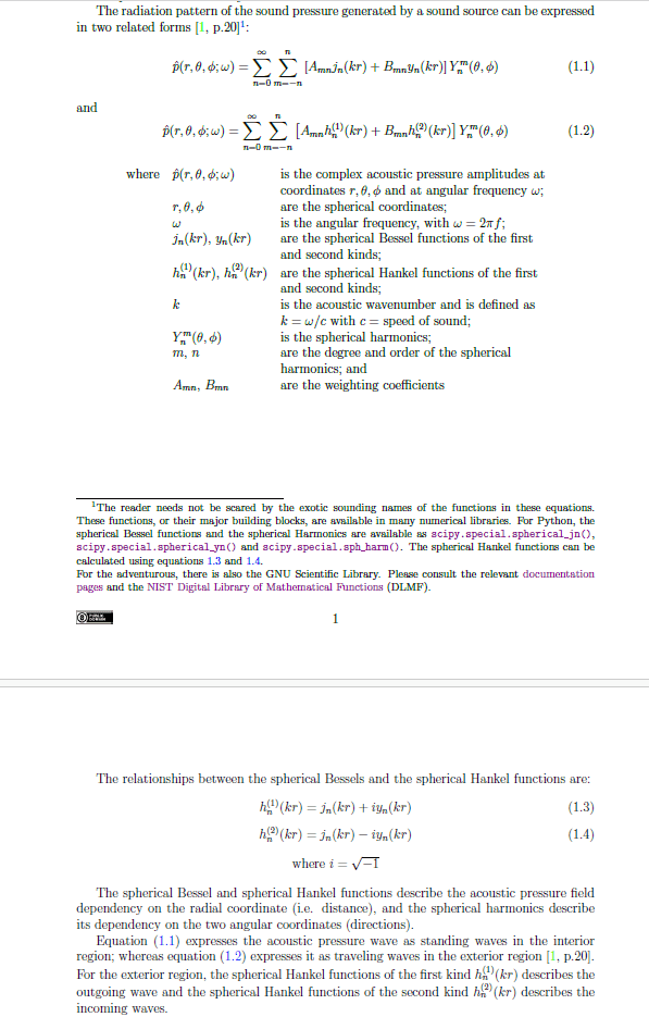

The other thing is about this page written by NTK:
In NTK's original code the difference between SFS and non-SFS was only using the outgoing 'mode' coefficients vs. all in reconstructing the sound field at the desired locations. In determining the coefficients all coefficients are calculated in both the SFS and non-SFS case. I thought that for the Gedlee-way I could leave out the incoming wave from the formula as that was done by filtering out echos in the IR. That would give me less unknowns and I would need fewer measurements. After some initial enthousiasm and heuristic high level thinking, I now would like to know how to do this exactly. Question two:

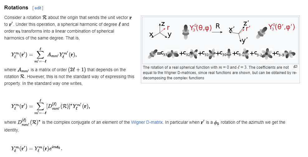

wrt the first question: rotation
Here is how it is done for the spherical harmonics:
In the 2D variant we only have 1 function for a degree.
Is it as simple as using the knowledge that the sound source is a speaker and align the 'beams' of the legendre functions with the forward axis of the speaker?
