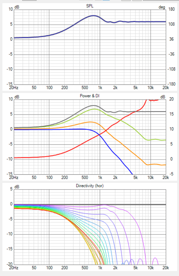

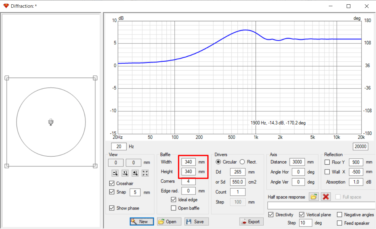

1kHz sized baffle has surprisingly lot effect, all the way down to 100Hz or so, and this is just the front edge on this simple sim. Depending on cabinet shape the back portion of the structure could have effect on lows as well. Unfortunately, no such sim available atm, but quick BEM could provide if needed.

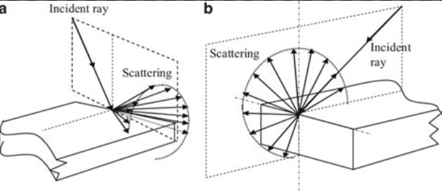

That is extremely strange, because one has to do with the difference in pi hemisphere radiation.Strange, to me they are the same thing.
Or in simple words, radiation goes into fully spherical or a semi spherical.
The other one has to do with second source (= diffraction) acoustic because of impedance jumps locally on an edge for example.
The second one is in particular very tricky because we move ourselves into non-linear acoustics territory.
While the other one acts on very basic and predictable math.
On a similar way, diffraction problems can be minimized by making a very smooth/rounded edge, while the baffelstep is totally unaffected by this.
Two totally, completely and wildly different things.
But check your physics and acoustics books, because at this level I am not even gonna discuss these things.
Beats me why some people assume they are the same thing at this level
