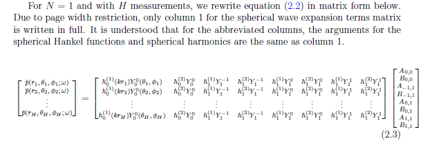

The condition number of a matrix is the ratio of its largest singular value to its smallest singular value.I had to look up wat condition number is. And still not sure how to calculate it.
We take the SVD of a matrix to find the singular values and then take the ratio of the largest to the smallest one.
I am pretty sure that these days, there would be built-in functions in all good scientific computing packages, which compute & return the condition number of a matrix once we give the matrix as an argument to the function. For example, Matlab uses this: https://in.mathworks.com/help/symbolic/cond.html
For context, the matrix that I was talking about was the one we use for solving for the scaling coefficients for the basis functions
As per an example in part 2 of NTK's document, the matrix looks like below for N=1
As the value of N increases the size of this matrix is going to increase significantly.

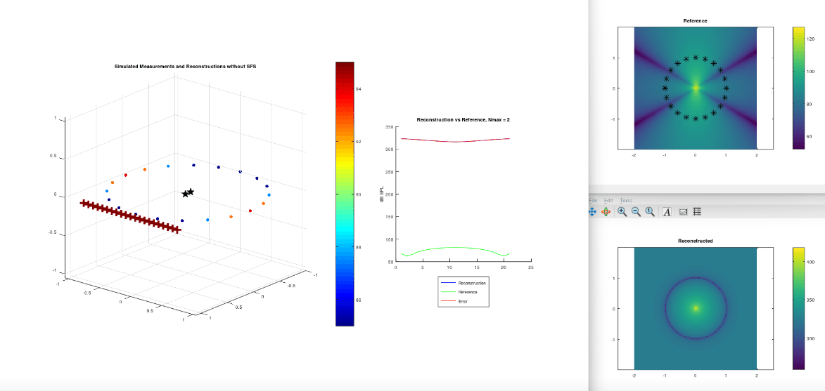

The reason why I was interested in finding out the condition number is the following. The matrix needs to be well-conditioned (condition number closer to 1) for us to be able to solve the system of equations properly. This happens when the rows/columns of the matrix are linearly independent, meaning one row/column cannot be obtained using a linear combination of other rows/columns.
Now when we look at the measurement locations distributed in a circle as in your earlier plot shown below, since all the measurement are at the same distance from the source (radius of the circle), the values of the spherical hankel functions (h_n (kr)) which determine the radial dependency will evluate out to be the same. This becomes similar to the rank deficient scenario explained in NTK's document part-2 pages 3 & 4. It won't help us solve the equation.
By randomizing the measurement locations, you are sort of removing this radial dependency and giving more chances for the system of equations to be linearly independent and become more solvable
Atleast, the above was my suspicion about the issue.. 🙂
Just for avoiding confusion, the matrix that I was referring to in above posts is the one just to the right of the "=" sign and contains terms of the form hn(kr)Y^m_n(theta, phi)
