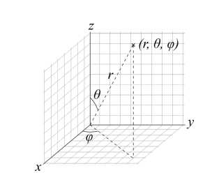

It is said that the sound waves from a loudspeaker at any point in 3D space (parameterized by r, theta, phi in spherical coordinate system) at a given frequency 'omega' can be fully expressed as a linear combination of the spherical harmonics. The pressure field value at location (r, theta, phi) at frequency 'omega' given by below equation
and its 'N' term approximation given by
According to the coordinate system definition for measurement defined here: https://www.audiosciencereview.com/forum/index.php?attachments/part_1-pdf.39272/
All points in the plane containing the horizontal polars (assuming it is the xy plane) can also be obtained from the spherical coordinate system by setting theta = 90 degrees and by varying 'r' and 'phi'
In such a scenario, the pressure field values in the horizontal plane (xy plane) as shown in the equation above can also be obtained by setting 'theta = 90 degrees or pi/2 radians (in which ever way the equation is defined)'. To evaluate the values, we need to substitute 'theta = 90 degrees' in the right hand side Ynm (theta, phi) function also.
I dont see this creating a set of linearly dependent set of equations theoretically and it deson't seem impossible to use some method (like least squares) to determine the values of the pressure field at any point in xy plane using the coefficients (Amn, Bmn) evaluated (with theta = 90 degrees). However, it cannot be then used to determine the value of the pressure field at any point in 3D space (to construct the directivity baloon) which the original method permits.
Hence, other than the 2D reduction of the original method, which I outlined above being only able to capture/characterize much less data (values of the pressure field only along a plane) than what is possible (can construct the whole 3D directivity baloon), I dont see an impossibility in using the above equations to a 2D analysis, unless I missed something obvious in a quick look at the equations.. 😀
(Well, implementation-wise, there is also the problem of how the spherical harmonic function itself varies in the xy plane and whether it results in a set of linearly dependent set of equations in the above described case due to any sort of finite register-width approximation)
