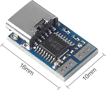

I've been looking for a way to limit the amount of wires, especially to the rotating part. First I tried a powerbank with PowerDelivery that is capable of 20V over USB together with a small 'decoy' to negotiate 20V and power the servo's with it.
For some info, use these search terms: pdc004 pd 20v
I ordered some, but got some fake stuff as far as I can tell.

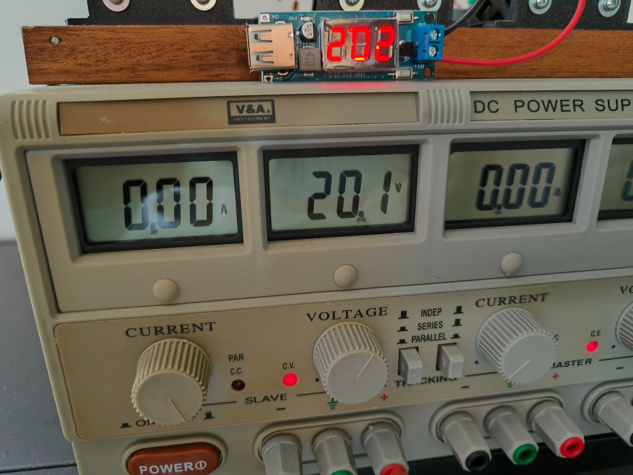

So I switched and ordered two small PCB's that have a 5V USB connection for the ESP32 boards and take 20V as the input, which I also need for the servo's.
Those who watch closely might notice that the small PCB is upside down, but luckily the voltage is 20.2V, so the only thing giving it away is the '.' .
I'll continue slowly 🙂

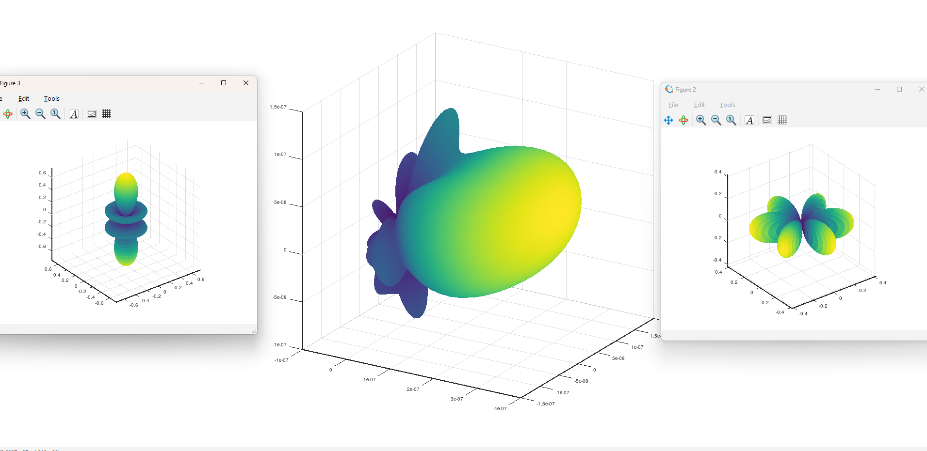

Over on audiosciencereview someone is looking into the fitting and reconstruction using python.
