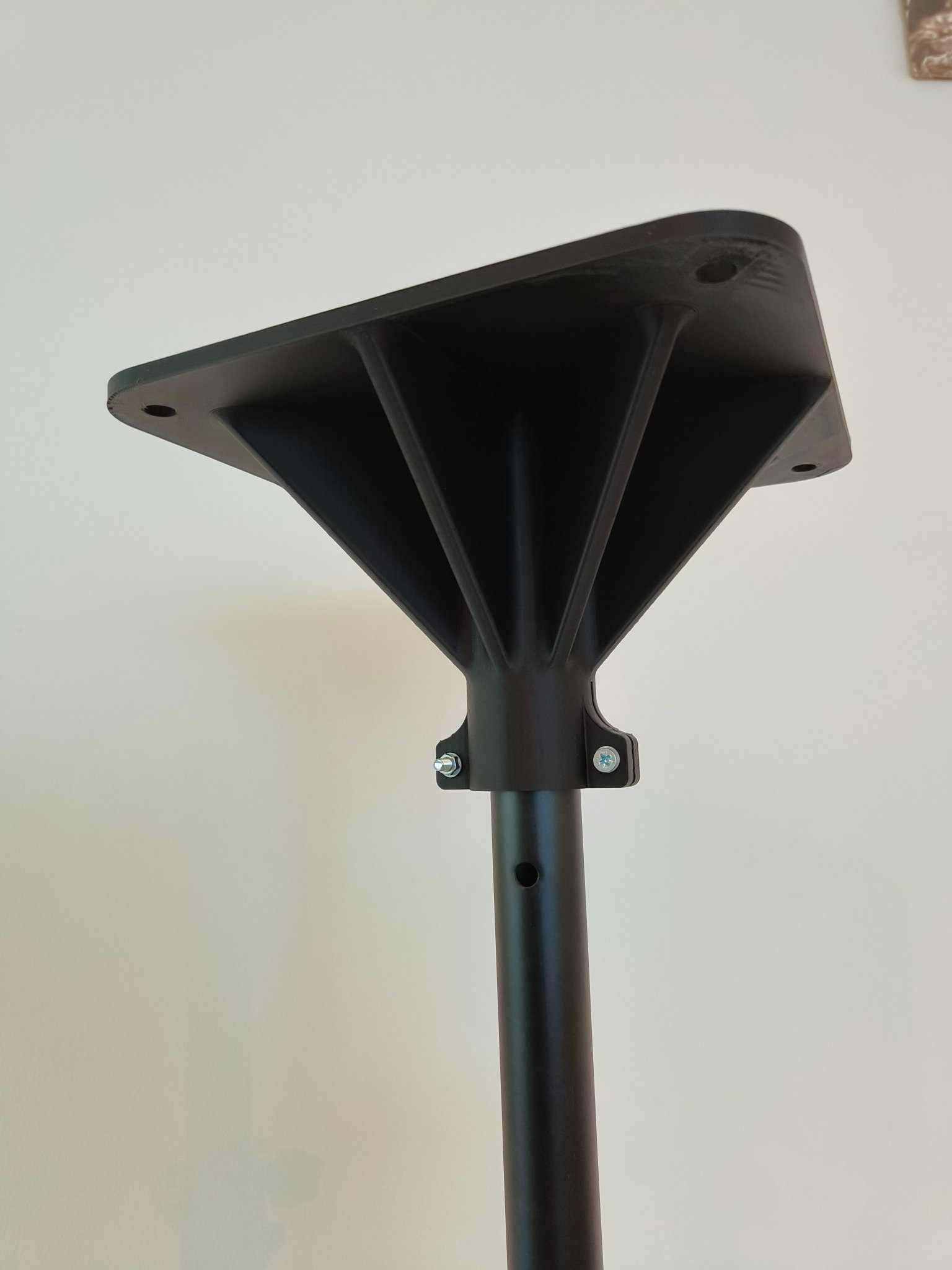

That one. I made the holder much more sturdy though.

It's doing a dry run at the moment. Z-motion is reversed somehow and I can find the setting to make it switch. I'm back to the good old A4988 driver iso servo42d for the radial and vertical motion. The ESP32 didn't want to boot properly with the other servo42d. Seems related to
The noise it makes is also far less. For the least amount of noise I need to connect the esp32's to a separate 5V supply and not the fancy ones that take the 20V and put out 5V.
