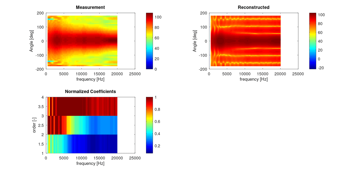

To me it looks like your coefficients above about 15 are noise. I almost never went that high as this kind of thing happens.
Also at the low end it seems like spurious level of the coefficients, which could be the singularity issue that I found - unstable matrix inversion. Small errors get amplified.

Not sure what I am looking at. Interpolating the measured data does not sound like much, but I guess I am missing something.
Calculating an approximation of the directivity based on a best fit using the associated legendre polynomials is one of the main steps in the Klippel processing. Just by eyeing the plots it appears the legendre polynomials approximation captures the main features of the raw data.

I should point out that equal angular spacing is not optimum when doing fitting to the Legendre Polynomials. That's because the polys arguments are cos(theta) and not theta. For an optimum fit the angles should be equally spaced in cos(theta) - more angular resolution forward and less backward, which only makes sense since forward is where all the variations happen. I don't recall the exact spacing that used, but I am sure that I could find it and I'm sure that its on my website somewhere. I think it was 5 degrees to 25 then 10 to 60, then 20 - something like that. The exact values aren't critical.

I may be imagining this incorrectly. From a measurement perspective, as you are closer to the nearfield you have less reflections as the dominant part of the signal. So are you saying that as you go farther away you need more randomized angular data? This makes sense to me. Interpolation of what you have as a nearfield reference. Nearfield will be our standard (and then as we go farther away we can generate an angular measurement with a correction factor?)I should point out that equal angular spacing is not optimum when doing fitting to the Legendre Polynomials. That's because the polys arguments are cos(theta) and not theta. For an optimum fit the angles should be equally spaced in cos(theta) - more angular resolution forward and less backward, which only makes sense since forward is where all the variations happen. I don't recall the exact spacing that used, but I am sure that I could find it and I'm sure that its on my website somewhere. I think it was 5 degrees to 25 then 10 to 60, then 20 - something like that. The exact values aren't critical.
YesI may be imagining this incorrectly. From a measurement perspective, as you are closer to the nearfield you have less reflections as the dominant part of the signal.
No, I don't see how the distance makes any difference. And the data points are never randomized - that would be sub-optimal.So are you saying that as you go farther away you need more randomized angular data?
There is no interpolation?!This makes sense to me. Interpolation of what you have as a nearfield reference.
I don't follow the issue.Nearfield will be our standard (and then as we go farther away we can generate an angular measurement with a correction factor?)
You measure in the near field and fit the data to the nearfield polar modes. Then you use those modes to calculate what the far field data is from the nearfield measurements.

I never really did find a "solution", more like a work around. I simply fitted the LF data using a model based on Fs and Q of the woofer. In my system the results for LF always seem to blow up. I often wondered how Klippel dealt with this.
I assume that the code being used is using SVD, otherwise, it should as the matrix is clearly becoming singular at LFs. SVD will help, but even it has limitations.

I would have naively thought that at low frequencies the directivity pattern would be simpler, with only large features (not much variation with angle) so life would be simpler. I’m no doubt revealing my novice status when it comes to singular value decomposition (SVD). I clearly have even more gaps to fill than I feared! Any intuitive explanation for why low frequencies are problematic?

It's simple, there basically are no differences from one measurement point to another at LFs. This means that the matrix to be inverted has rows that are nearly identical, in fact it has probably 14 of them. This means that they are not linearly independent making the matrix ill-conditioned and virtually singular. In fact one would guess, and this would be true, that only one mode should exist, namely the zeroth, the rest are redundant. Small errors in the data for higher modes get amplified by the math resulting in spurious values. At LFs there should only be the zeroth mode, but we see values randomly for the others. The plot that was shown shows this better than I could even describe.
I've often thought that the correct procedure would be to elliniate modes from the calcs as the frequency went down leaving just a single mode at the end. Or the other way, start with one and add ones in as their weighting factors get more significant. By weighting factor, I mean the modal impedances, if this impedance has a small magnitude then that mode is not contributing much and isn't needed. I did something like this in my code, but I was never satisfied. It could be looked at further, but not being a Matlab user, I am lost with code in that language.
