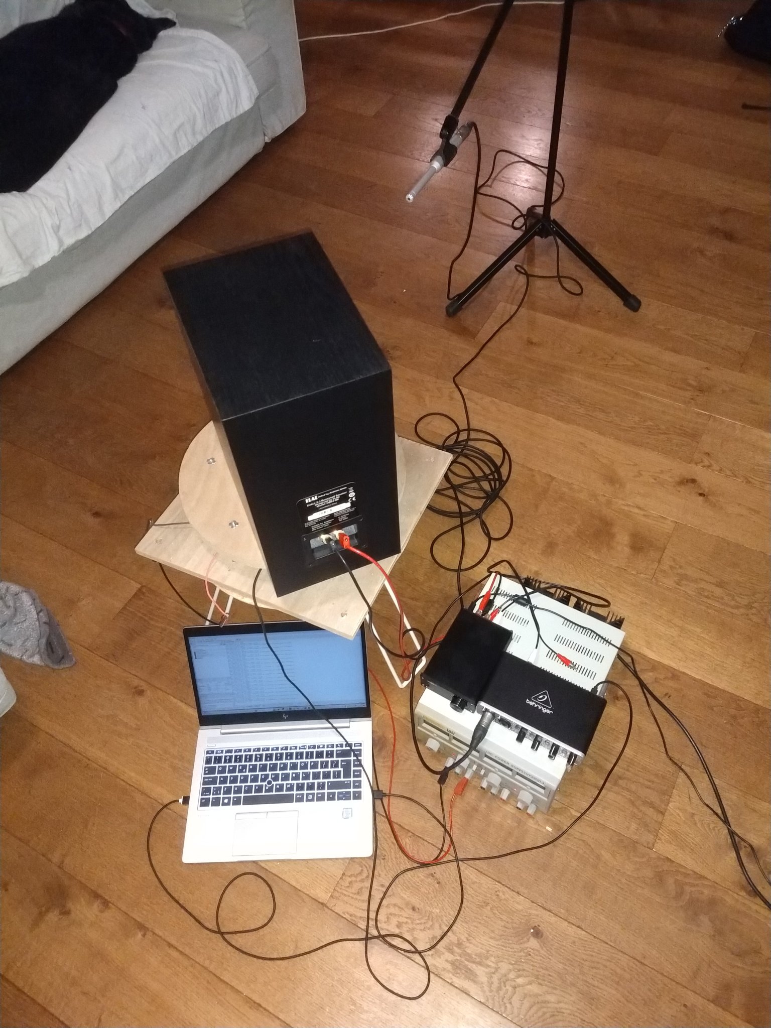

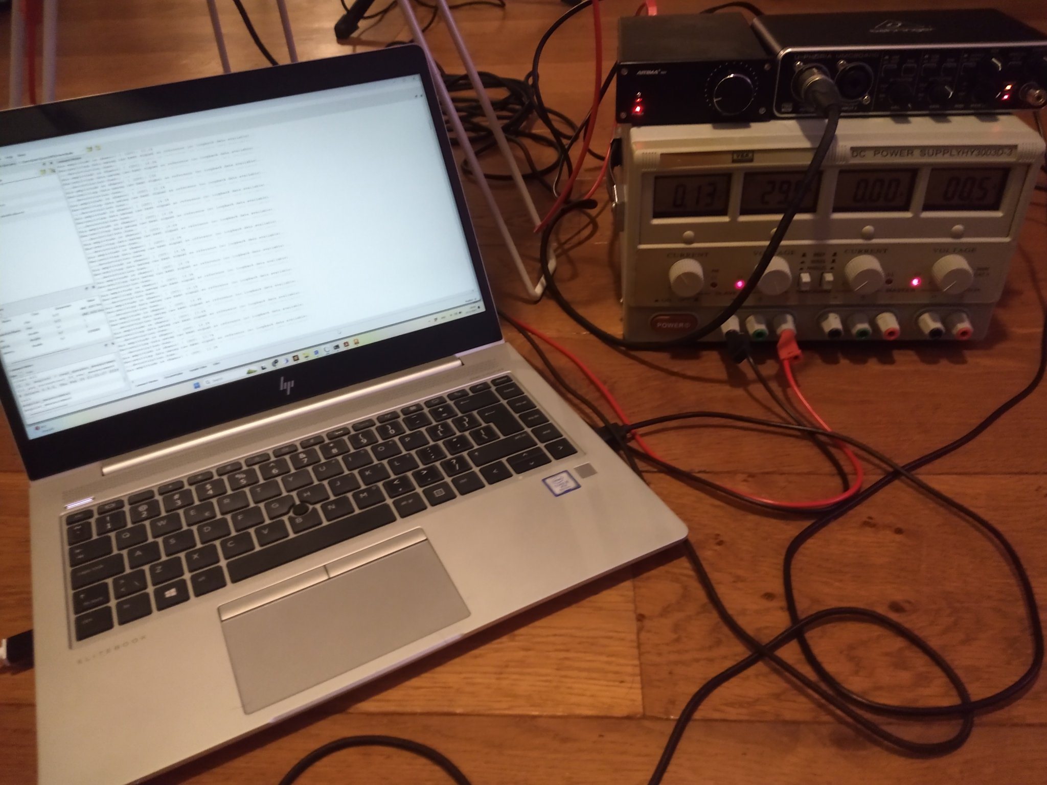

I'm currently running my first fully automated angular speaker measurement from Octave.
Thanks to @fluid for introducing me to tic, @jcga for his rotation table advice, @mbrennwa for MATAA and NTK for his sound field separation software and others for advice or showing interest.
Measurements will of course be of low quality given the way too small reflection free time and loopback is not yet working. I'll see if I can share them later.

Is the speaker rotating at the front of the baffle or middle of the speaker cabinet?I'm currently running my first fully automated angular speaker measurement from Octave.

This is great! It would be advisable to have a larger platform on top of your turntable. You want the baffle to be at the center of rotation so that it's distance to the microphone doesn't change with rotation.I'm currently running my first fully automated angular speaker measurement from Octave.

Have you checked for repeatability? And how well is the floor bounce being removed in the software, you are quite close to the floor and this will be around 1k if my napkin math is correct?

Depends on where you put the speaker. Currently it is roughly the front of the speaker.Is the speaker rotating at the front of the baffle or middle of the speaker cabinet?
Angular position repeatability/accuracy is very good and in practise limited by gear play/backlash which can also be circumvented by just going one way.Have you checked for repeatability? And how well is the floor bounce being removed in the software, you are quite close to the floor and this will be around 1k if my napkin math is correct?
Speaker and mic are way too close to the floor for a real measurement. This is a proof of principle and to iron out weird stuff. Currently the frequencies I get are not always the same, probably because the IR start is estimated. I would like to work with the same frequencies so I can put the results in an array/matrix. That are the things I wanna learn and fix by this setup.
