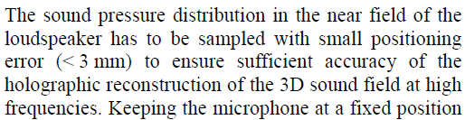

Might be all understood and redundant, but looking at what has been done can be useful I think:
https://www.klippel.de/fileadmin/kl...ld Measurement of Loudspeaker Directivity.pdf
As I understand the thread so far. 1 automated rotational axis, 1 automated linear axis for height and 1 manually adjusted axis for distance from rotational axis?
What would the needed accuracies be angular and height, and what time could be allotted for the system to stabilize after motion?
Would people be comfortable with permanent mounting holes or fixtures in their roof?
From the paper in the post above:

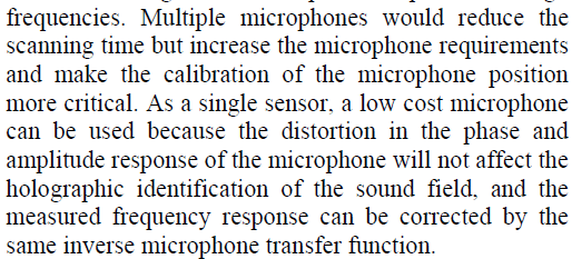

If/when someone is going to build such a thing, consider the option to use multiple microphones, so different positions could be measured in one step (different angles, different distances).
Makes sense, but:
That information has already been shared and talked about, but yeah here once more again. 🙂
Seeing how accurate steppers are these days, especially with a additional rotary encoder, I find the argument for the position accuracy weak.
Calibrating the mics relatively is also not a big deal.

Then we need referenced sources on doing this calibration properly no?Calibrating the mics relatively is also not a big deal.
I might have a few. The systems I have used did not require calibrating the two mics. But I think you are right. It will indeed need calibration if two mics are wanted.
Calibration of the microphones is indeed not a big deal these days (I am referring to the acoustics, not the positioning). Some microphones already come with a calibration file, and you can always send your mics to someone who does the calibration for you (I offered this service for a while, but I got lazy and stopped doing this). The main problem with mic calibration I see is that cheaper microphones (like Behringer ECM8000 and similar "entry level" measurement mics) tend to drift quite a bit over time, so they'd need re-calibration from time to time. I did not have this problem with quality microphones like Isemcon or Earthworks. I can't see how someone would take all the effort of building a Klippel sound field scanner and then skimp on the microphone quality.
You will need phase calibration to allow two mics to be used as references. SPL is as you say easy.Calibration of the microphones is indeed not a big deal these days (I am referring to the acoustics, not the positioning). Some microphones already come with a calibration file, and you can always send your mics to someone who does the calibration for you (I offered this service for a while, but I got lazy and stopped doing this). The main problem with mic calibration I see is that cheaper microphones (like Behringer ECM8000 and similar "entry level" measurement mics) tend to drift quite a bit over time, so they'd need re-calibration from time to time. I did not have this problem with quality microphones like Isemcon or Earthworks. I can't see how someone would take all the effort of building a Klippel sound field scanner and then skimp on the microphone quality.
It is not always the case that you require expensive mics. I have many. But as an example the Speaker tester pro system will use a Behringer ECM8000 and give you very accurate values as long as the SPL/Pa is accurately known. For this you need a mic calibrator.
Or stepper with a brake? Not as expensive as they used to be.Also, someone should test how close the mic can get to the steppers before it is a problem. We might need a passive braking system if it is bad.
Mark
If SPL is easy (it is!), phase is too. Mics are minimum phase, so phase can simply be determined from the SPL curve. I think I explained this already a few posts back.You will need phase calibration to allow two mics to be used as references. SPL is as you say easy.
The measurements are only accurate if the calibration is accurate. The calibration is only accurate as long the microphone does not drift away from it's calibration. That's not necessarily the case with Behringer ECM8000 and similar mics (mine certainly had drift problems).It is not always the case that you require expensive mics. I have many. But as an example the Speaker tester pro system will use a Behringer ECM8000 and give you very accurate values as long as the SPL/Pa is accurately known. For this you need a mic calibrator.
Also, it's not just about the sensitivity spec (V/Pa number), but also about the shape of the transfer curve.
I attached the documentation of how I did the microphone calibration back then (it's in German, but it may still be useful with a bit of Google translate, DeepL or ChatGPT).
No, since it's about relative calibration, they just have to perform well relatively to each other.Then we need referenced sources on doing this calibration properly no?
Meaning; pick one mic the be the master and calibrate all slaves accordingly.
Source is not important, again because they need to be relatively accurate, not in absolute terms.
