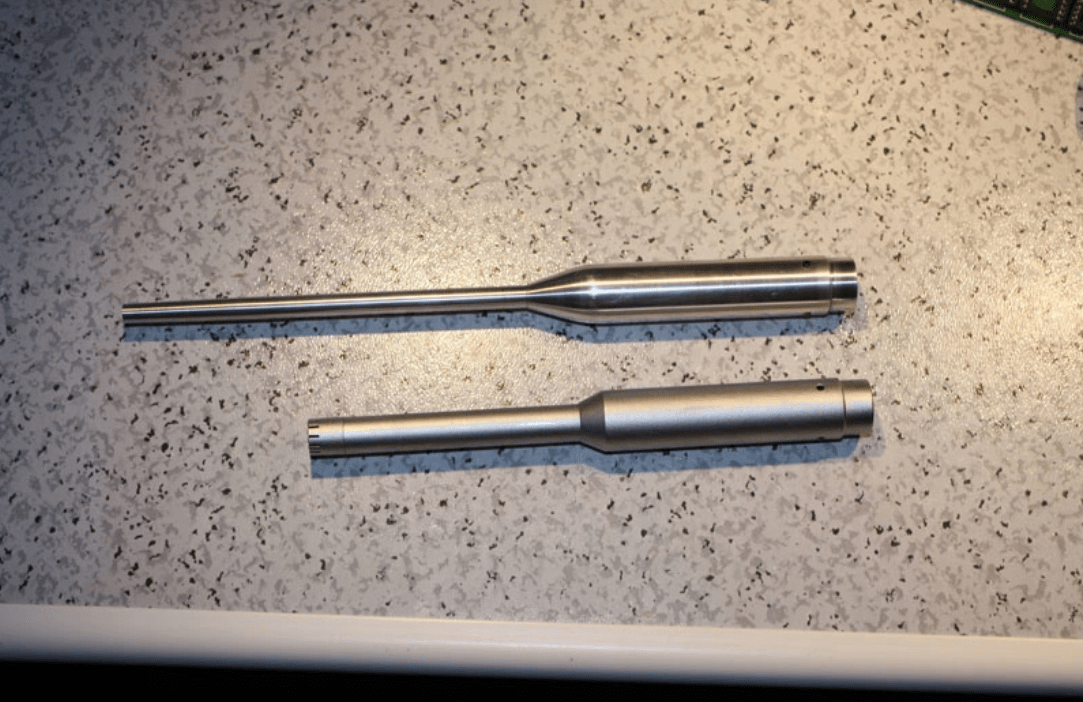

When I made my own mic many years ago (top one), I was actually planning to make the mount as well as XLR plug out of one piece.
That is not so super hard to do even with basic tools (although we had acces to a lathe back in the days).
I noticed that these mounts create quite a lot of reflections as well.
But yeah these things quickly become a very fancy solution, while the alternative is so super simple and effective.

A very nice mic body Bart.When I made my own mic many years ago (top one), I was actually planning to make the mount as well as XLR plug out of one piece.

I don't think it is much of an issue. Erin did a video where he showed the best method he could find to minimize them. Basically a Tube with an inner diameter that held the mic body and the XLR in a slip fit.Don't get hung up on the microphone / stand echoes.
Photography tube and clamping systems should work well. and if there are diameter differences heatshrink tubing or even a few layers of tape can make up the differences and allow a proper sliding fit.
Thin-wall (2mm) Carbon Fiber tubing (often used for drone’s). 😉
OD (outer-diameter) the same as the rear of the mic.’s OD. (..with an XLR male for the mic. and cabling through it terminating with another XLR female, unless it’s an IEPE mic..)
