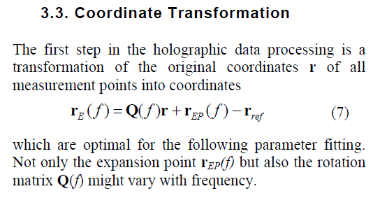

Actual position is not that important. In the Klippel document attached a few posts back, they optimize the source location and orientation for each frequency.
I would say we don't need an encoder as long as the stepper is not skipping steps.

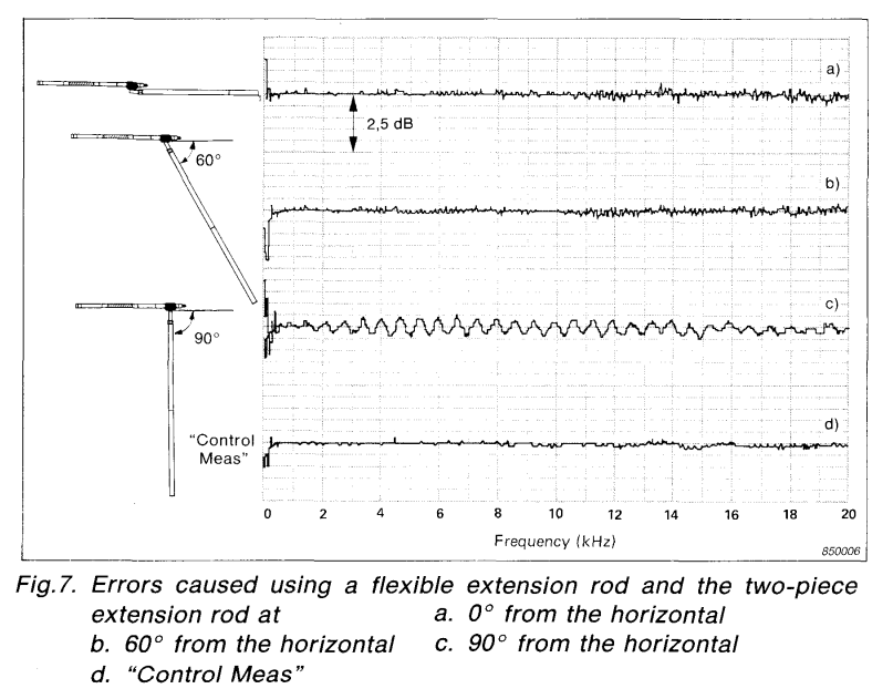

The klippel rotates the whole measuring arm. Then is radially moves and finally is moves the microphone up and down.
In ordinary speaker impulse measurements I think I see the influence of the mic stand in the measurements. @fluid pointed me to this:
For SFS we need to measure at two distances from the speaker. If we change the 'order of motion' to rotation, up/down and finally radially, most of the reflections from measuring device will be the same for the 2 measurements at two (radial) distances. It feels like that would give SFS the best opportunity to even calculate out the reflections from the measuring device, whereas with the Klippel NFS it can't do that as the reflections of the vertical boom change. Makes sense?
For rigidity is has both pros and cons I think.
Yes exactly. The mic and the mic stand reflections are always present in a normal measurement.The klippel rotates the whole measuring arm. Then is radially moves and finally is moves the microphone up and down.
What are we rotating? Mic Boom like Klippel or Loudspeaker?If we change the 'order of motion' to rotation, up/down and finally radially, most of the reflections from measuring device will be the same for the 2 measurements at two (radial) distances.

I find that picture rather strange.The klippel rotates the whole measuring arm. Then is radially moves and finally is moves the microphone up and down.
The mechanical momentum is the biggest by (a), followed by (b) and very little by (c), since the mass is basically at the mechanical reference point.
So unless this picture and experiment was taken on a different planet, but I find the results very strange to say the least?
Unless we are looking at reflections from the beam instead of vibrations, but it's a bit unclear at this point.
-referencing beam reflection’s (I think).
