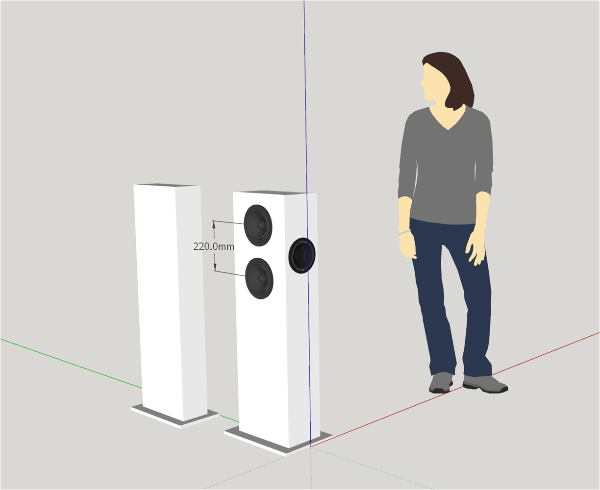

Here is a Sketchup screenshot of a mockup of a 5.5" coax with 4 6.5" woofers, the new MISCO XBL2 devices which have enough displacement for -3db at 30 Hz at 105 db in half space. The box is the same size as the LS60, except 50 mm wider. At that width there is barely a 1 mm gap between the horizontally opposed woofers so it needs to be a tad wider. It does loom wider than the LS60 but I doubt that matters much in a furnished living room. The benefit of the larger size is 54 L of internal volume. If just 40L of that is used for the woofers, it takes less than 50W to reach Xmax. The much smaller volume allocated in the LS60 is the reason it needs so much more power.

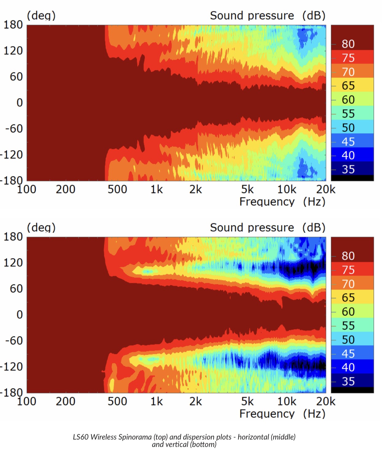

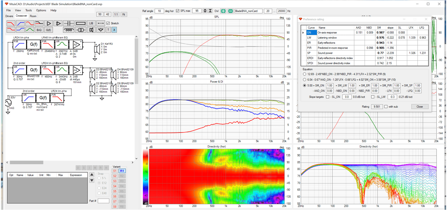

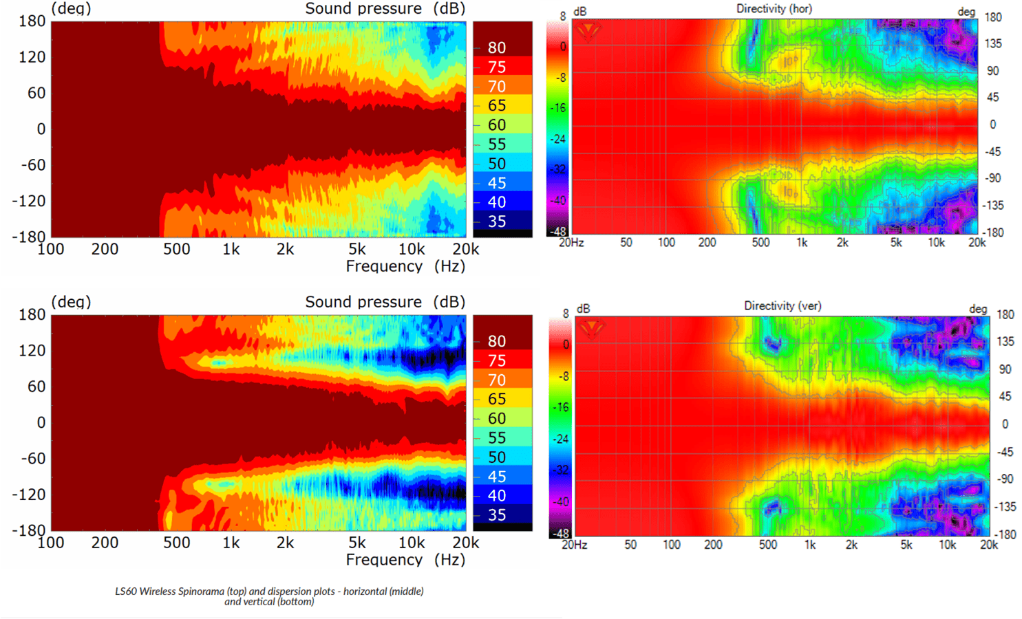

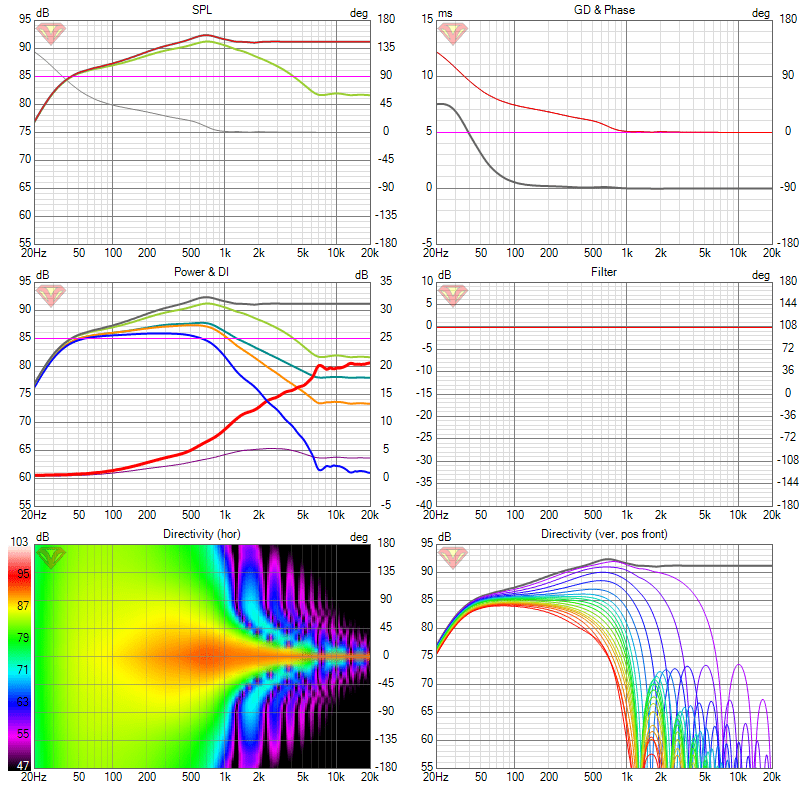

I did a Vituix sim with mirror equalized crossover and diffraction tool generated directivity for the woofers. I used the Klippel NFS directivity from the ASR Kef R3 review for the coax. I then compared the simulated polar maps with those in the LS60 white paper. Finally, a Vituix screenshot.
This design, as does most using the R3 directivity, achieves a 9.6 predicted preference rating out of a possible 10. It seems R3 layout, W-Coax_W, WWCWW, are more about maximizing woofer displacement than anything else. 4 of the Misco 6.5s which have 10 mm xmax seems enough for home use sealed. I experimented with modelling a rear woofer/rear resistance vent and that can yield a cardioid like response for little extra complexity.

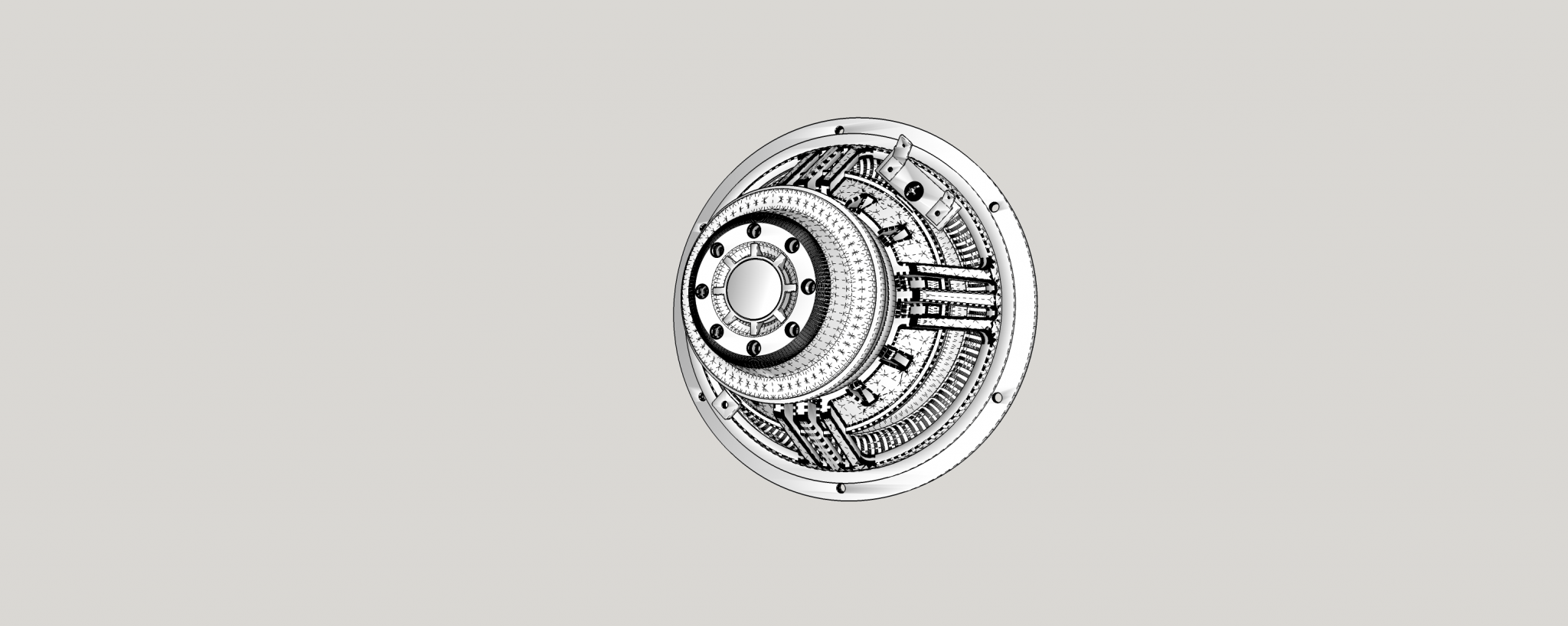

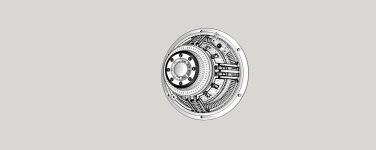

I agree. That is why I said it had to be a tad wider. If you look at the step file, you can see the details. They've added a cover for the polar vent to shape/direct the air flow to the sides. It seems to me with these you would only need about a 10 mm gap.
Depending on what cad tools you have, the step file isn't so easy to look at. I managed to convert to STL and then import it into sketchup but even zipped the file is too large to attach.

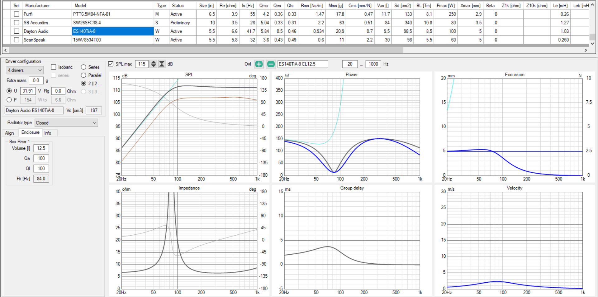

I did some brief modelling too, and can confirm that if one wants to maintain the svelte proportions of the ls60
ie. narrow just enough for the midrange/coaxial @ 130mm width, side mounded woofers results in a loss of about about 4.5dB below 300Hz, compared to infinite baffle. The other side of the coin of this, is that one can look at the 2pi response and it will be only a 0.5dB to 1 dB off.
If one applies the baffle diffraction signature of side mounted 5.25" woofers, to hit the maximum SPL target of 106dB@100Hz, 100dB@50Hz and 84dB@20Hz, so far the most suitable woofer for the job is the ES140TiA-8, as long the foam plug on the vented pole piece does it's job. 4 of them have enough volume displacement to hit those targets in 12.5L, and they are 67mm deep:
Everything else is too wide eg. E150HE-44, DIYSG 558, Misco 6.5" XBL for back to back mounting in 130mm.
If one was happy to increase the cabinet width to 180-190mm; that opens up options to many other choices, too, instance the venerable old RS225-8 (has fake vented pole piece)?
And then, should a driver then even need to be side mounted? 6.5" driver can be crammed into a 190mm wide front baffles...

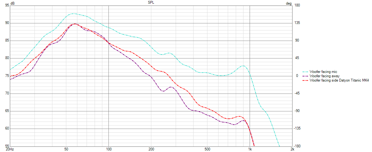

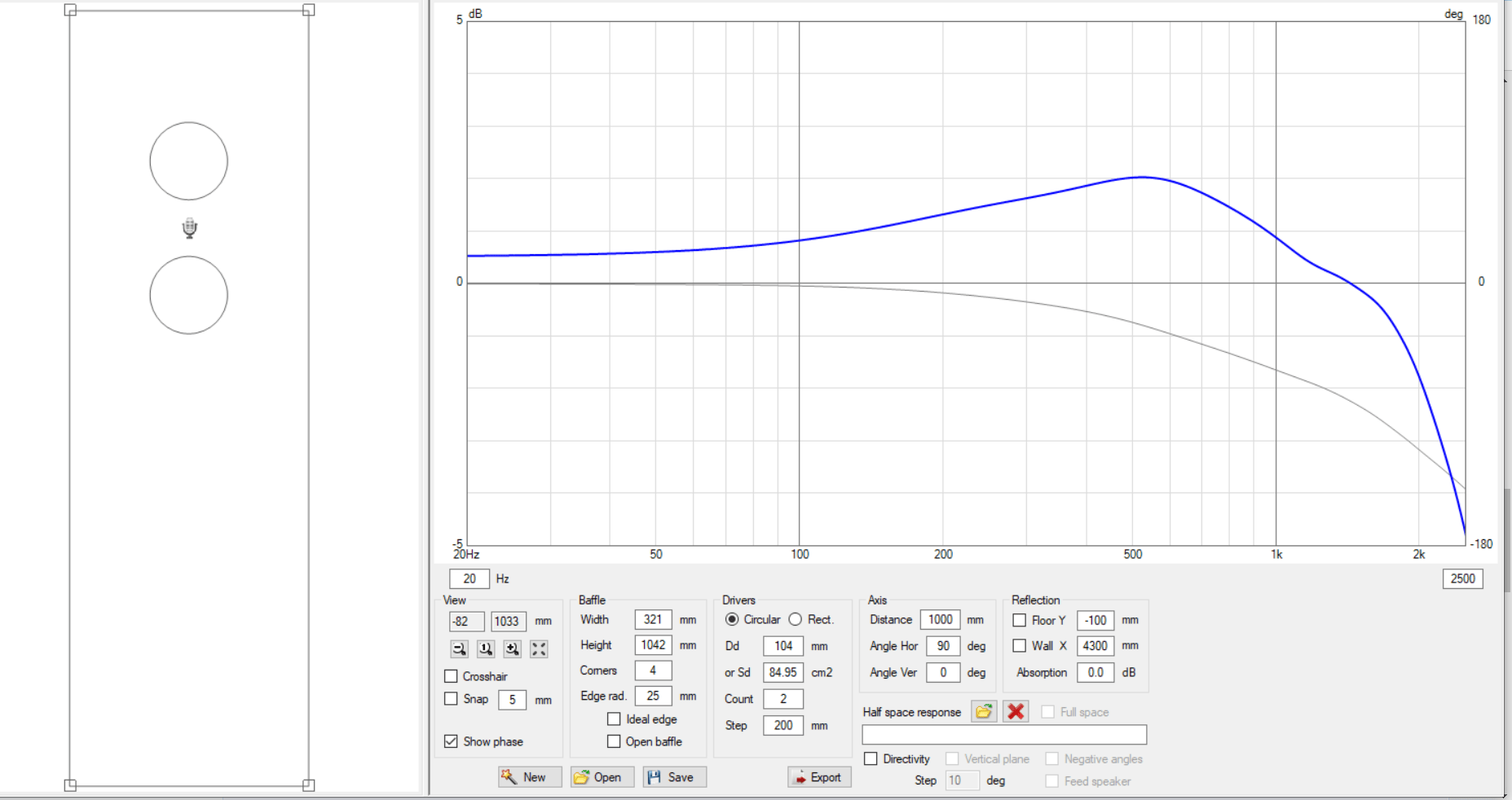

Here are some quick simulations I made for an ASR thread question about side mounting. These are for a 15" driver but the theory holds in principle just the frequency point where the same effect will be seen is different. The side mounting changes how the speaker radiates into the room, there is about a 3dB difference between the sound radiated to the side and what is measured at the 0 axis at around 150Hz. Above that the directivity of the driver causes the difference to increase and the DI to become negative. A smaller driver would have this occur at a higher frequency and should be considered as part of the design to match with the crossover frequency. A blade style woofer mounting would probably benefit from more distance to the wall behind it and having less things placed in between the speakers for the energy directed that way to reflect off. For passive speakers it also creates a pretty good baffle step equalizer with no parts.
In the KEF graph you can see the same pattern, there is quite a lot of energy in the 90 to 120 degree off axis position between 500Hz and 1K.
Forward Mounted
Side Mounted
