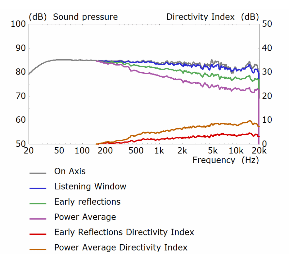

Oh. there it IS, in the white paper! That bump around 400 in DI and dip in power response in same region:

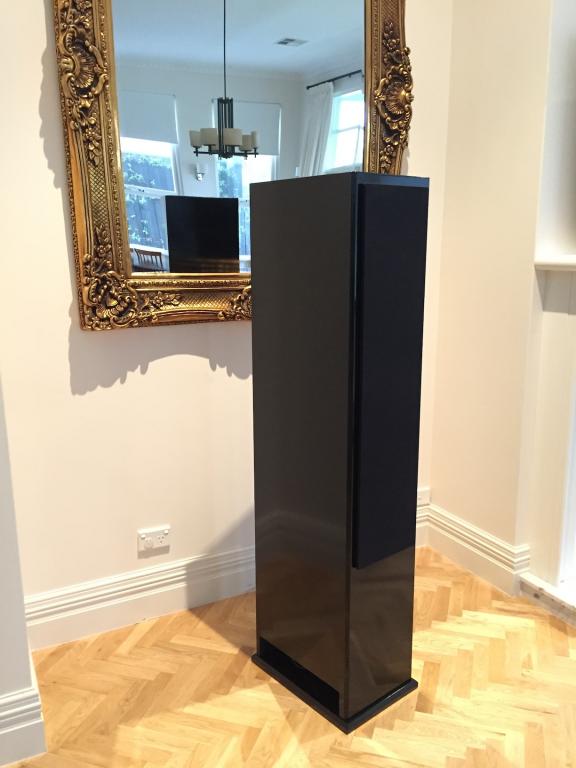

I have one in the works but it will be 200mm wide. I was thinking of the SB12MNRX2 and Fountek CD3 as the low cost option or upcoming 4” Purifi pure mid + tweeter as the top performance option. And planning on using quad 8” woofers. Basically a slim version of my 12” 3 way pictured in post #3.

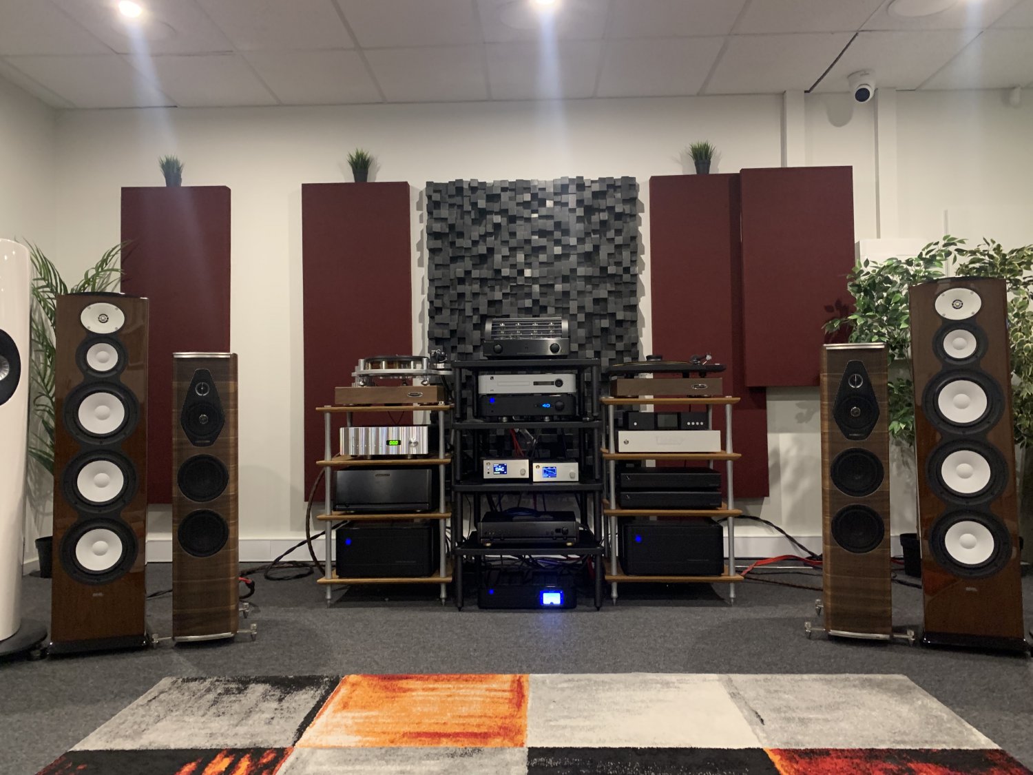

PS. I recently listened to the KEF Blade 2, Dutch & Dutch 8C and Revel F328Be for a few hours at a high end audio salon. I can tell you which one I would rather buy, and it wasn’t the KEF- I didn’t even bother to keep it in the photosnap.
so I’m not convinced yet about coaxial dot their single apparent source marketing.
Thr Revel F328Be, on the other hand, was such a solid contender for a “great box speaker, at a NOT crazy (audio jewellery) price”.

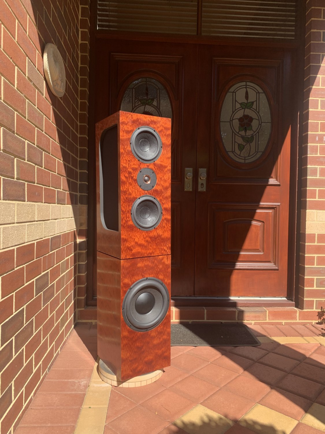

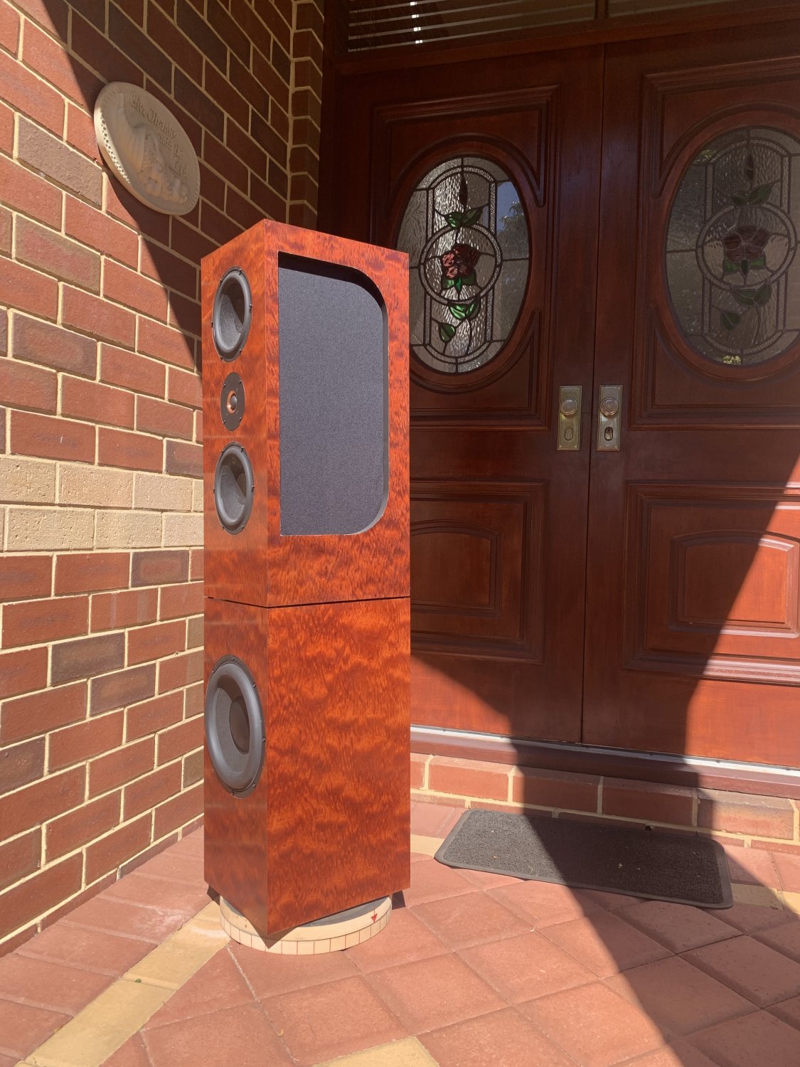

Brandon,
flat panels or curved?
I may be able to help:
My last built-by-me cabinets…
Reactions: kazap
As a small child, I feel that hull shaped plinth needs it's tipping point examined 🙂
