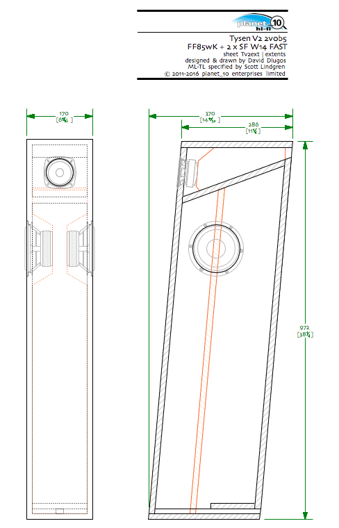

ysen is 4 cm wider. But a bit shorter. It could be made almost that skinny, but i did not want to compromise on box width for the midTweeter (the X-section are of the box is fixed anyway)This human scale shows why KEF marketing made the engineers go to so much trouble to shrink the baffle.
13cm wide and 109cm tall:
I could fit 4 into the available volume but would give up 10-15 Hz of extension at the bottom.
As X suggests these drivers have been specifically designed for the application and go far beyond what we can pick off the shelf. But, even down to the active system included inside the boxes, anything we do will both be “cruder” and potentially less compromised as was suggested, way fewer boxes, convenience, and WAF are a key here. Compromise: one of the worst places for electronics is inside a loudspeaker.

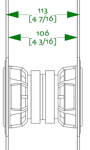

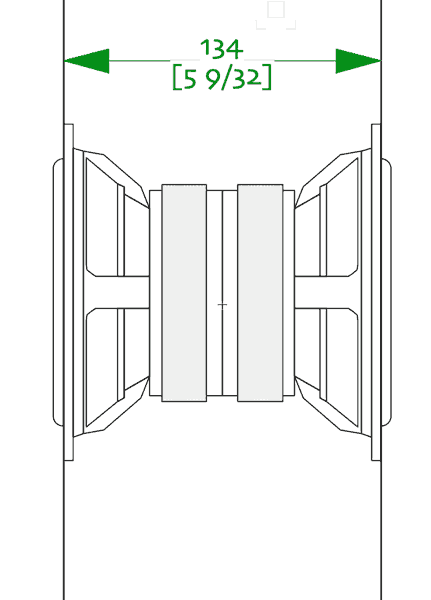

Something that could be shoe-horned back to back into a 5”/130mm wide cabinet?
Anyone got suggestions on how to do the shoe-horning? That is, mount the woofers in a forcing cancelling configuration?

I don’t think you need a special mounting method. You just need an appropriate list shallow driver, no?Anyone got suggestions on how to do the shoe-horning? That is, mount the woofers in a forcing cancelling configuration?

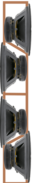

Using an offset design with four woofers could do force cancelling in both translational and rotational axis.
A 4.5" depth woofer might then fit in a 5" width. Driver choices increase eg Dayton Audio Reference Series RS270-8 10"
Just sum all forces to zero. In the x-axis thats easy. Torque wise the rotational axis will be floor contact so the design will need to have the feet height fixed. It looks possible to have zero net torque by designing the heights of the drivers to simply cancel the rotational forces, with woofers stacked R-L-L-R.
If for example, the slim box plus feet is say 110cm high with 0cm defined as the contact with the floor (the rotational axis) and the driver height set at eg 25cm 40cm 70cm 85cm then torque = (85 +25) - (40 +70) = 0
The compromises include:
- the lack of direct force cancellation from magnet to magnet direct contact with need for stiff construction. However most vibration will be in the y-axis and less detrimental to the front mounted mid and tweeter.
- driver separation distance limiting upper freq range
- box volume!
For a practical clone one’s attempt would have a minimum width would be defined like this… as long as you don’t have a pole vent (or don’t care if you cover it up).
This example is the silver Flute W14.

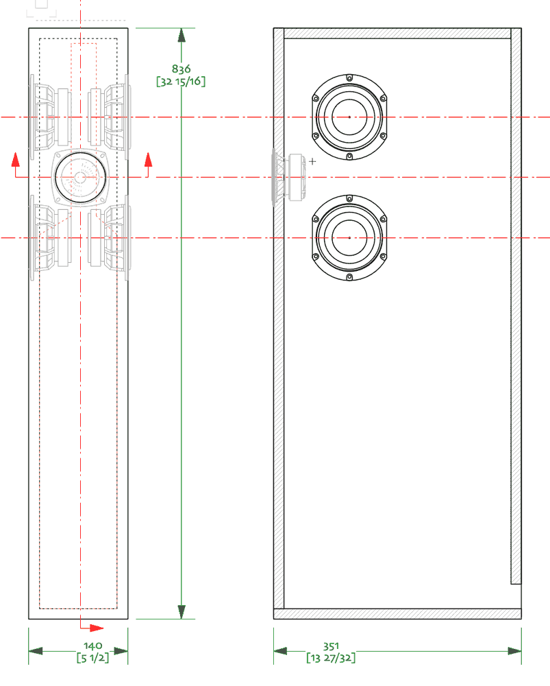

Here is a sketch of 4 x 830970 in a 14cm wide ML-TL (anechoic F10 about 35 Hz) budgetBlade™ style, put the midTweeter or mid in an XRK dagger. Use your favorite 3” FR or 3” MR+T.

This one. It would allow for a pretty narrow cabinet. I would leave 1cm distance between magnets and you are at about 13.5cm width.

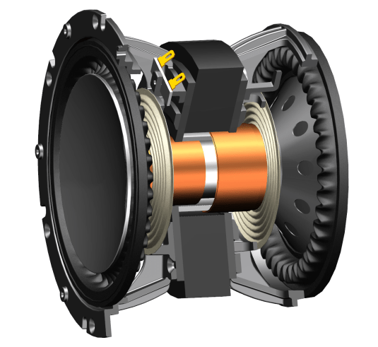

If you mount conventionally then forces are put into bending the cabinet and frame negating most of the benefits of force canceling. If you run rods for the mounting bolts the frame and rods flex plus the rods block the movement of air around the driver.
A reasonable job requires the magnets to be connected and to stiffly resist forces both pulling and pushing. I have seen DIYed wooden clamps which is a bit of a kludge. I was hoping for thoughts/examples on how to get close to commercial examples using normal drivers.
PS my speaker uses 4 x 5-6.5" woofers with a 5" coaxial in a 12" or so wide cabinet rather than an extremely narrow one like the LS60 but the mounting issues are likely to be fairly similar.
