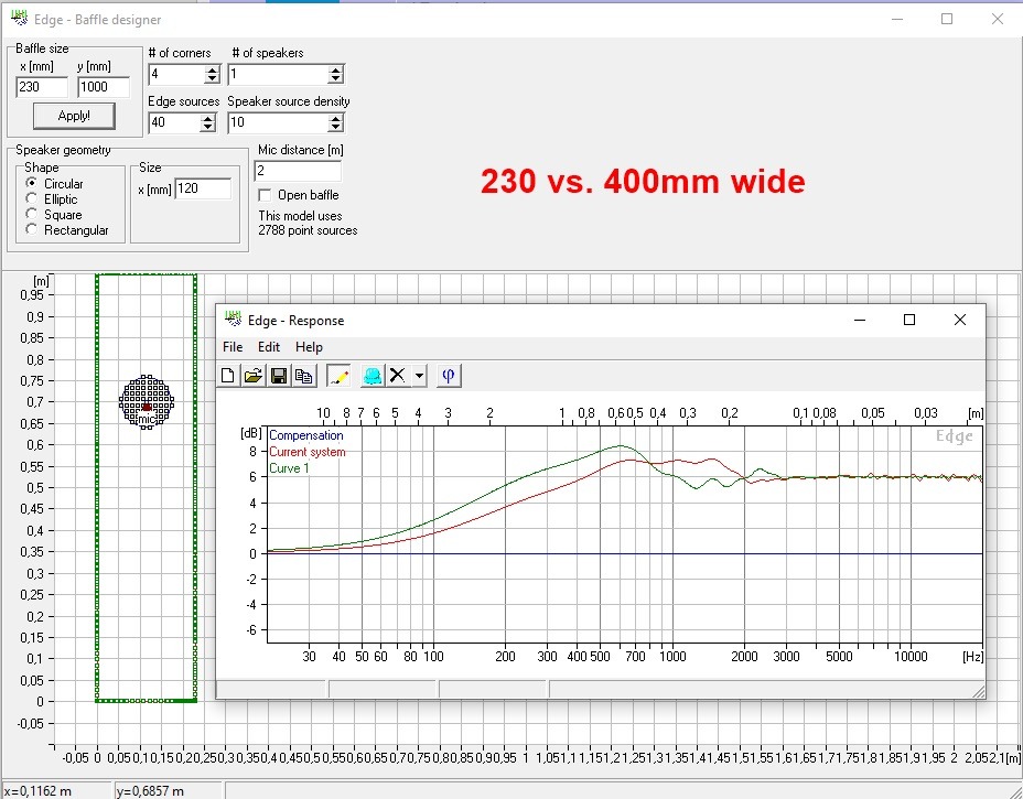

Looks like KEF made narrow baffle width one of the non-negotiables of the LS60 Wireless design, and came up with technical innovations to make it happen instead of having to increase the cabinet size.

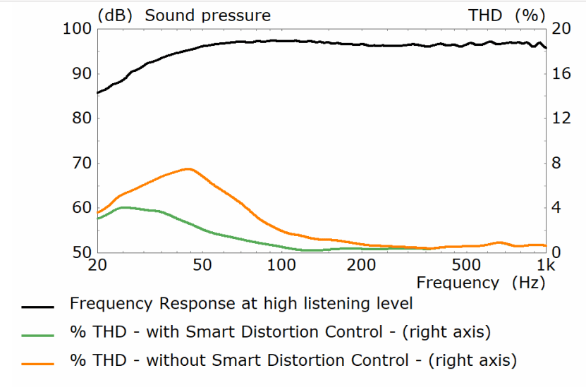

Yeah which ever way one wants to see it. I too want speakers disappear, only good sound is needed, the smaller the better in that sense. There is problem though, we need size to get enough bass. This is key. Even smaller mainspeakers would do if there is subwoofer system to help but if the mains is all we got I don't see we can get much smaller than this. Even this one resorts to DSP reducing lows as SPL increases, every bit of sound is reaped from the form factor.
Mind you, diffraction and other sound benefits we would want no matter the size. Size needs to be big enough for nice wide bandwidth and SPL capability. This can be achieved with good or bad sound, less or more diffraction, or any other "issues". To get more SPL with same bandwidth and quality the spekaer would need to be bigger. If less bandwidth and less SPL capability is fine, or quality compromized, then smaller speaker is fine. Its all about displacement and control, both come with physical size.

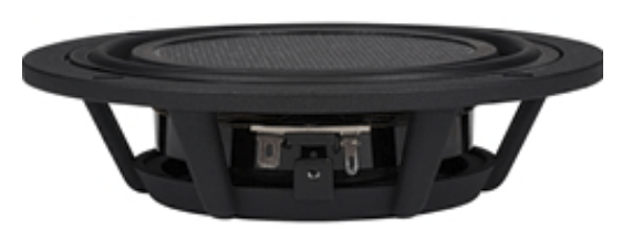

DIY could use low profile woofers to allow an even slimmer 4.5" frontal profile for good diffraction :)
Parts Express LW150-4 6" Low Profile Woofer 4 Ohms Depth 1.4"

Talk about custom drivers, Unicore dual different diameter voicecoils on shared mono-motor and 1 frame. Totally unobtanium. But flat pancake woofers like that shown above can also fill this role without being unobtanium and removable and replaceable individually.

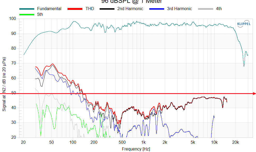

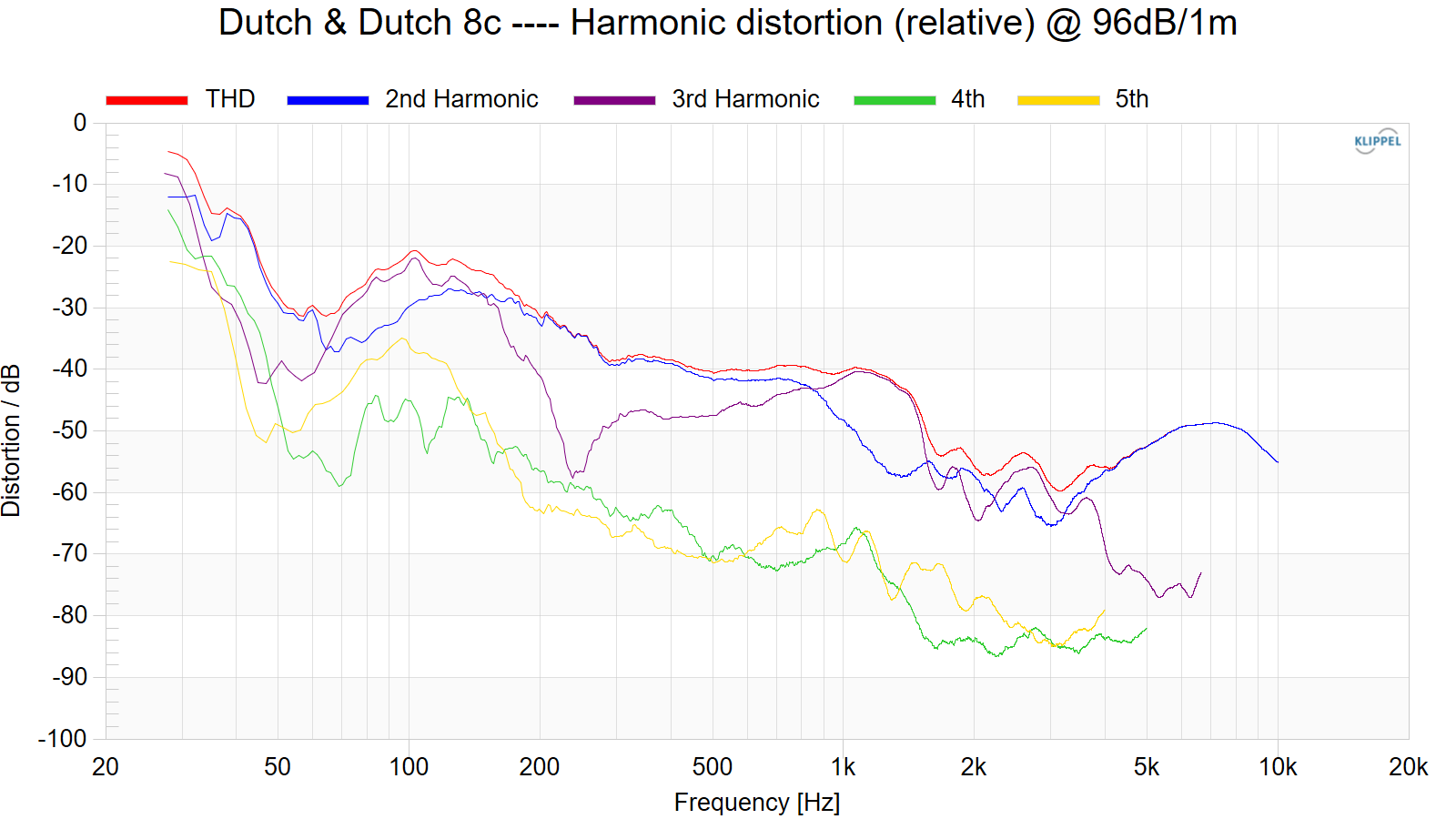

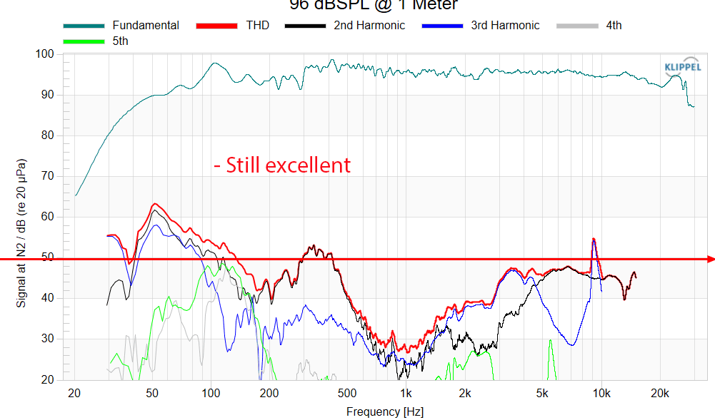

If you look at active loudspeakers that measure at the same level or better than Kef LS60 and can play at volume over 105dB/1m, there are very few. Genelec 8361A, Kii3, D&D 8C and Neumann KH420. Cheapest of the bunch is KH420 at a price of 8.000 euros and it's quite foul looking. None of the mentioned is a floorstanding loudspeaker. None of them has as much inputs and outputs nor do they posses as much functionality features as LS60.
Neumann KH420 - 8.000
D&D 8C - 10.000
Genelec 8361 - 10.000
KiiThree - 14.000
Yet, they exist.
Here is the distortion measurement of LS60 at low frequencies compared to other four mentioned loudspeakers:
LS60 -yet to be confirmed by a third party measurements
KH420
Neumann KH-420 G Measurements THD Distortion Active 3-way studio monitor speaker.png
D&D 8C
