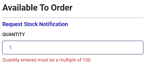

I also simulated the Peerless by Tymphany GBS-250F38CP01-04 shallow mount woofer. This is the bigger 10" brother to the 8" woofer that Zvu linked to. The price is ~$80 (Digikey says "available to order", but "request stock notification") and Xmax is 6 mm. It is also a 4 ohm driver (DCR = 3.45 R) so I simulated two in series. In a 30 L sealed box it has a Qtc of 0.682 and a F3 of 67 Hz. With a Linkwitz Transform (LW) set at 40 Hz and Q = 0.707 it has the same F3, F6 and F10 as the SB driver. At 150 W the output is 103.8 dB and maximum excursion is 5.8 mm. So this should work too. It has a mounting depth of only 40.3 mm (1.59") which would be reduced to ~24.8 mm (< 1") if flush mounted on 3/4" thick walls.

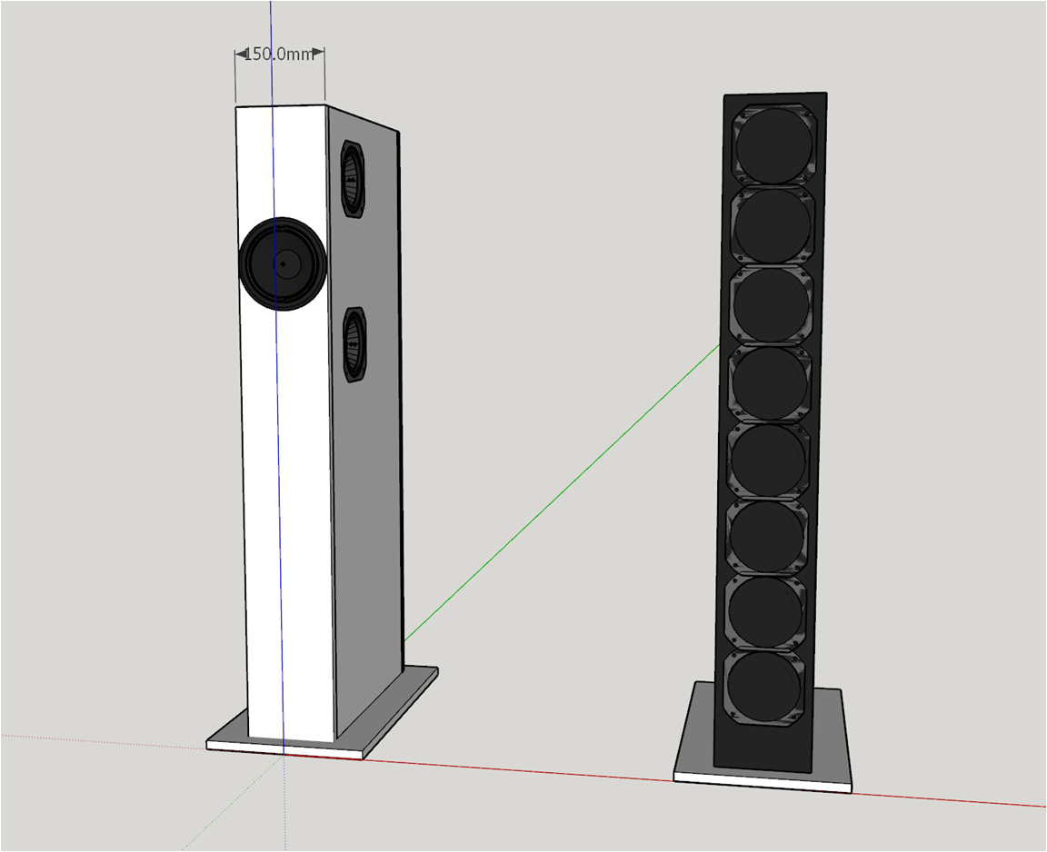

Here is a 2nd version of my paper LS60 clone. The width is now 150mm, just enough to fit the SICA 5.5" coax. The woofers are Faital Pro 5FE120. A line of 8 5FE120s has been added to the rear of the cabinet to act as subs from 100 Hz down. The F3 with 12 5.5" woofers is in the low 30's at 105 db SPL. There is plenty of volume inside for all the woofers; no panel area for a plate amp however. The 5FE120 has a unit price of $45 at Parts Express and an Xmax of 5.3 mm

If I were going to use just two drivers I would put them on the front baffle MTM style. Using the sides is a way to get 4 drivers equidistant and at lower CTC. How close you can get them depends upon how much of a rear chamber the coax's mid needs. A single driver per side would have less vertical directivity within its bandwidth. Side drivers increase the horizonal directivity. Front/MTM woofers do not unless you add resistive side vents for cardioid-like response.

This can be seen as a modified D'appolito configuration: the point is to simulate a 'point source' behavior mainly. It helps mitigate floor/ceiling bounce with it's symmetrical vertical behavior.
Check for 'Tysen' by Planet10. It is what you describe with only one pair of drivers. If crossed over low enough the full range ( or coax) /woofer can be located close enough to seems to behave as one and only driver ( centre to center distance at 1/4 wavelength of cutoff freq). With small drivers something in the 250/400hz vicinity.
