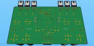

We are doing due dilligence with going through the schematics with a fine tooth comb and JPS64 is refining the layout based on these reviews. We are basically waiting for the layouts to be completed though by JPS64.
Prototype Layout Ready for Manufacturing

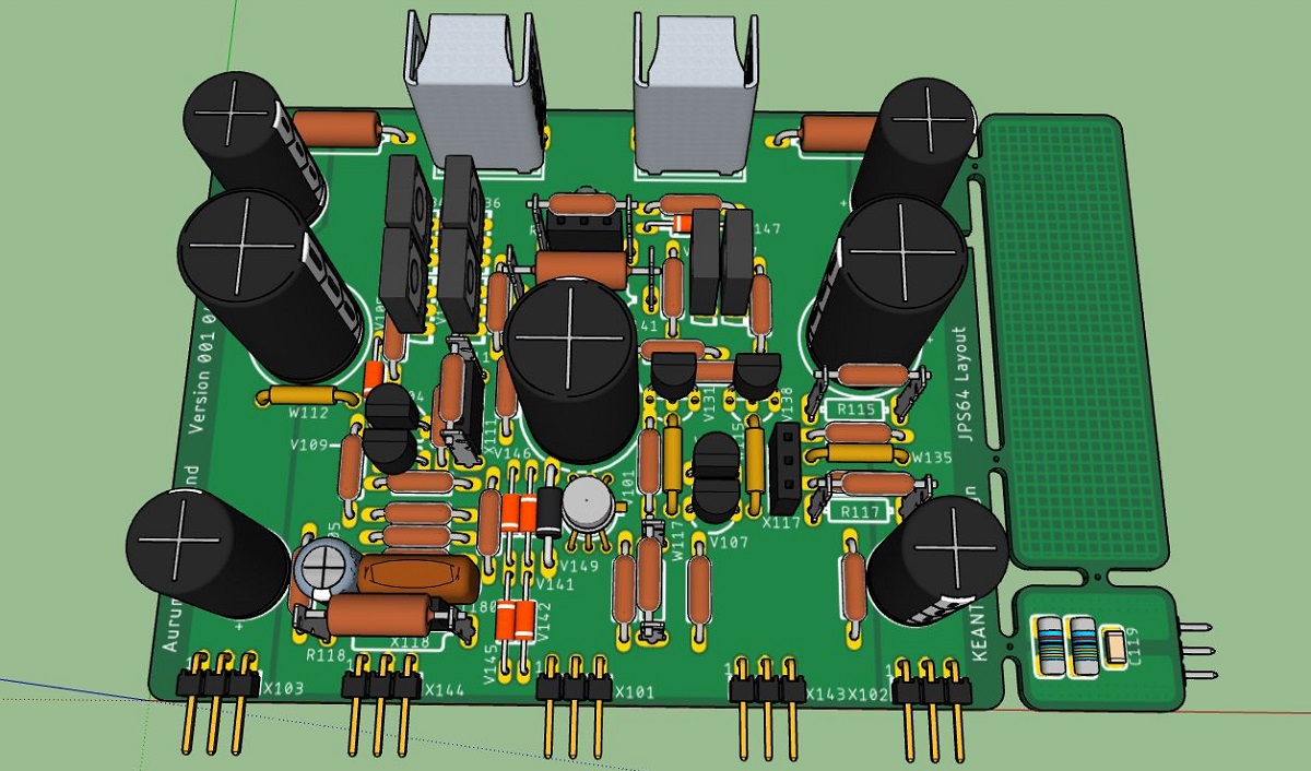

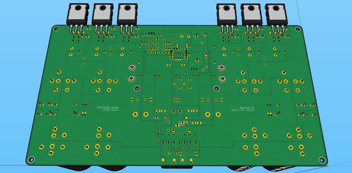

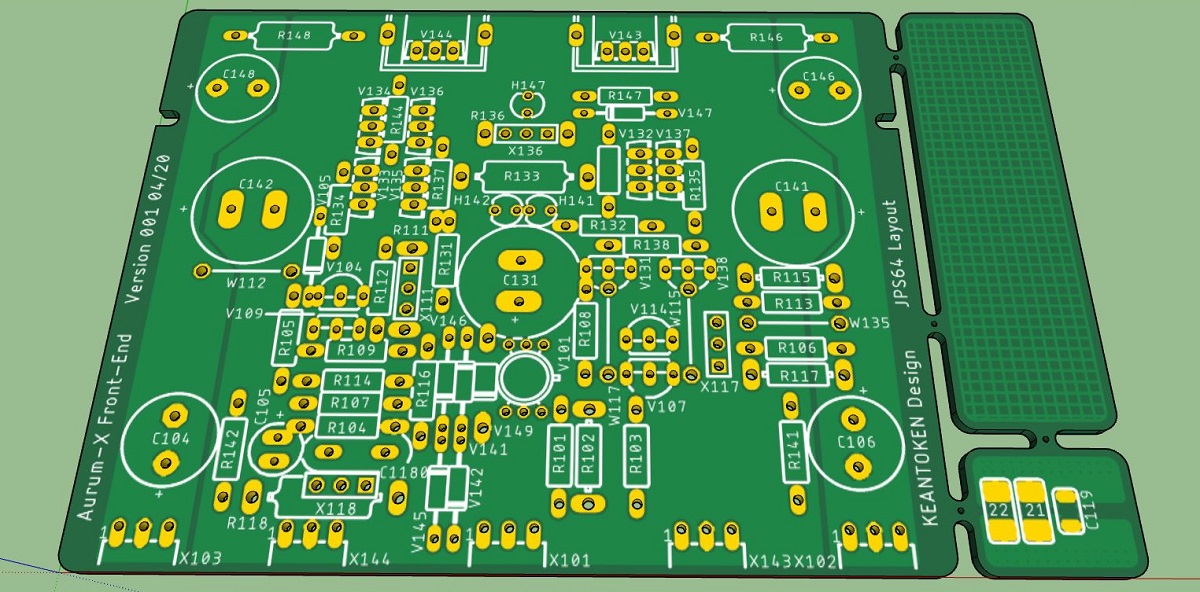

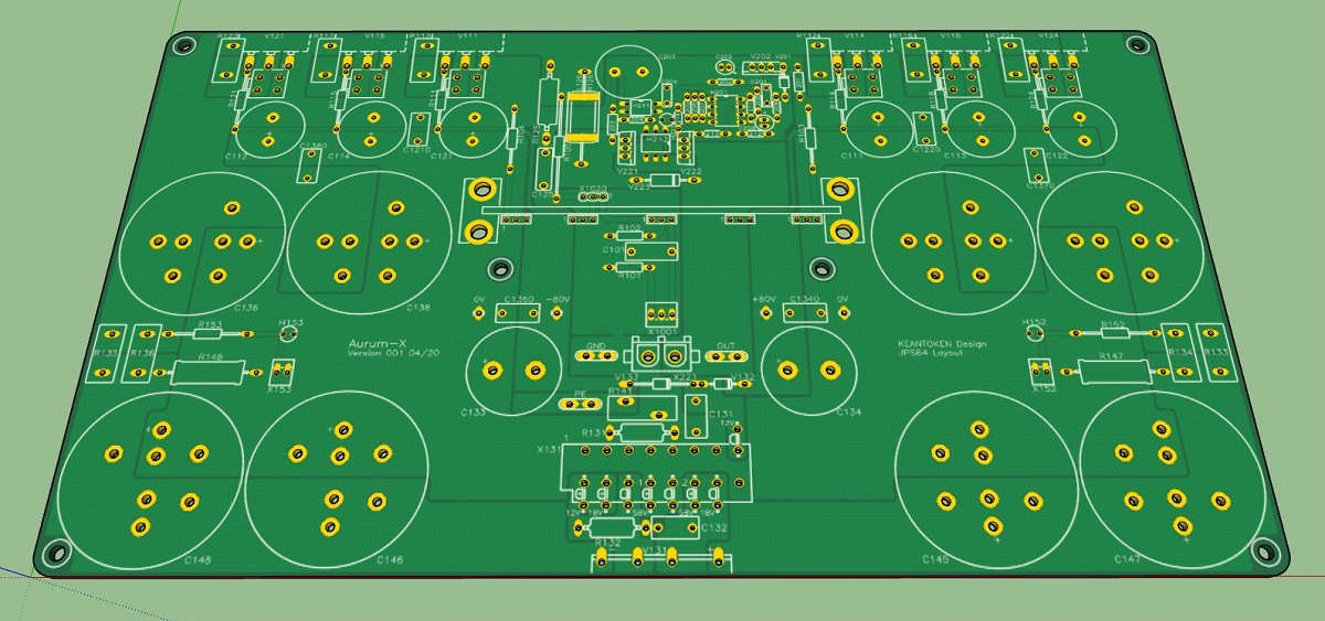

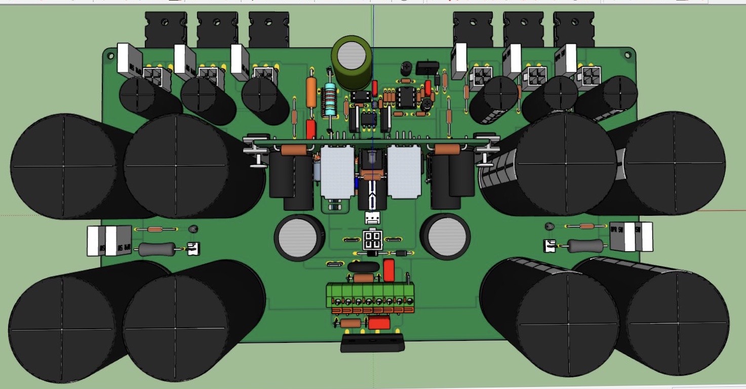

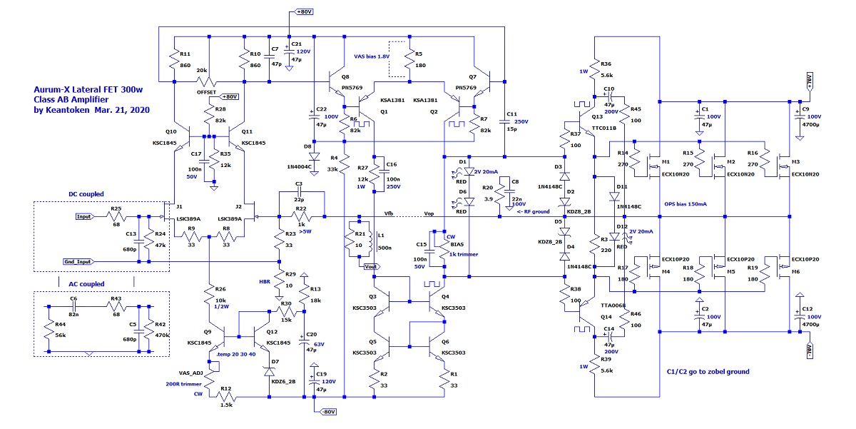

It's been a while since we have posted an update on this thread, much of it due to everyone's busy schedules and the vastness of this project - requiring a large amount of time to review schematics and double check interfaces, connections, etc. I think we are finally at prototype manufacturing stage though. Here are the schematics for the MainBoard(MB) and the FrontEnd(FE), and various renders of the PCBs and assembled PCBs.

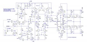

Here is the simplified LTspice Schematic used for the simulation:
The detailed schematics corresponding to the manufactured PCBs are in the PDF's below.

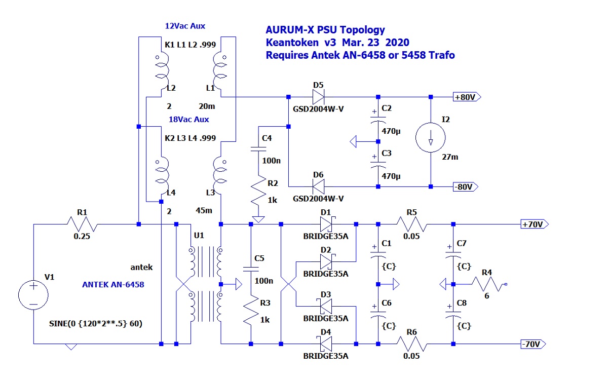

One major design decision was to go with an Antek 500VA or 600VA 58v an AN-5458 or AN-6459, respectively. The 500VA unit actually simulates better if we can believe the spice models that Antek puts out. Not that these transformers that provides auxiliary windings (12v and 18v) which are used to achieve the higher rail voltages for the FE through a half wave bridge. The connection diagram for the various secondary windings must be followed precisely as some phases are flipped. You will have to pay close attention to the PSU topology diagram and use that to correlate to the dot/no-dot leads on the various wires coming from the Antek. This is complicated by the fact that Antek does not label their leads dot/no-dot so some investigative work and experimentation will need to be done with test equipment prior to hooking up at full mains power.
Here is a schematic of the PSU topology to achieve +/-80v for the FE and +/-70v for the output stage:

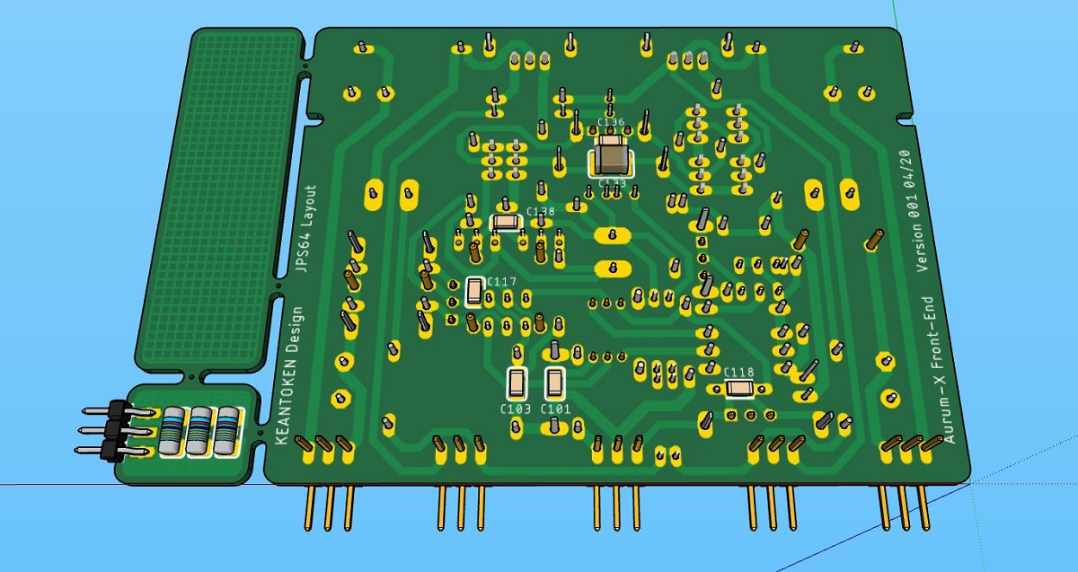

Here is the top view of the FE PCB:
Here is the assembled FE top side:
Here is the assembled FE bottom side:

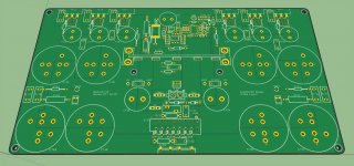

Here is the MB PCB top:

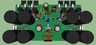

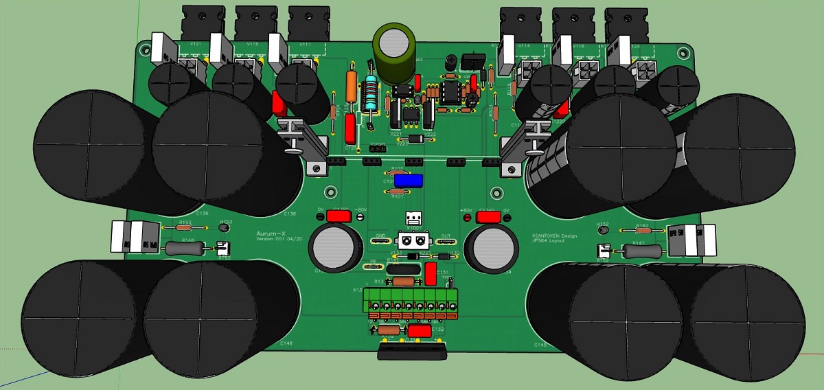

Here is the MB assembled top:
Here is the MB assembled bottom:
A big thank you to Keantoken for a super design and very clever PSU.
And a huge thanks and hats off to JPS64 for another superb layout of the highest caliber!
