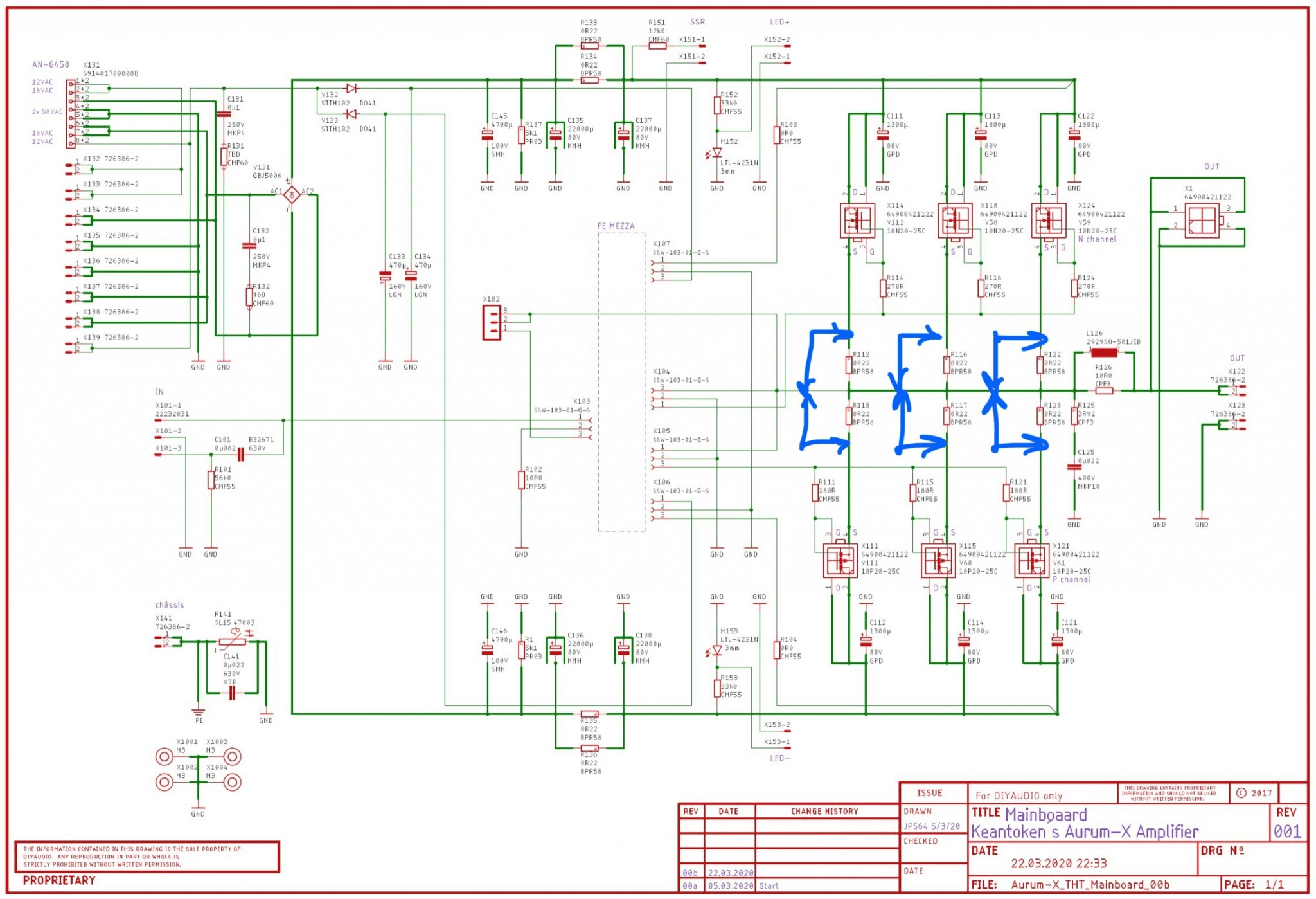

A good place to start would be lowering R20 in your schematic to 4.7ohms, maybe bump up the capacitor to 220nF, and take care that the capacitor is actually rated for the worst possible dv/dt, as I fried one before...

12MHz is pretty high, so it's likely there is too much phase lead, not too little. If there was too little the frequency would probably be lower. 22pF with a 910ohm feedback resistor is actually very little phase lead for an amp so something else probably needs to change. I would try adding a single gate stopper for all 3 MOSFETs on each polarity, make it a 1k trimmer. Find the gate stopper and phase lead values which allow the smallest stable value for the miller cap.
Originally i never hand matched them however after i had these oscillation issues i removed the pairs so there is only one complementary pair currently installed i.e. one N20 and one P20.Are the output fets matched?
I'm assuming you have 3 pairs, just like on your schematic.
If they are unmatched, it will oscillate.....

The compensation ends up changing when you use more or less pairs. So making it stable with 1 pair does not necessarily mean you can add the rest back and have it stable.
If it were parasitic oscillation, it would probably be 20MHz or higher.
We also don't know about your layout or the source resistors you are using.

In simulation, there are several things that can contribute to instability around 12MHz:
Zobel resistor too low. (check)
Gate stoppers too low. (check)
Driver base stoppers too low. (check)
C7 too low.
In the stable simulation I have the zobel network is 3.9ohm+22nF (100nF is fine)
Gate stoppers are 270ohm/180ohm
Driver base stoppers are 100ohm
These values can be seen in the output stage section of the build schematic:

Zobel = I have two zobels of 10 Ohm and 100nF (two off). I'll try 4.7ohms and 220nFIn simulation, there are several things that can contribute to instability around 12MHz:

Gate stoppers = 220 Ohm (P) and 470 Ohm (N)
Driver base stoppers = 100 Ohm
C7 = 47pF
C11 = 20pF (i'll try increasing this to 47pF)

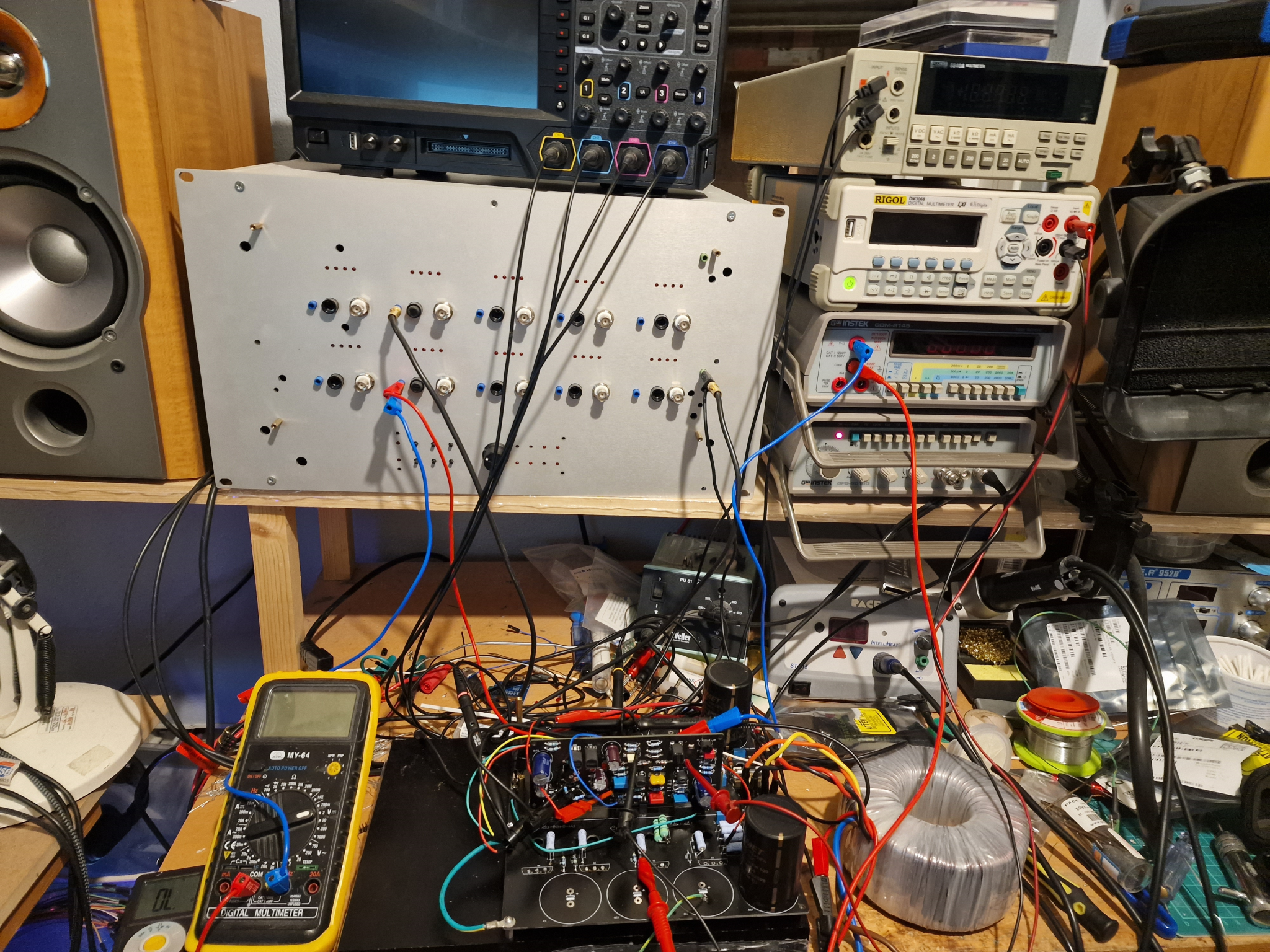

The temp setup i have with earth connections scattered everywhere is probably contributing to oscillations so i'll tidy these up as well and feed back.
Cheers
Dom
Third night of troubleshooting and finally I have figured out the issue - difficult to know if it was only this issue as I’ve went through so many iterations and changes but correcting the temporary earth wiring has solved the oscillation issue. I had mistakenly connected a PWR earth to input earth bypassing the breaking/lifting resistor and creating a loop.
Enough for tonight but now that I know I have it stable I’ll mount it in a proper chassis for full testing.
