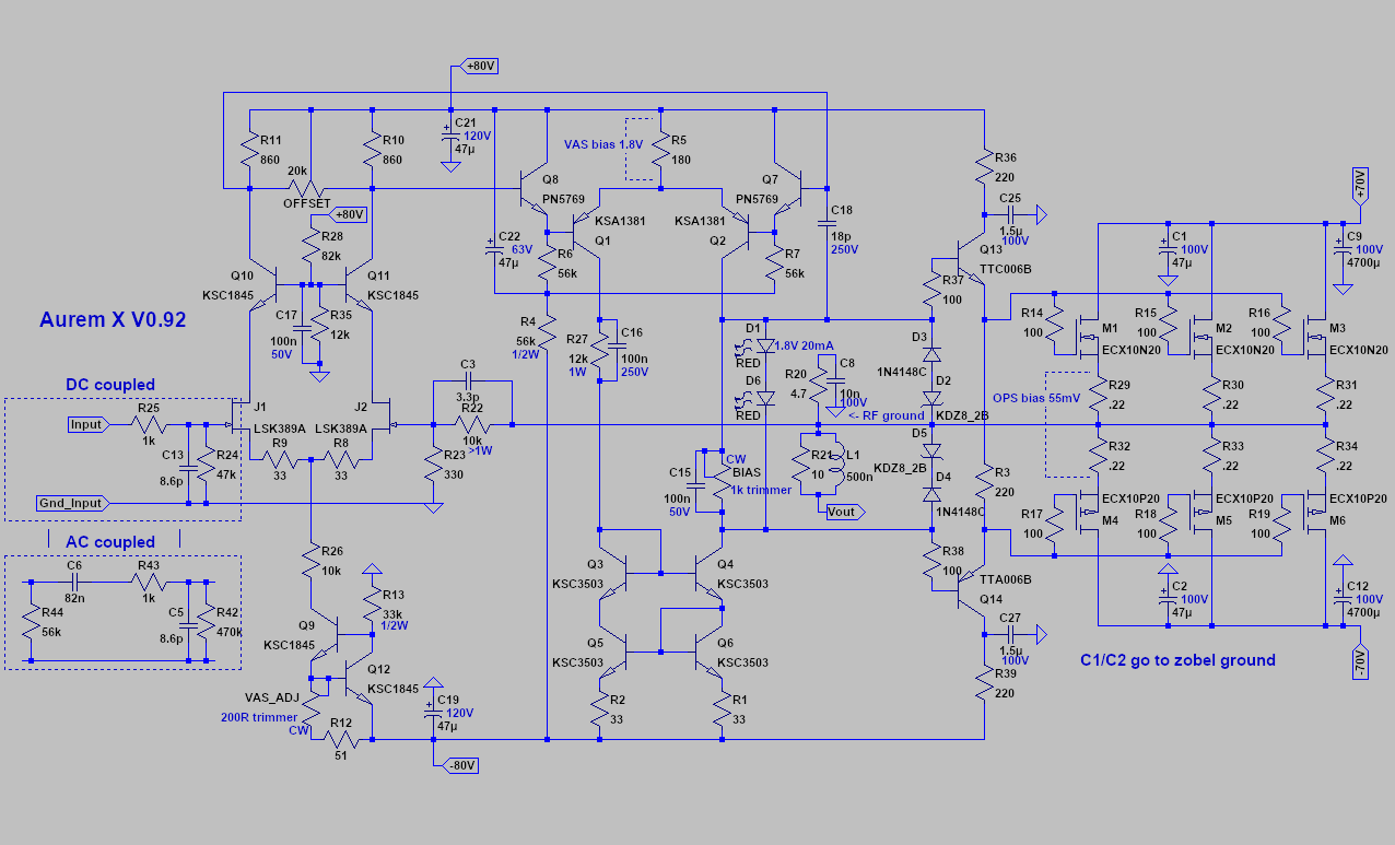

A good place to start would be lowering R20 in your schematic to 4.7ohms, maybe bump up the capacitor to 220nF, and take care that the capacitor is actually rated for the worst possible dv/dt, as I fried one before...

12MHz is pretty high, so it's likely there is too much phase lead, not too little. If there was too little the frequency would probably be lower. 22pF with a 910ohm feedback resistor is actually very little phase lead for an amp so something else probably needs to change. I would try adding a single gate stopper for all 3 MOSFETs on each polarity, make it a 1k trimmer. Find the gate stopper and phase lead values which allow the smallest stable value for the miller cap.

In simulation, there are several things that can contribute to instability around 12MHz:
Zobel resistor too low. (check)
Gate stoppers too low. (check)
Driver base stoppers too low. (check)
C7 too low.
In the stable simulation I have the zobel network is 3.9ohm+22nF (100nF is fine)
Gate stoppers are 270ohm/180ohm
Driver base stoppers are 100ohm

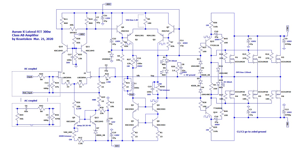

These values can be seen in the output stage section of the build schematic:

Zobel = I have two zobels of 10 Ohm and 100nF (two off). I'll try 4.7ohms and 220nF
Gate stoppers = 220 Ohm (P) and 470 Ohm (N)
Driver base stoppers = 100 Ohm
C7 = 47pF
C11 = 20pF (i'll try increasing this to 47pF)
The temp setup i have with earth connections scattered everywhere is probably contributing to oscillations so i'll tidy these up as well and feed back.
