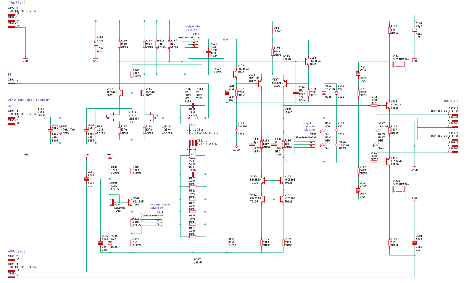

Here is the latest corrected schematic for the frontend board:

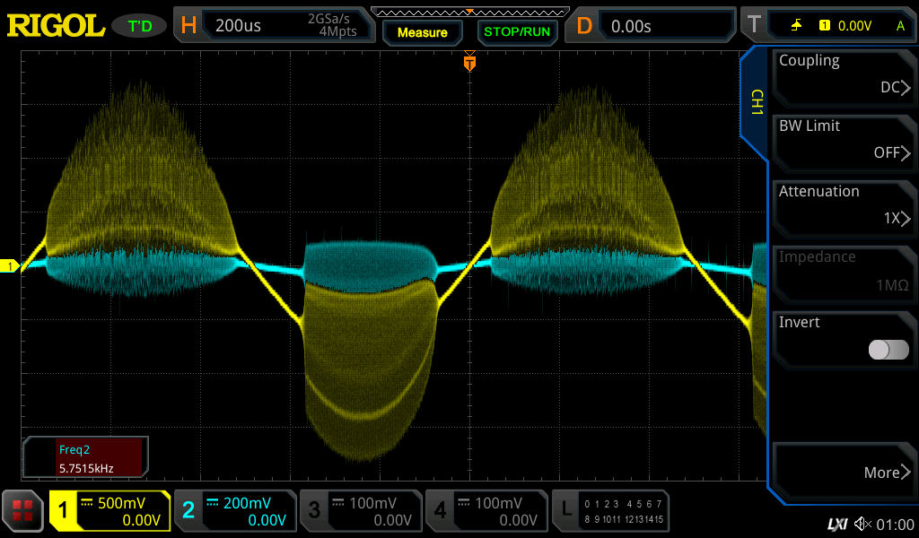

I've been following this thread since the start as I was designing and testing various lateral FET topologies at the time. As the output section of my amplifiers are very similar to the Aurum I thought it wouldn’t take much effort to change the front end and give this Aurum a listen. After connecting everything up as per the attachedd I powered both the front end and output stage with 60V rails (just for convenience). After correcting a slight DC offset I couldn’t balance the voltage between the collectors of V132 and V137 without reducing the VAS bias (R112) considerably (down to 600 Ohm). Once the voltage between the collectors was zero any increased output stage bias would cause the amplifier to go into 8 - 12 MHz oscillations with around 500mV to 1V on the output. So I’m currently sanity checking my test rig and I’ll report back when hopefully I find a silly error. During this check I did notice that your bootstrap capacitor C142 has the positive polarity connected to the negative VAS rail.

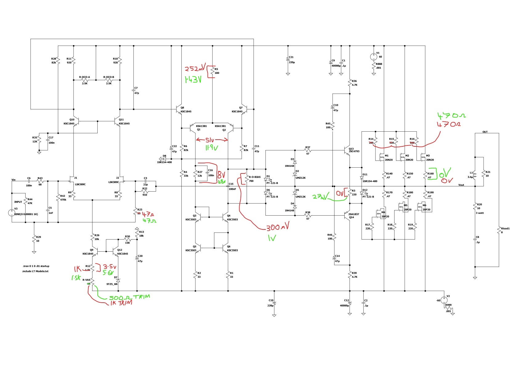

Gate capacitance for N and P Exicon fets are not identical, so one of the reasons for oscillation could be the fact that gate stoppers for N and P fets are identical.
Usually N device has lower capacitance than P device, so some designers ADD extra cap on N device to make them equal.
Example: Rod Elliot's P101.
If capacitances are not equal - that may cause oscillations.
Another way of dealing with this issue, is by using DIFFERENT gate stoppers, using formula RC = constant, where R is gate stopper resistor, and C is input capacitance of the FET. Adjust R on the both devices, so RC value are equal on upper and lower FETs.
Example:
Let's say the 2SJ162 has a gate stopper of 100 Ohm and a gate
capacitance of 900pF, the RC time constant is just RgatexCgate=RC time constant,
so 100x900x10^-12=90nS. If we want 'balance' we need a resistance on the gate of
the 2SK1058 that gives the same time constant.
So, Rgate x 600pF = 90nS, solve for Rgate. In this case Rgate needs to be 150 Ohm.
For Exicon double die devices I was using upper Rg=470 Ohm, and lower Rg = 220 Ohm in similar OSes.
Not saying that this will fix everything, but it might be the culprit... Especially if multiple pairs are used...
Brief update -

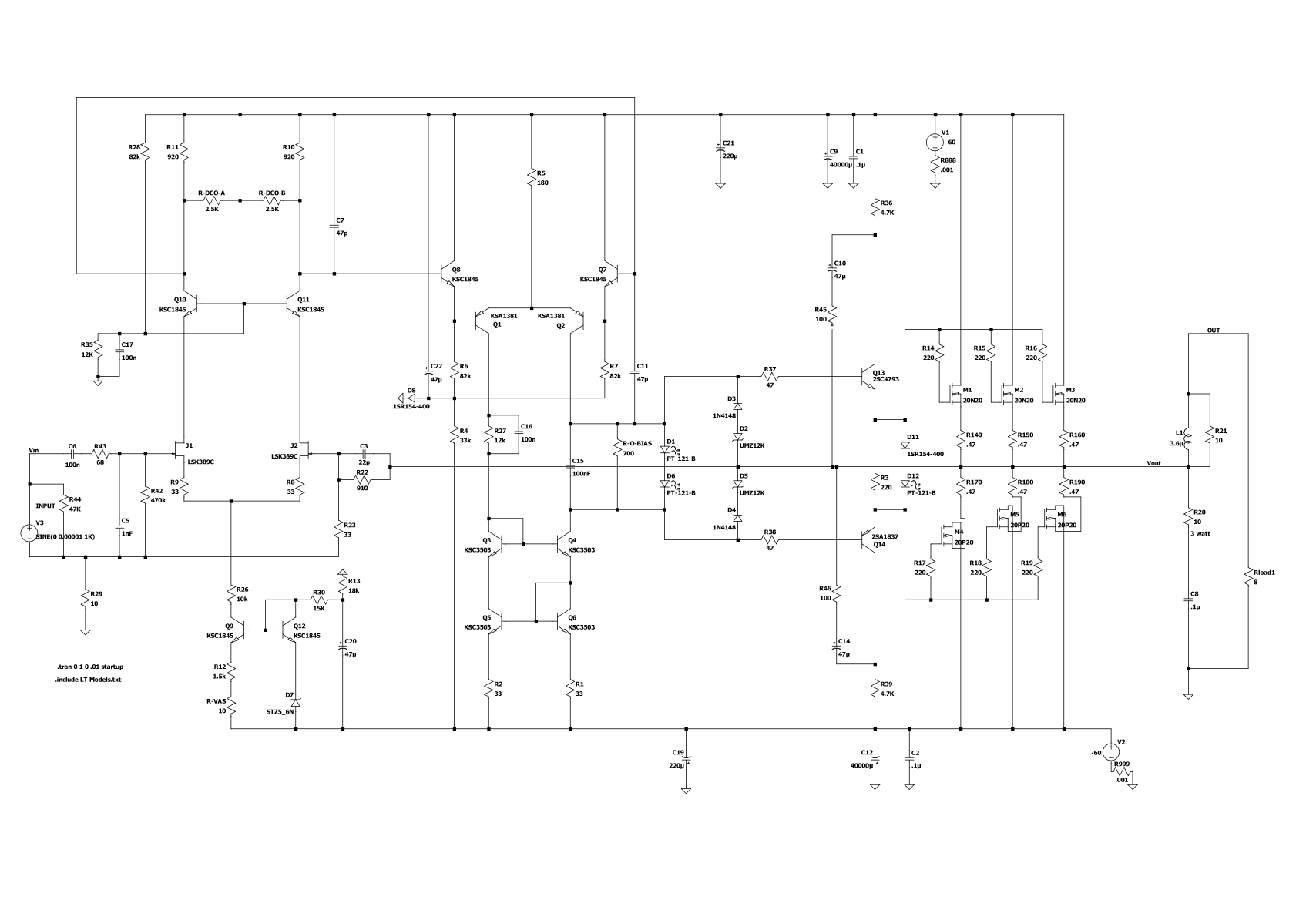

Thanks Minek, i revised the gate resistors to match RC constants (I’ve never had issues with this in the past but thanks for pointing this out) it has improved stability but it still oscillates when the OPS bias is ramped up (just not as severe as it was previously).
I'll have a play around with C11 and miller compensation caps on the drivers - I have spaces for them on the PCB for this very purpose. D.Self does use higher values in his examples.
Thanks XRK for your suggestion - I tried 47pF but no difference to the oscillation.

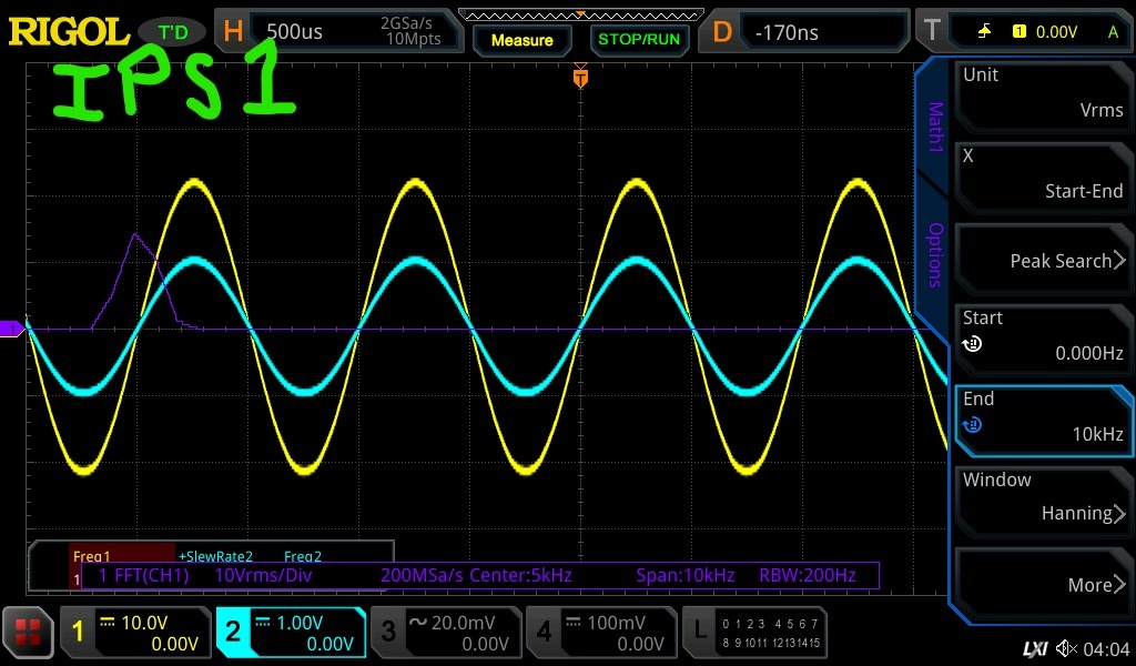

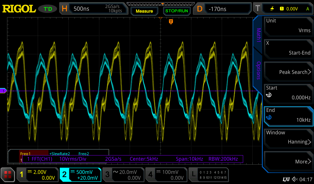

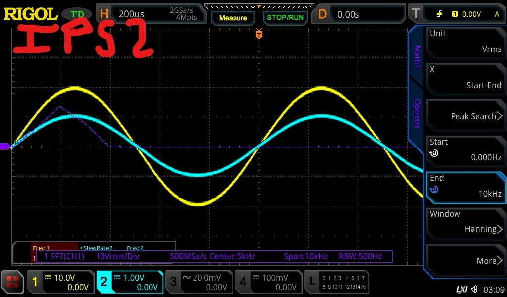

I have two input stage boards to make trouble shooting easier. Both amplify the input signal well but I just cannot up the OPS bias or it instantly oscillates. See attached two screenshots from oscilloscope of each IPS amplifying and another screenshot of the oscillation with 500ns wavelength.
I also done a comparison of voltages between the two IPS boards - there is another issue with IPS2 as only 252mV across R5 which should be 1.5V to 2V.
I’ve had enough for tonight but I’ll pick it up again tomorrow evening.
Cheers
Dom
