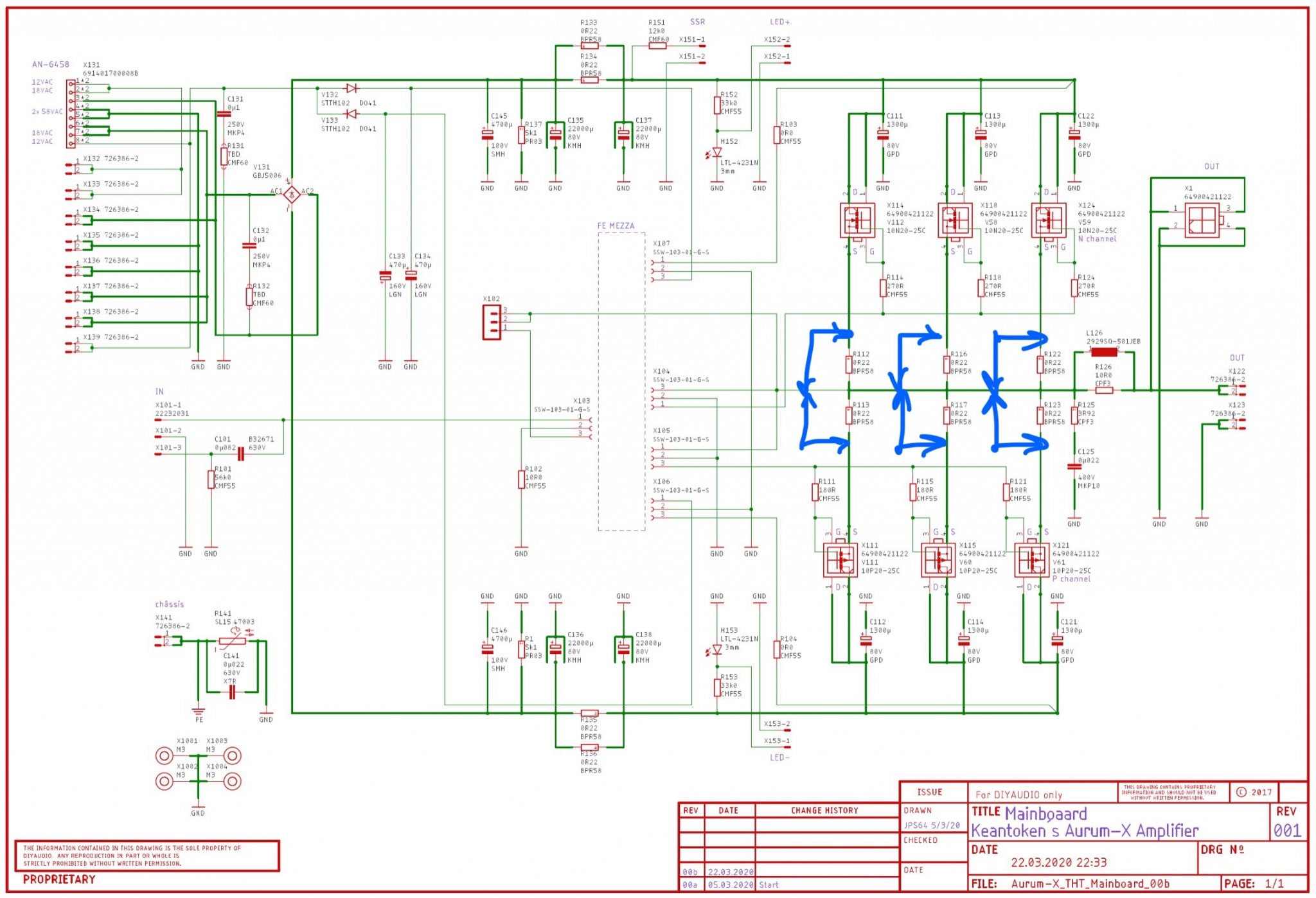

no sound at all had the line in at 50% volume and the bias resistance to 0 ohm

If you have trimmed R134 to be a low as it will go, then turn it on and adjust bias for 18mV across the source resistors as XRK showed in post #359.
It would also be interesting to check the variation of the source resistor voltages as that tells us about the variation in MOSFET gate voltage.
I take it the amp still works at this point?

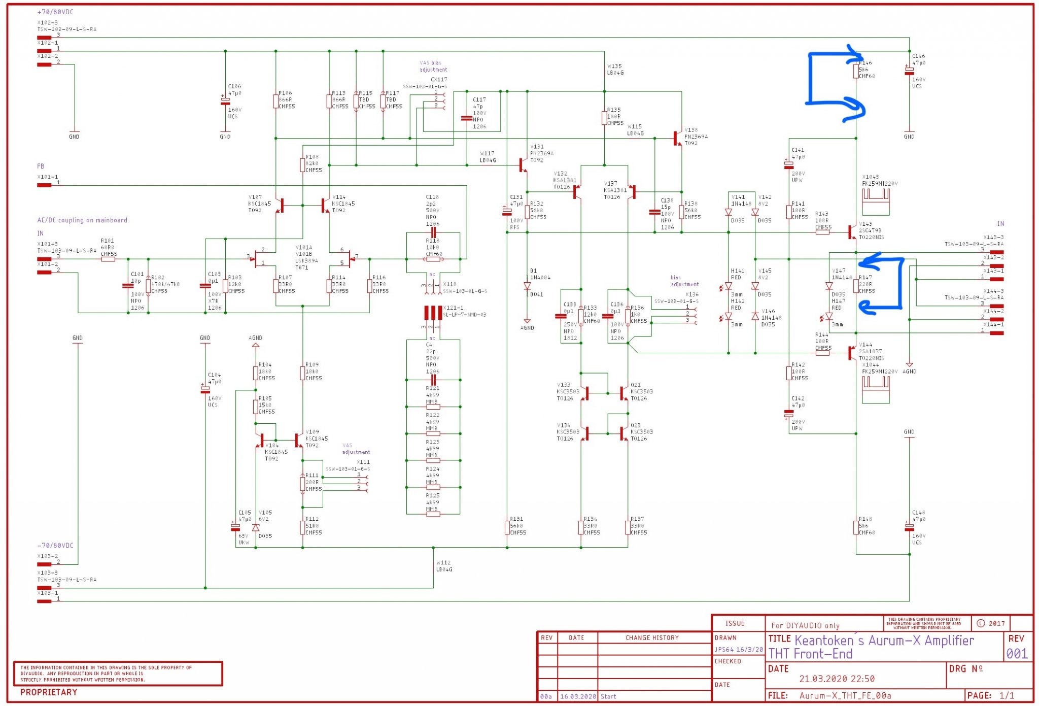

Hmm, it looks like we neglected the VAS current trimmer. This needs to be set before the bias is set. If there is no obvious malfunction then do this:
With the output bias all the way down, adjust the VAS trimmer until the collector of V132 is at 0V to ground.
Then raise the output stage bias to 18mV across a source resistor.
is this X117 labeled "VIAS bias adjustment" ? VAS current trimmer adjust collector of V132 is at 0V to ground.Hmm, it looks like we neglected the VAS current trimmer. This needs to be set before the bias is set. If there is no obvious malfunction then do this:
This is X136 trimmed R134 to be a low as it will go, then turn it on and adjust bias for 18mV
Is R134 a typo don't you mean 136?
What about X111 labeled "VIAS adjustment"?
OkayMeasure across the large 0.22R BPR resistors. There are 6 measurements. They should all be similar and abiut 80mA each or 18mV across these resistors:
On the Mezzanine board, measure across here:
Measure across the large 0.22R BPR resistors. There are 6 measurements. They should all be similar about 18mV across these
What about R147 and R146? What am i looking and how would i adjust?
I’ll let Keantoken respond. But I think start with the pots in the minimum position as described. Then adjust to get the correct bias current value.
Yes, I meant R136 for the bias adjustment. The VAS current adjustment is X111 and should be near V109.
CX117 is NOT the VAS bias trimmer, but the LTP offset trimmer. Do we have a better schematic?
