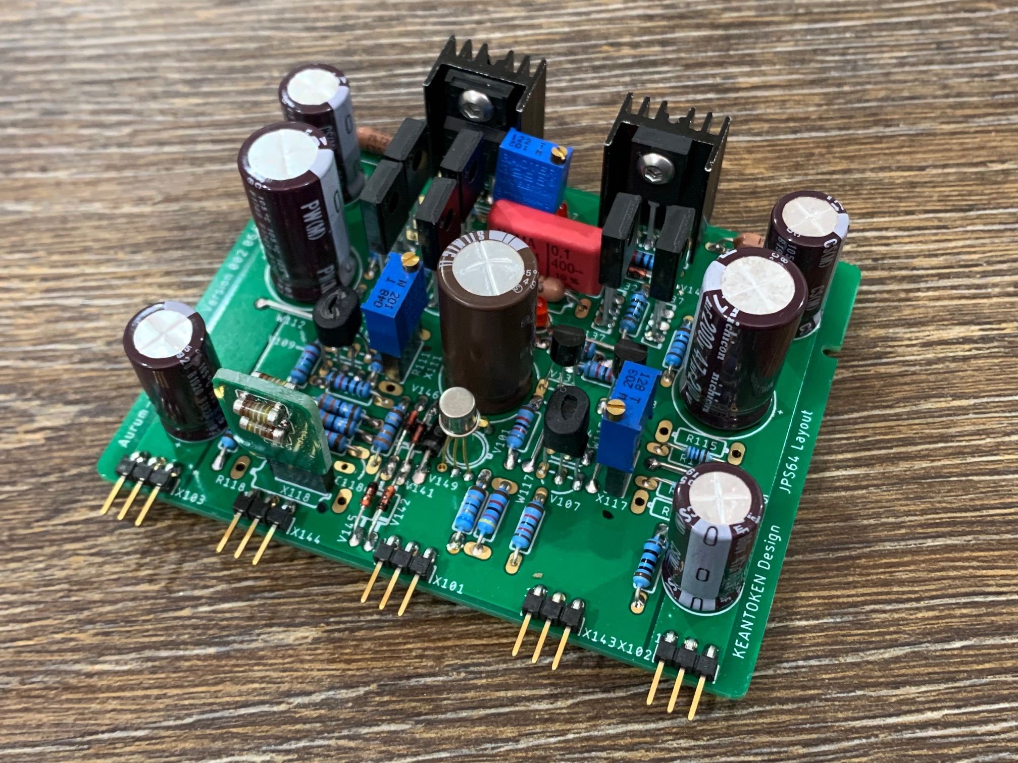

Looks to me that R118 has been left off the Build one jpg photos.
Is there a reason for this or not?
JT

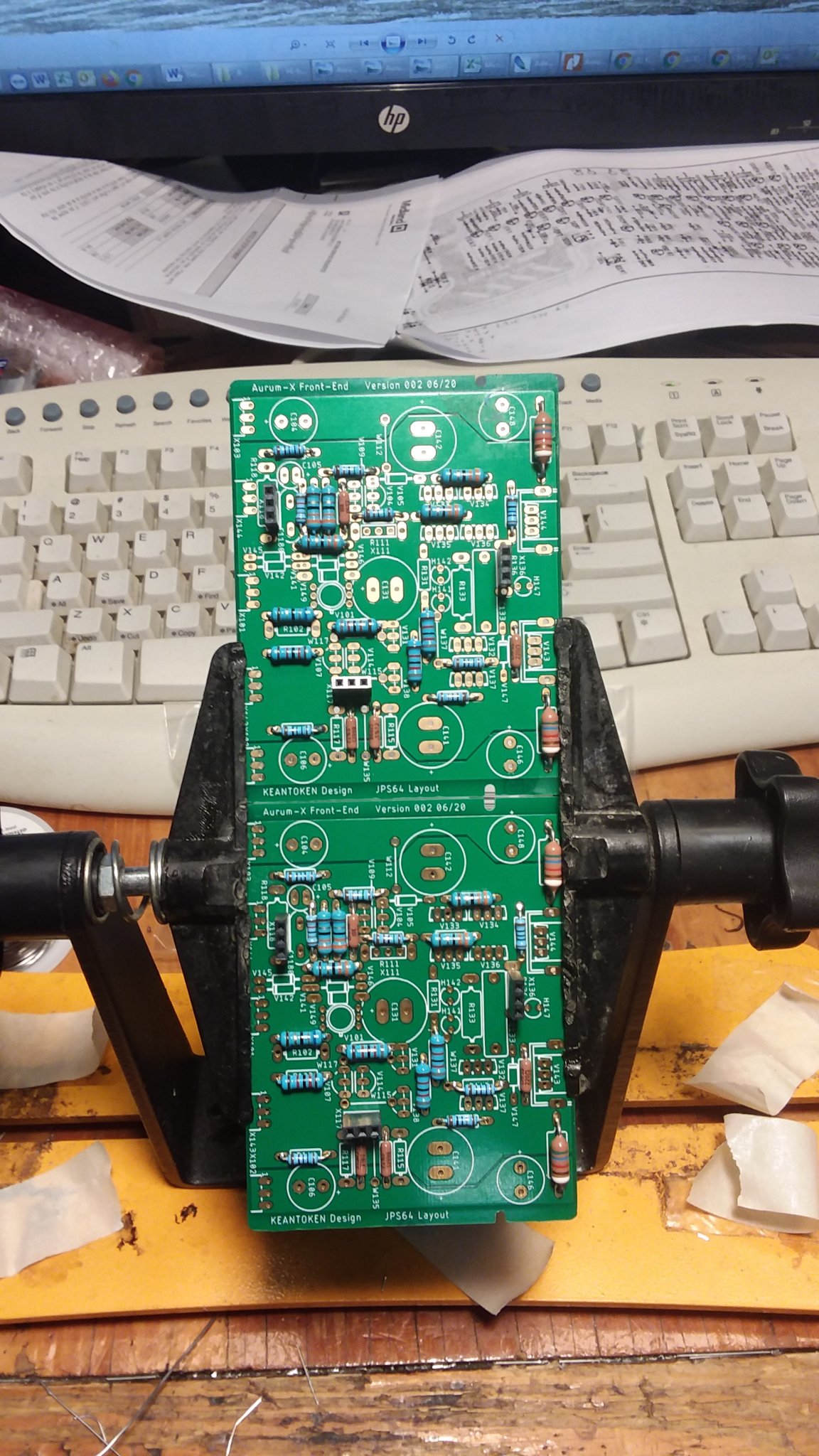

Working on the FE boards. Like to know a little more about R102 it's 470k/47K. Again, there is a call-out for R118, there is also a riser there, but it looks like the design calls for a 10k resistor in parallel with the lot.
Progress so far....

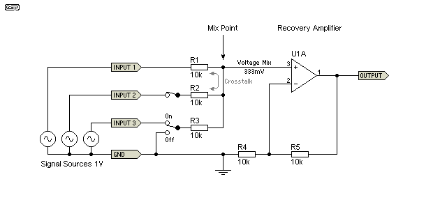

The Macgyver way is to take a couple of circa 10k resistors (value is not important as long as it’s higher than impedance that the source can drive) and connect them in a Y split. Feed each leg with left or right. Connect the middle common to the amp input. This assumes the amp input doesn’t require much current (FET input). And the AurumX is JFET input so that’s all good.
Alternatively, you can build a summing junction with high impedance opamp buffer.
ESP website shows 10k resistors and add a “recovery”’buffer at the summing point to boost the output drive.
https://sound-au.com/articles/audio-mixing.htm
