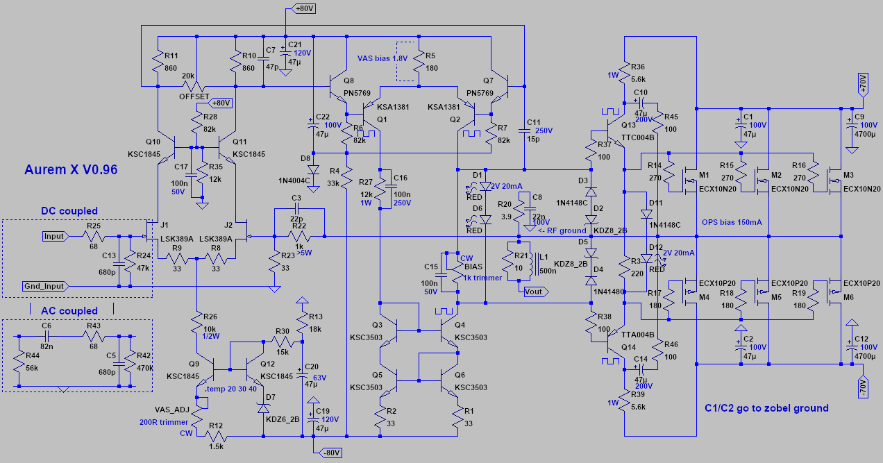

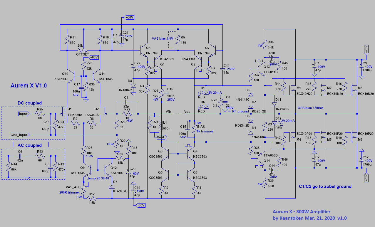

Keantoken's Aurum-X 300w Amp with LatFETs
Here is what V0.96 looks like. If there aren't major objections then the next schematic will be frozen.

Thanks Keantoken,
I can offer one more suggestion, before I depart, follow this thread and youtube videos
SW-VFA-01: Audio power amplifier video series
Put your amp design through his ltspice test bench and sim environment. Maybe even follow his design techniques. To me it is one the best threads to offer this forum in years. Following a seasoned and skilled EE show an amateur like myself the ways to a proper design methodology is rewarding for me at least. In the few videos that have been posted, so far, I would never have figured this out on my own. The design/sim techniques are basically what they do at ADI at the chip level. I just might layout these designs just for the fun of it, not like I need more amplifiers, but it is rewarding to learn from an expert.
Good Luck Rick

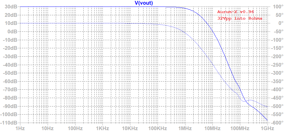

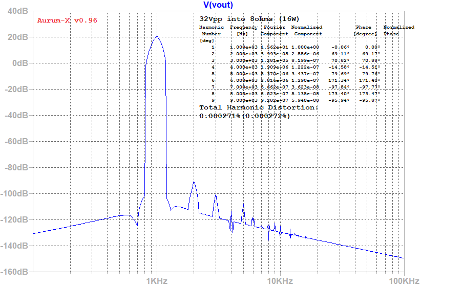

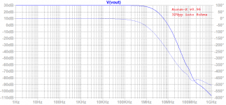

Here is the predicted FFT for 32Vpp into 8ohms (16w) - the profile looks excellent with dominant 2nd order and momotonically descending higher orders. H2 is at -110dB! Of course, in practice the value willl be higher, but the profile is at least predicted to be excellent and non-fatiguing.

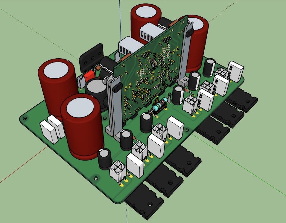

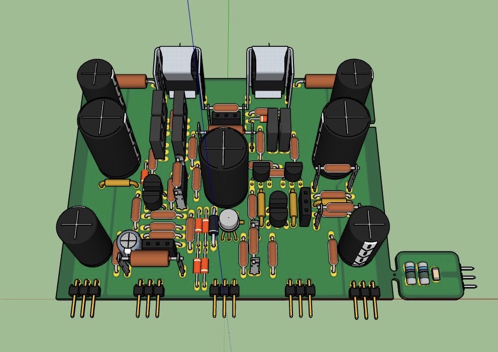

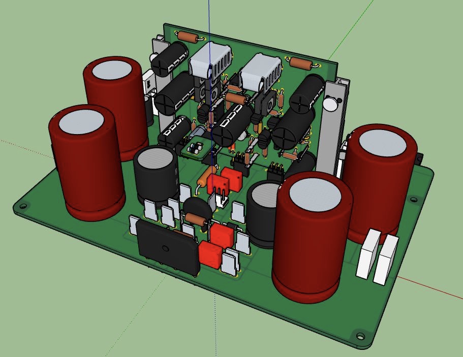

JPS64 is always amazingly fast as usual. Here is the layout so far. We may need to have an off board square puck rectifier mounted to the heatsink. Probably a 4pin maxi Molex could work. I love the custom low inductance MELF feedback resistor mini PCB on removable micro mezzanine from the mezzanine.
attachment.php
attachment.php
Guiderail is Fischer MVS-70.
attachment.php
Super job JPS64!!!
Looks very very super. Thank you!
:cheers:
Edit: JPS64 says the bridge can be mounted underhung to contact the heatsink.
Does the PCB follow DIYaudio heatsink drilling standard ?
As JPS64 pointed out, the flying leads and Molex quick connects on the main PCB permit mounting of the output MOSFETs anywhere. Including UMS spacing heatsinks from DIYA store, CPU coolers, water cooling blocks, etc.
I would mount the main PCBs on the floor of the amp with the Molex plugs facing the side wall heatsinks. As these have the PSU components it’s like mounting your regular CRC PSU boards in the middle of a chassis. The trafos can be mounted 90deg on edge towards the front of the chassis.
Or in a monoblock chassis, the board could be rotated 90 deg to have the jacks facing the back and have 3 outputs on each side of the chassis.
