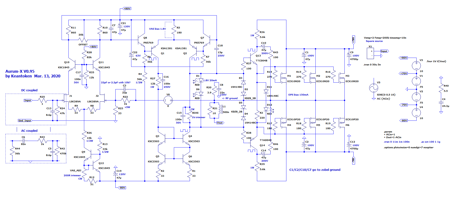

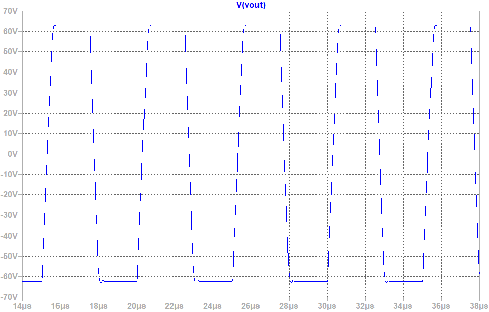

I just ran Keantoken's Aurum-X LTspice sim for a square wave and it doesn't look bad at all.

For feedback, we can use a 1k resistor and 22pF or we can use a 10k resistor with 2.2pF. I have gotten complaints in the past about using small capacitors, but I don't think there is an issue with 2.2pF in this position with any sanely routed PCB.
The reason I want to use a 10k resistor is that a 1k resistor dissipating 5W might cause issues with DC offset due to thermal problems. Unless we swear off DC coupling for this amp entirely (or design a servo), that is something we want to avoid.
We can ask JP to put a special turret mounting stud that allows 2 resistors to be mounted on top of each other and gives good air flow. Two of these in parallel or 4x4k should give good thermal dissipation. Good metal thin film, carbon thin film, or even better, bulk metal non inductive resistors work really well here.

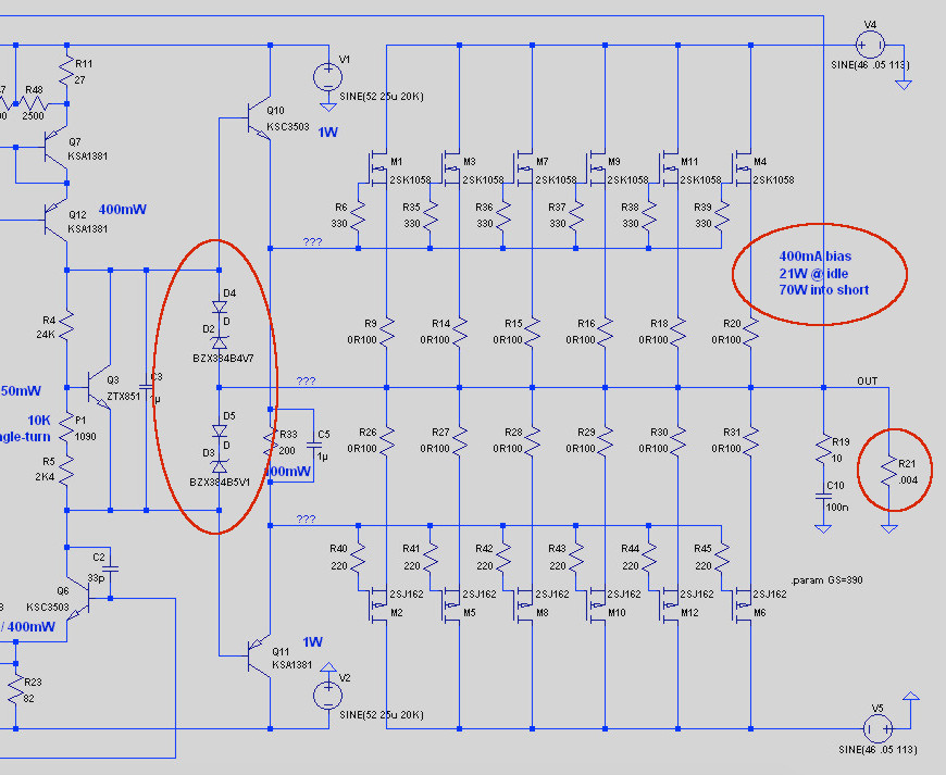

If you invert D2, D3, D4 and D5 you'll get current limiting which will protect the output stage (to some extent) in the event of a short.
Also, try putting a capacitor across R3 an re-running your square-wave response. I think you'll be pleased with the result.
I tried those things already. The protection works fine although no one gives it a chance because it looks wrong.

That's what I meant by "in case of a short". With current-limiting diodes, you should be able to survive a worst case of 0. (LTSpice won't take that, though, so I usually just use something really small, like 0.004 ohms.)
This output stage (for instance) should survive a brief short (although the heatsink is going to heat up pretty quick):

Granted, but for speaker loads what we want is continuous ratings, at least that is what I assume we want on DIYAudio. The diodes will limit peaks but won't help with continuous ratings much I don't think.
70W into a short at 46V rails means 1.52A. Does 4.7Vgs across 6x 2SK1058 really limit to 1.52A?
Edit: It looks like you mean 70W per MOSFET which means 420W.
BTW, the diodes work as I drew them and I still maintain this until someone shows me them not working. But maybe I could reduce the voltage to limit current peaks more.
