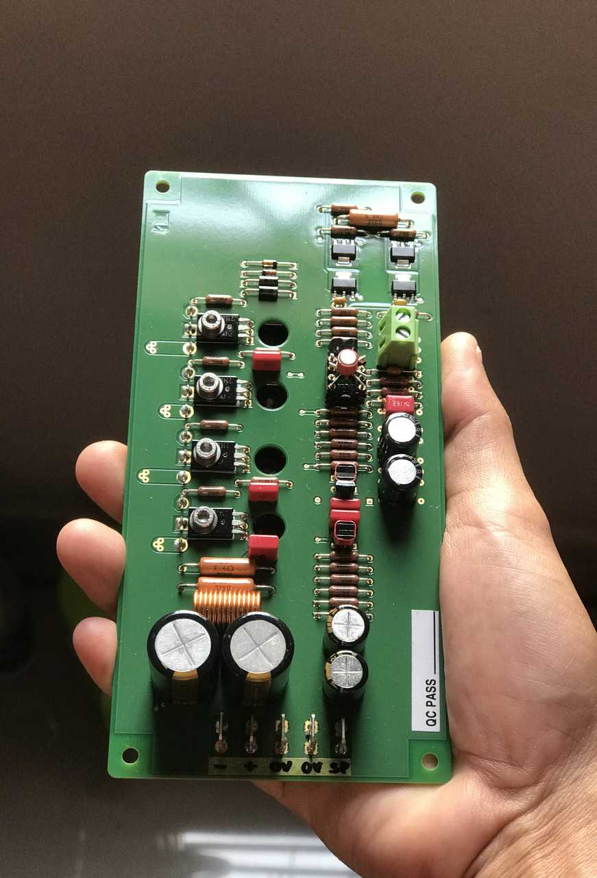

Its quite simple, just need to set temperature of solder station for fit with kinds of solder what you're using, not too hot. Result of that there is only a little bit solder on components side. This thing to ensure the current capacity of connection and highly aesthetics.

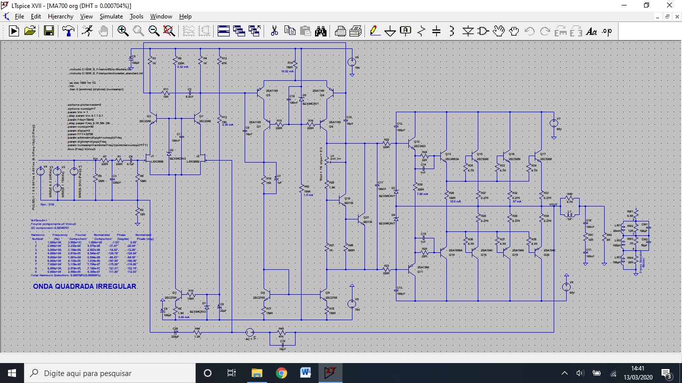

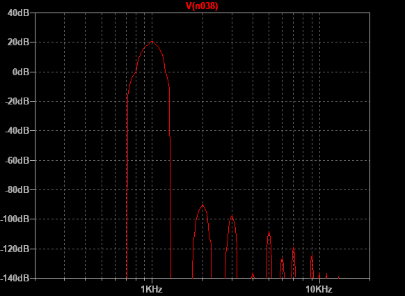

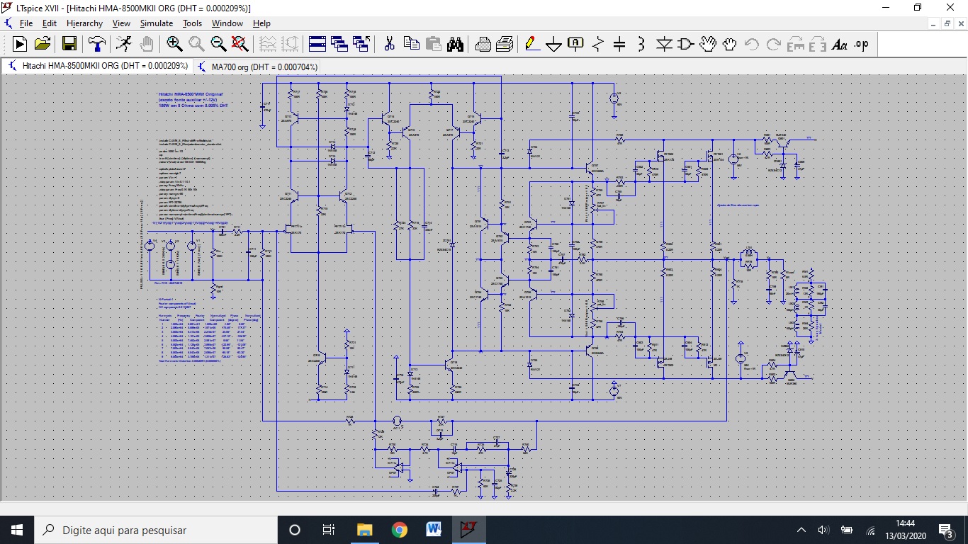

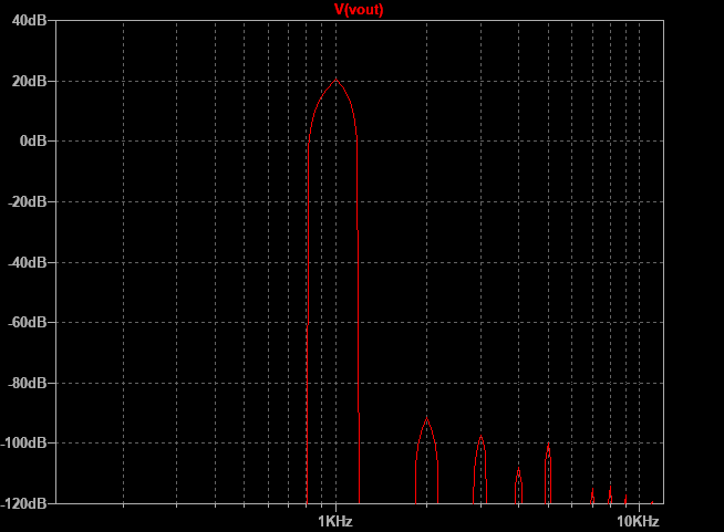

Here I add two commercial amplifier SIM examples:
Hitachi HMA-8500MKII that uses something different servo control but fail in the bias control. It is an old project.
Marantz MA-700 is a new one with a bad compensation arrangement (very high capacitors values). It has compact size, bad heatsink, and small power transformer. It is directed to HT not to quality audio.
Both have fixed first stage bias control as it will define amplifier speed and second stage currents. Note Marantz isolated second stage capacitance using cascode.
