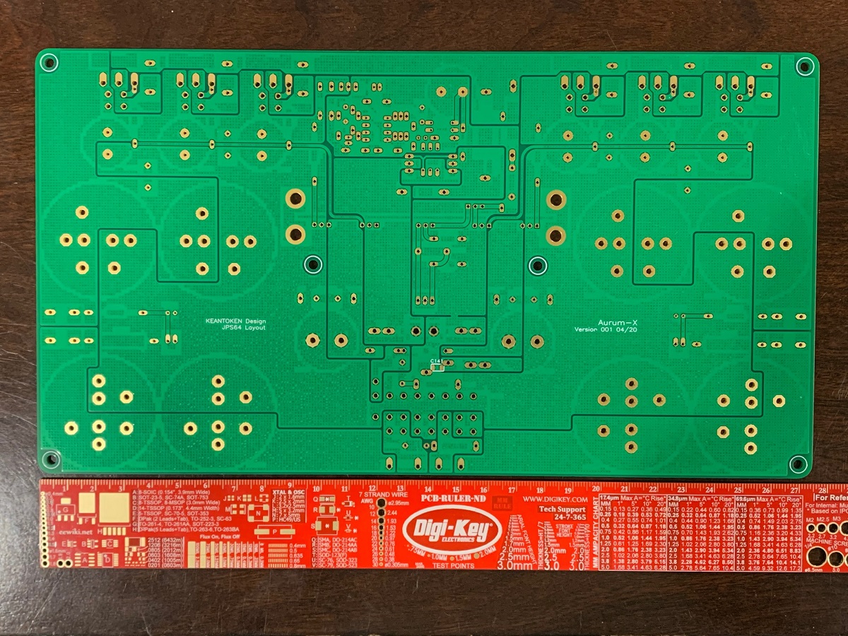

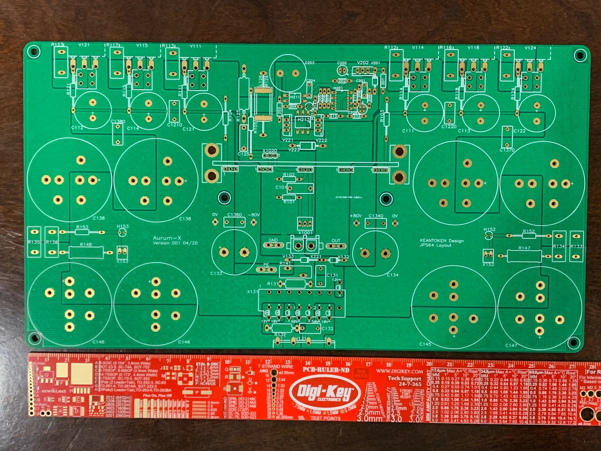

Prototype bioards are in. There is some surgery to correct for an error in the FE board that was caught until after fabrication was started. The boards are impressive though. The MB is huge and heavy 2oz copper, 2mm thick, ENIG. A stereo boardset weighs 1lb.
Thank you JPS64 for a beautful layout.
Now the hard and expensive work of assembling the verification build begins. 🙂

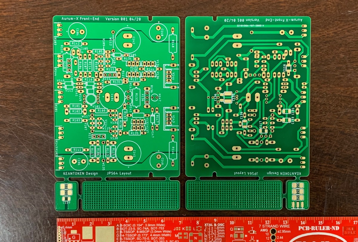

Update: I am starting to order the big ticket items. The Exicons (on private GB with friends who are also getting it for another project), also, the two Antek AN-6458’s order has been placed. Bulk PSU caps next. Then usual small parts BOM from Mouser. I ordered a revised FE board that corrects earlier error. That should be here in a few days.

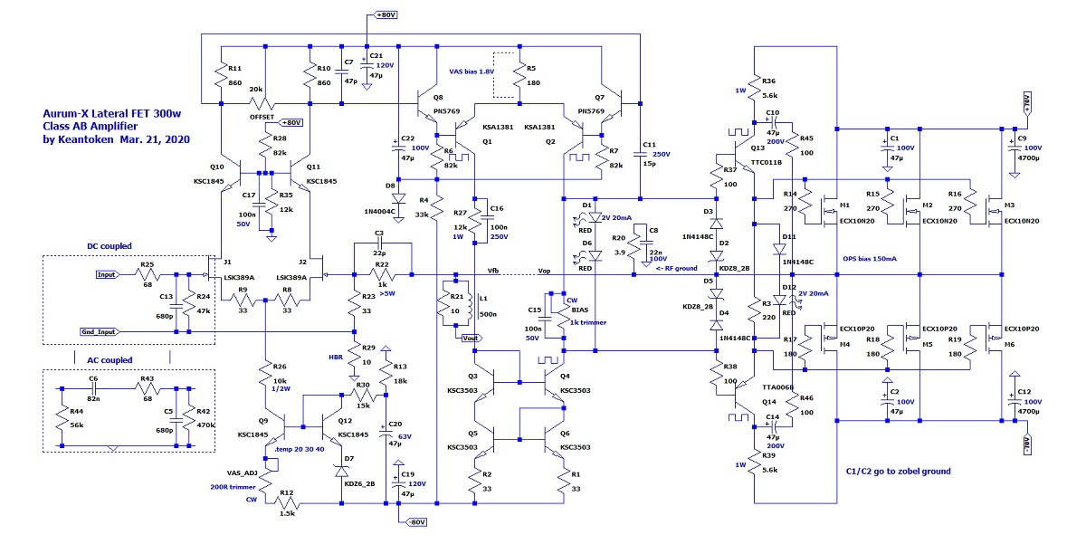

Note that there is a two pair Exicon outputs option with 63v rails 200w version of this amp. That can save a little cash and keep trafo smaller (45v), caps at lower voltage rating of 80v vs 100v, and chassis smaller as well.

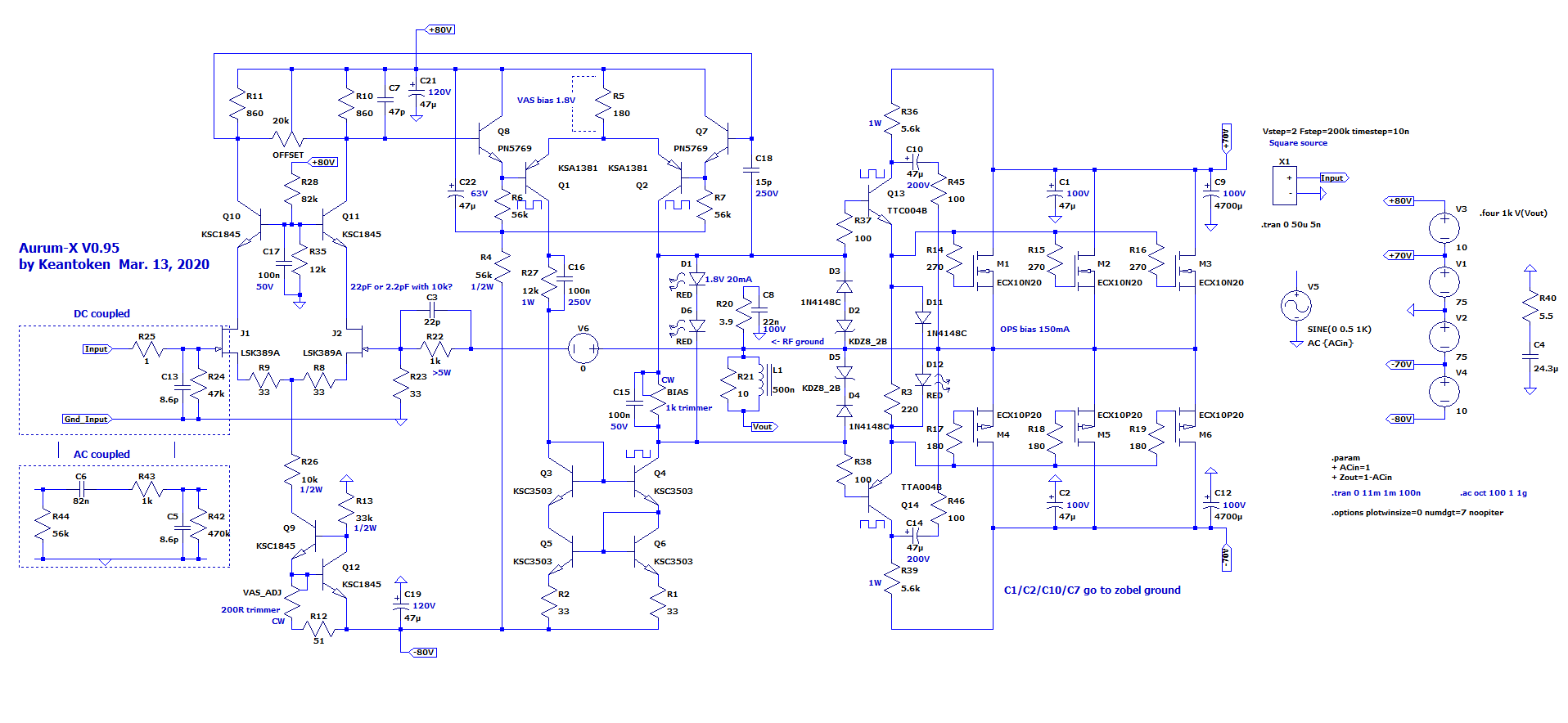

Here are the changes From Keantoken for 63v operation with two pairs of latFETs for 200w:
Here are the bias components changed for 63V:
80V -> 63V
R27 12k -> 10k
R36/39 5.6k -> 4.7k
R28 82k -> 68k
R13 18k -> 15k
R30 15k -> 12k
R6/7 82k -> 68k
R4 27k

I’ve got the FE board parts list completed.

Sorry, that list is incomplete (my fault) and you put the wrong schematic with it.
80V -> 63V
R4 33k -> 27k
R6/7 82k -> 68k
R13 18k -> 15k
R26 10k -> 8.2k
R27 12k -> 10k
R28 82k -> 68k
R30 15k -> 12k
R36/39 5.6k -> 4.7k
80V -> 63V
R4 33k -> 27k
R6/7 82k -> 68k
R13 18k -> 15k
R26 10k -> 8.2k
R27 12k -> 10k
R28 82k -> 68k
R30 15k -> 12k
R36/39 5.6k -> 4.7k
