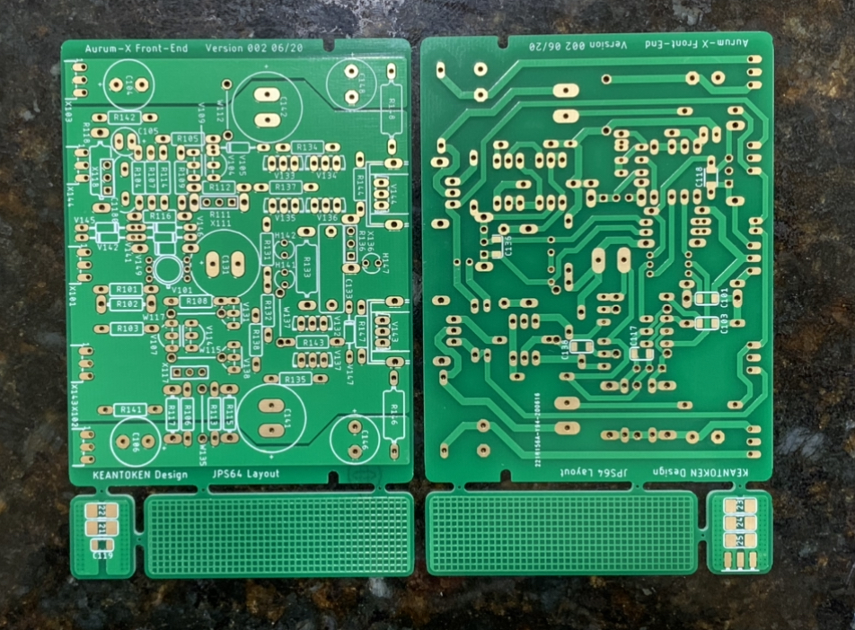

Speaking of FE’s - the revised v002 FE PCBs just arrived today. These have the layout connection error fixed.

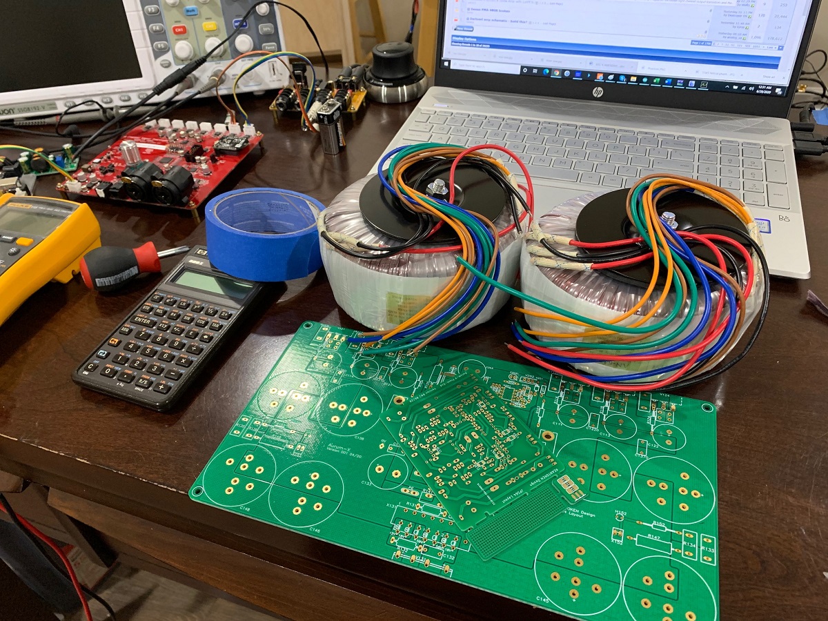

My two 600VA Antek AN-6458 trafos just arrived today. That’s a lot of iron/copper. Heaveee!

The trafo's are here. One never fully appreciates the sheer size and weight of a 600VA trafo. This is AN-6458.

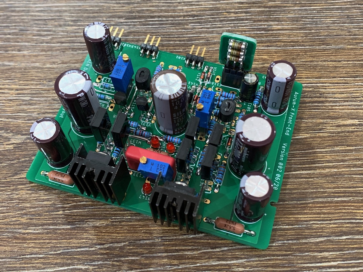

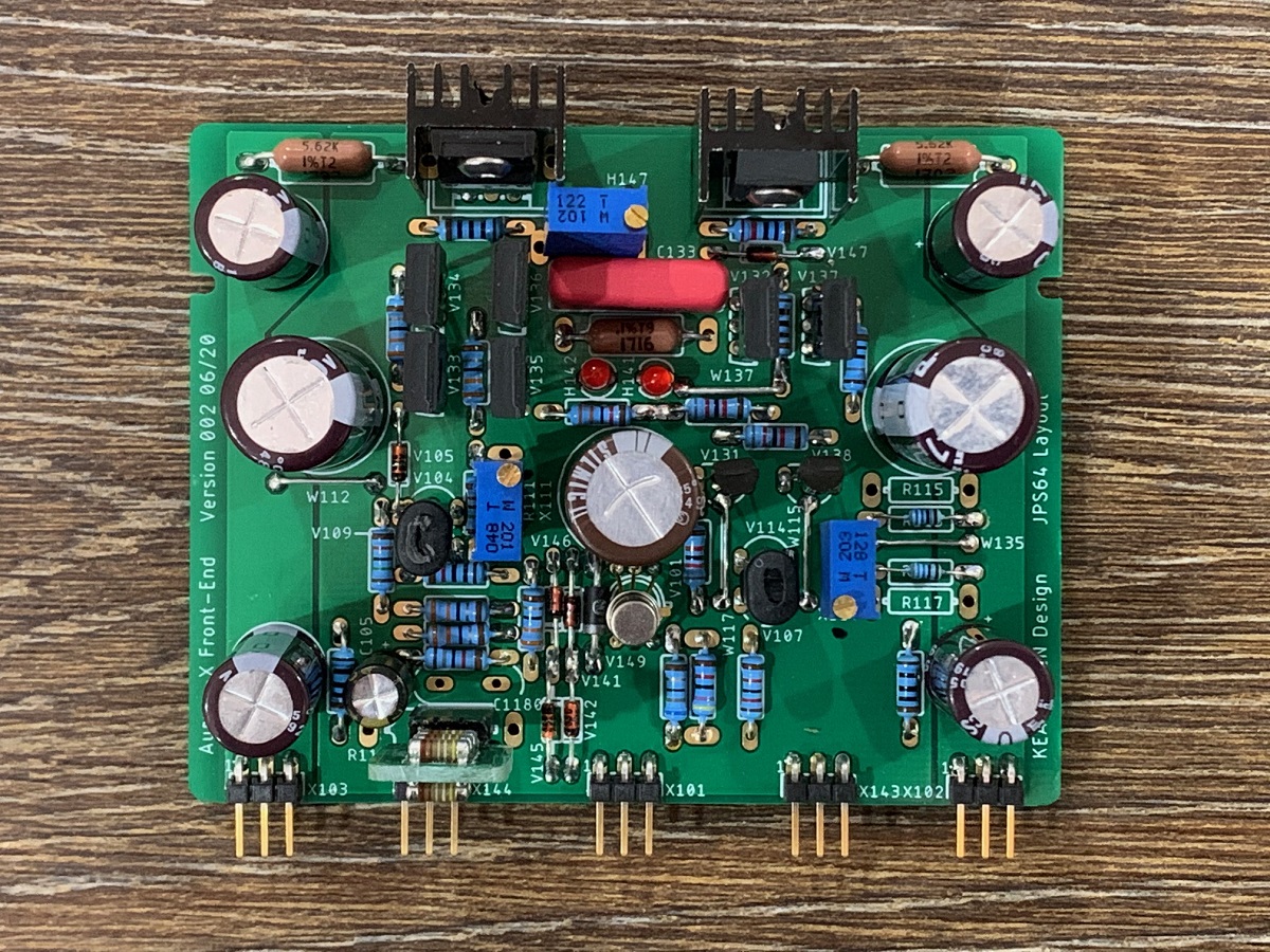

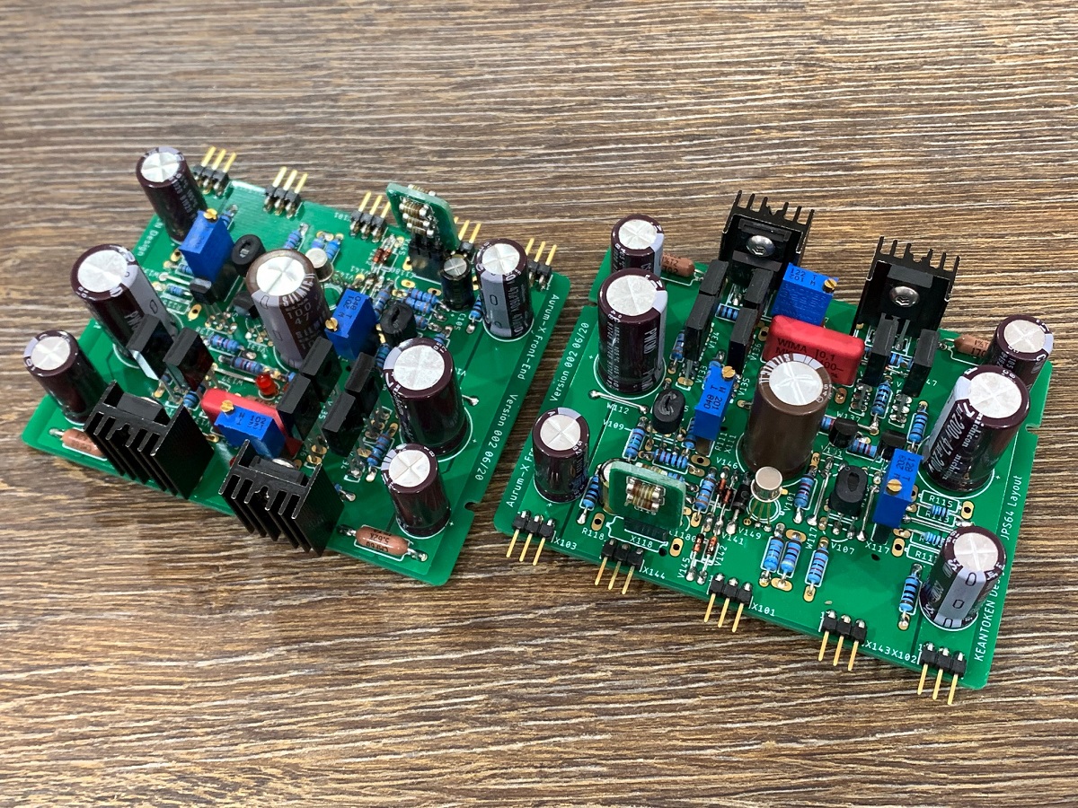

I made some progress in October assembling the FE boards but my work has gotten so busy the project has stalled.
Here are the assembled FE boards:
