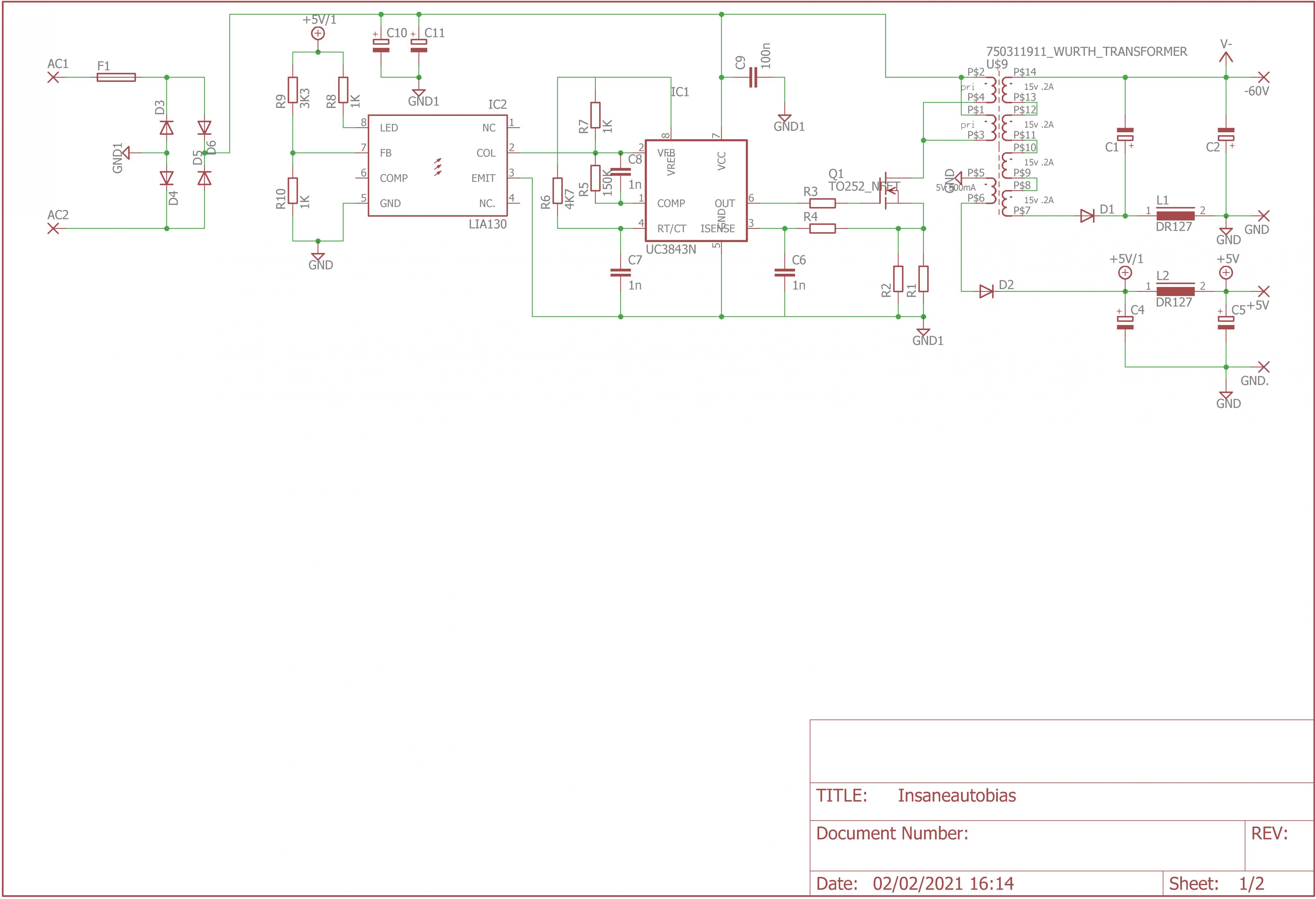

I have a design for that, im currently trying to roll my own switcher.
Wurth electronic https://nl.mouser.com/datasheet/2/445/750311911-1723887.pdf
Also the second one has a separate 18VAC output you could use a multiplier from (or to boost or buck the main B+)

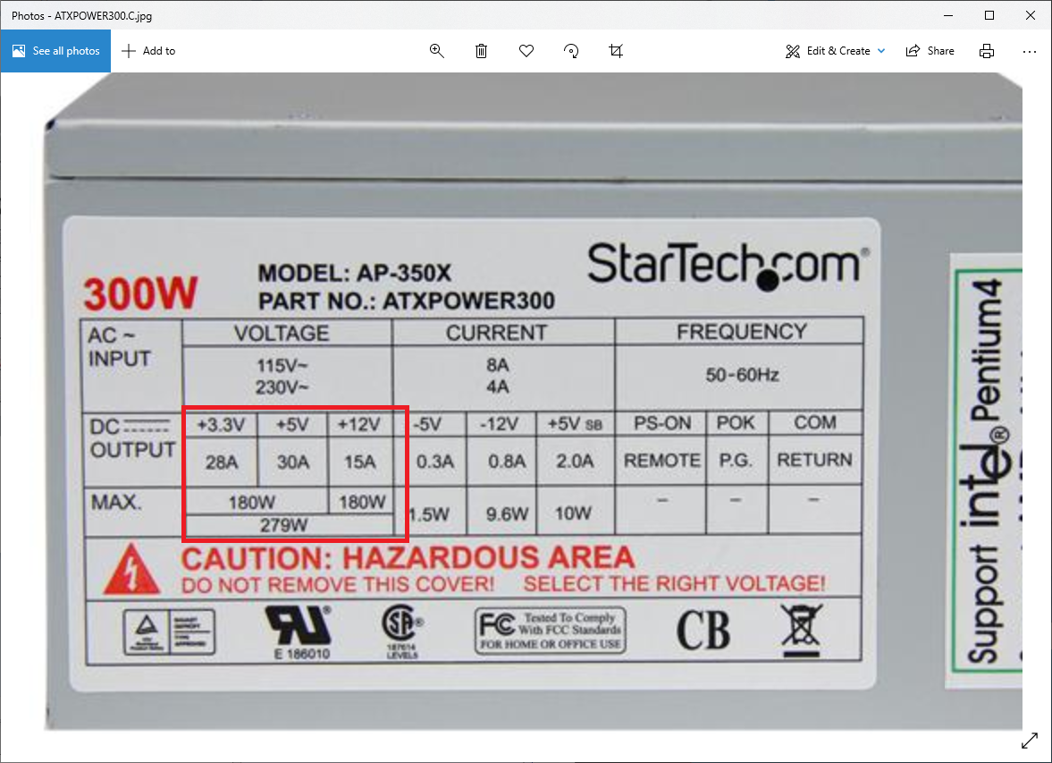

When you use PC PS, which connectors use to feed 12v? Since I saw your images hook up more than 1 yellow wires. How much current need for the board at 12v? I am not sure if every PS connector has the same current.
Generally, all the yellow wires are in parallel. Most of the time the PS has #18 wire. You need to calculate the current carrying of the wires vs the load you have, but generally the more, the better.
In theory, you can try and claim 15A from only wire, if it's short enough...
As far as max current for the inverter board, which one are you using?
FWIW, using the 12V - 280V module, I can supply it with a 3A regulator to run phono, line, and buffer stages. For most anything but a power amplifier, you can use 1 or 2 wires...
I have read every single page to get all the idea except the current from PC PS. I think I got almost all the discussion in here. 🙂 Your reply is very helpful.
150W DC 12V-24V: 3A
500W DC 12V-24V: 5A would be enough for 400v/500mA DC?
150W DC 12V-24V: 3A
400W*.500mA=200W. 500W should be enough to power it. I derate every rating on cheap stuff to 40%, so you're right on the dot. A 200$ ATX will actually put out it's nameplate rating at 50°C... Most of the stuff I used in those builds didn't. Still, getting 80W out of a 200W supply is still good when it only cost 30$.
I have access to a lot of PC ATX PS from 350w-750w. I hate to throw away these things so I will save some for the projects 🙂 I have searched about this on google for a while back but didn't catch on your thread until today. I will order a few to try to see what happen. Thank you so much.
