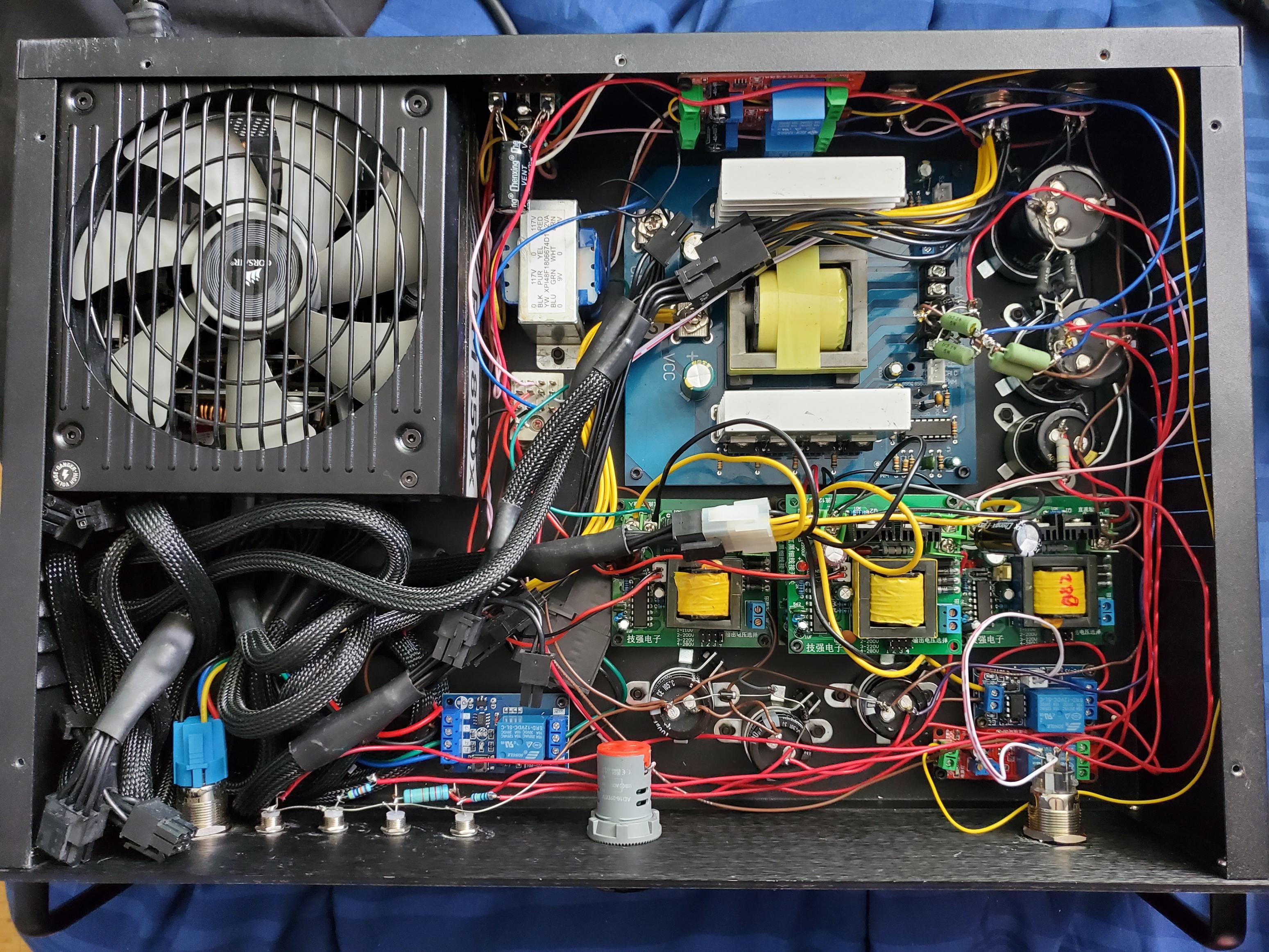

I'm curious why you use the ATX and booster instead of an adjustable supply like this:
DC 12V 3A 5A 10A 20A 25A 30A Regulated Transformer Power Supply For LED Light US | eBay
They have adjustable output and I'm guessing they will go to 13.5V.

I've used them before, but the price and quality of an ATX is better. I no longer use the booster... I just run the heaters undervolt now.
My problem with the ATX is I don't want a fan. The ATX supplies I've used keep the fan on at all times. The other supplies up to about 250W are available without fan.
A good ATX will run without a fan for much of it's load. Look for 70 plus platinum and titanium. Even some of the gold ones will run with no fan up to a few hundred watts...
Seasonic makes a 600W PS with no fan.

Yesterday, using the 160V winding into a doubler, and using an ATX supply that can sag, I was getting 277V out. Today I configured it to boost by 18V and I now have 313V just like I should.
For every 1V difference in input voltage, the output of 380V (full winding) changes by ~32V
In addition to the 160 220 and 380 volt outputs it comes with, you also get 142 172 202 238 362 and 398 volts, too (depending on if you boost or buck) and that doesn't count using a doubler.

1. The module has current limit circuit, so we can connect huge capacitor. I connected 27000uF 250V, and it took 2 min to fill it out.
2. I use CLC (80uf + 8mH + 80uf), and the ripple is 0.3V 22.2K @220V. Increasing capacitor has little effect. I don't think it will audible in my project, but any suggestion to make it lower?

I use a bridge of HER308. The diodes need to be fast, otherwise they will heat up, fail shorted, and if the 12V supply has enough current, you WILL blow the FETs on the DC module.
Not sure why your supply would sag heavily unless something is wrong with the DC board since your load is only about 20W.
I had a module with a bad FET last week. The PSU went to 2V under load. If I had used a car battery, the FET would have exploded.

I had one of those running from a computer power supply. The output was rectified with 4 X UF4007's and filtered with a 100 uF ASC motor run cap. Somewhere around 100 watts of resistive load I started to smell something funny. Before I could figure out what it was, a cloud of smoke occurred. The "600 watt" PC supply fed the little board enough juice to lay waste to one of the fets, the input cap, and probably the transformer since it is now discolored. The UF4007's were not bad.
I got some "no name" Chinese 12 volt 30 amp SMPS supplies and some Meanwell 15 volt 200 watts supplies surplus. The Meanwells are much larger than the 360 watt no name. That's why I call this a smoke test. These power supplies tend to shut off when overloaded. The PC supply did not, since 40 or 50 amps was not too far above normal in a modern PC.

I have a few like the one you just bought, although I get the one with the heatsink included since the FETS are mounted with the screw facing the transformer.
The second one you listed is similar to the ones I use, but mine have a 280V output, and output both AC and DC with a switching speed of 37 kHz instead of 20 kHz. It will power a push pull 6P15P amp without mods.
I'm using one of these for my latest integrated amp. For a 1KW amp, you might want to use 2 per channel (parallel after the bridges), and power each channel with a 1200W ATX.
1000W DC12V TO AC 0-50V-110V-220V-330V high frequency inverter variable DC TO AC | eBay
Also, they don't have short protection so if the ATX can put out the current, you'll smoke the FETs (ask me how I know - RL207 is NOT fast recovery).

Here's a picture of my latest kanged power supply. That transformer is there because I have a biasing board that needs a floating AC power source since it uses a doubler. It has dual secondaries so I'm using one for the bias module, and the other for the 12V standby voltage for the power switch board. That's why there is a lonely Chengxing cap. It doesn't need to be good in that position 😛
I'll say while it works very well, it does cost more than a linear supply. However, it makes NO ******* HUM!!! and this ATX doesn't spin the fan unless it needs to so it's also silent!
My only tube amp with an EI transformer sounds like a substation FFS. 60Hz magnetic hum from the bell ends.

When I had one that I had blown up the MOSFETs, I removed them along with the heatsink to change them all. Maybe you could remove them and mount to a heatsink, then reinstall?
It was kind of a pain in the butt, but now that it has actual IRF3205, they probably won't blow up again.
There is no regulation. If you raise or lower the input voltage, the output voltage will change proportionally.

I have the same board. This should work with DC24V, but this cap has to be changed. Onboard chip max is 40V.
I powered it up with Meanwell 9A 24V adjusted to 19V, and 220V tap goes 250V or so for 200mA load. It sags depends on the load. Also I can't remove 20K ripple lower than 250mV whatever I did. I tried CRC, CLC, Ferrite. Dead FET?
