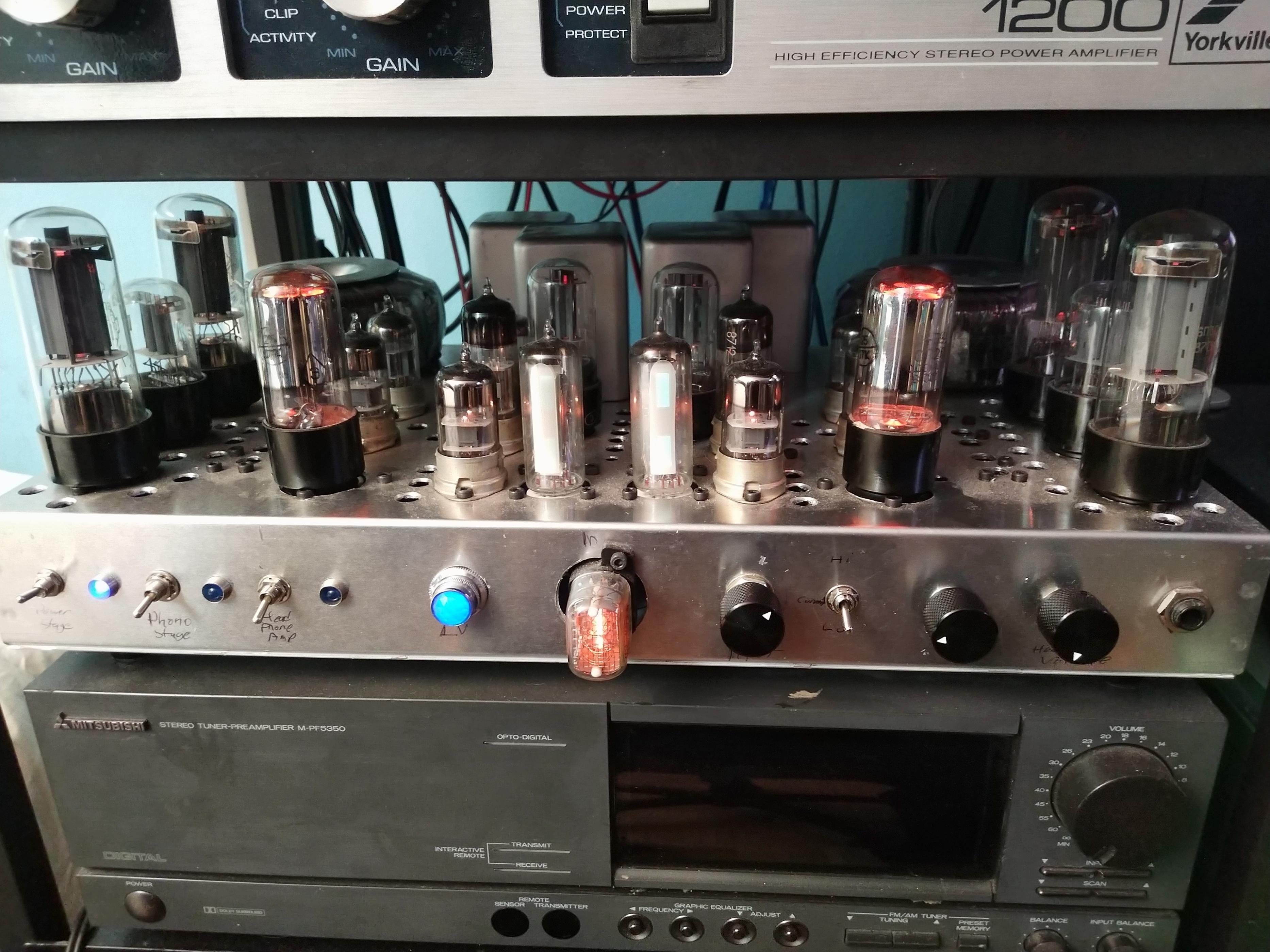

Kanged switching power supply for a tube amp.
I built this psu B+ with seperate ground dc diodes 6.3v, but I have huge humming noise.
I hope anyone can help.
More C ? Where ?
I simulate this with good almost no ripple.
Is the noise from the filament ?
Those caps value are odd, that’s what I got after measurement.
Thank you

I've recently built a small EL84 SE amp using this module and my experience has been quite good. Voltage is stable at about 80mA current draw. i had some "flapping" noise (not very loud even on high efficiency speakers) but found that re-arranging the heater wiring to keep it away from signal wire resolved this, now it's dead quiet.
