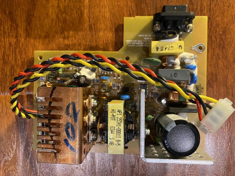

Have anyone ever thought of PS from satellite box? It should have enough to power to run this project. I have seen people give them away on Craigslist everyday I haven't checked others old home audio equipment yet but I believe they all standard design with 12v, 5v, and 3.3v.
Seem like all wires that has the same voltage connect to the same terminals so you only need to hook up 1 wire for the voltage need and whatever the current of the device need, it will draw enough to run until it runs out the current.

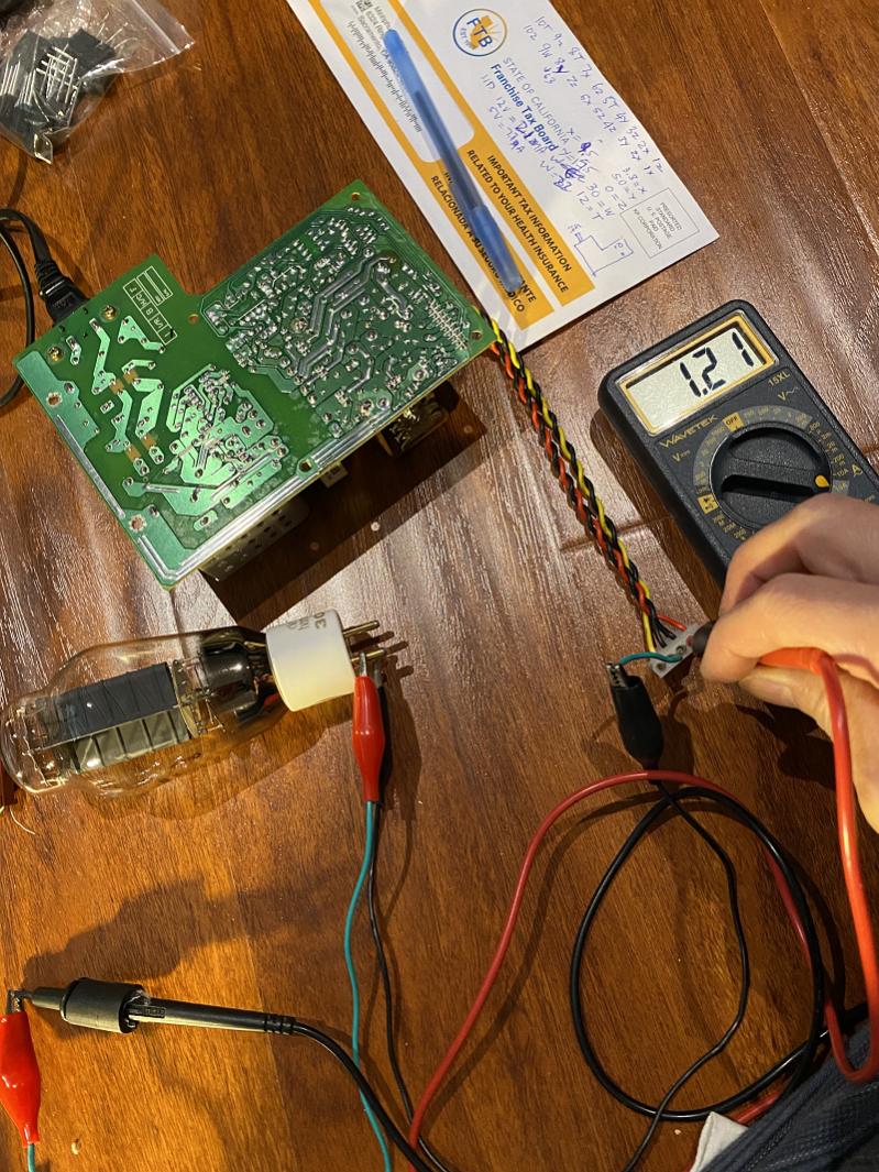

Here is my test on old satellite box PS, 12v and 5v are perfect for the tubes filament where it can run without fan. It would be great to use the satellite case as well since all the RCA and PS jack holes in the back are setup.

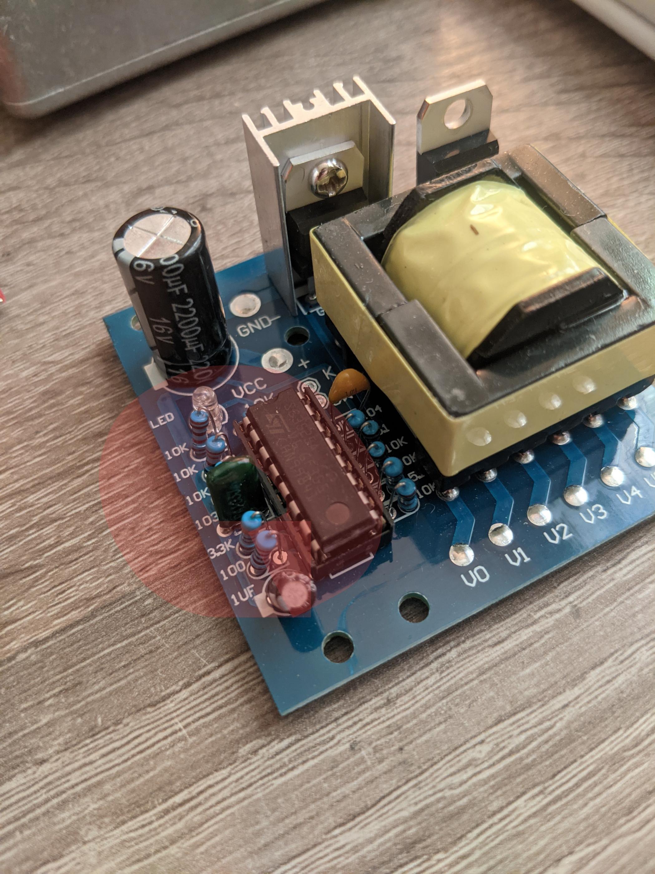

How do you keep the hum from the 150W inverter from coupling to the amplifier stage? I'm heavily filtering every section of the power supply and using ample grid stoppers as RC filters, but the faint high pitch hum of the inverte remains. Is physically isolating them in seperate chasis necesary?
I've not encountered that issue with the 150W supply. Perhaps a small common mode choke on the output would help? They are supposed to switch at 37kHz (if you got the one I think you're talking about) so you shouldn't hear it even if it was leaking through. There is an AC output version that switches at 20kHz.
If you look up how to use the SG3525 chip, you can modify the frequency if you need to.

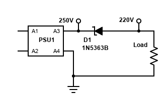

In picture 1, placing an RC snubber in resistor and capacitor silkscreen slots will help aid in preventing oscillation. The exact values will depend on the load, I ended up using 22nf and 2.2k.

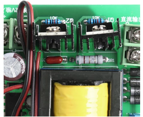

The second picture shows the greeny capacitor you can alter to change the oscillation frequency. I ended up bumping mine up to around 100k using the formula on the datasheet.
