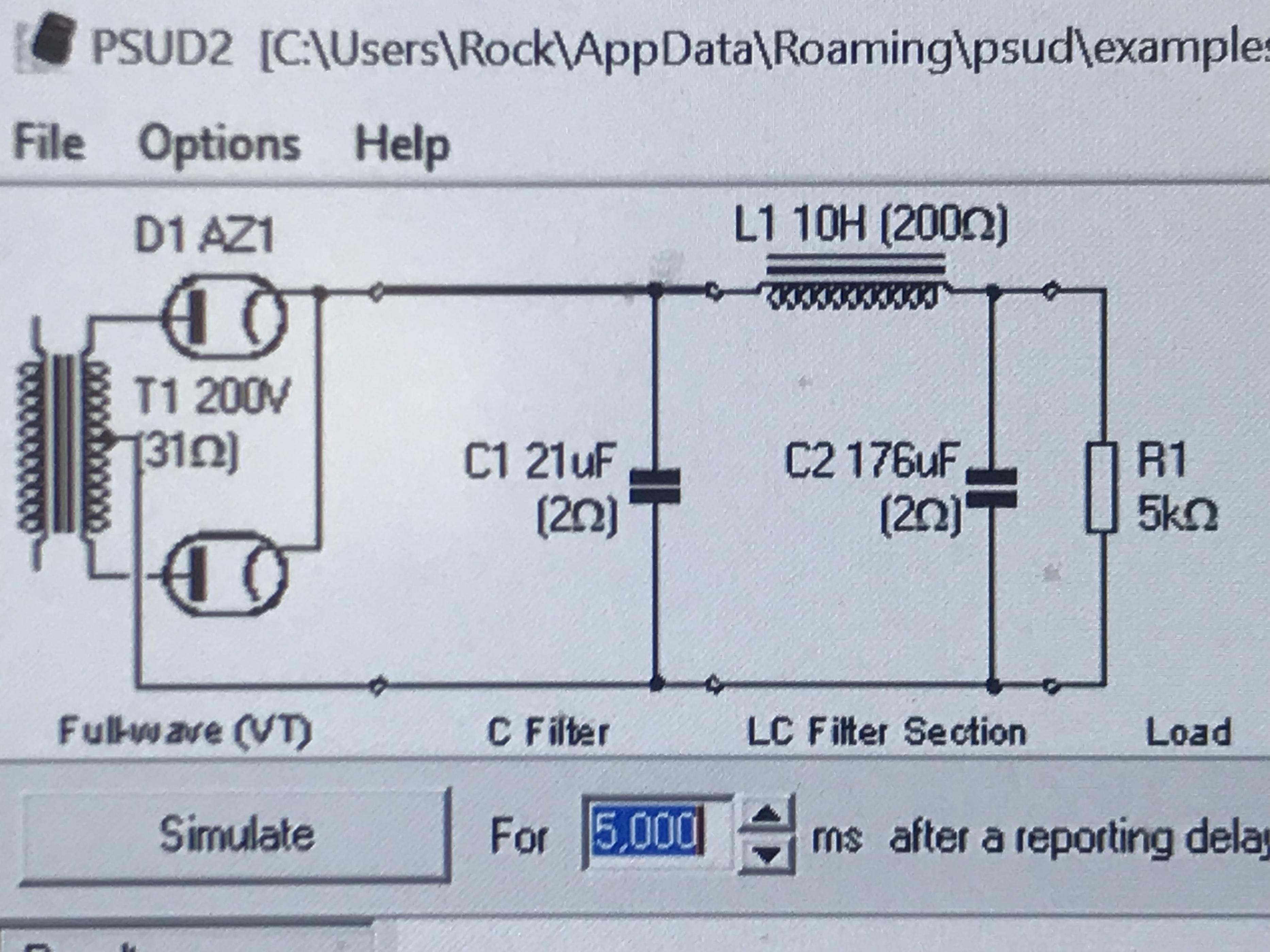

I built this psu B+ with seperate ground dc diodes 6.3v, but I have huge humming noise.
I hope anyone can help.
More C ? Where ?
I simulate this with good almost no ripple.
Is the noise from the filament ?
Those caps value are odd, that’s what I got after measurement.
Thank you

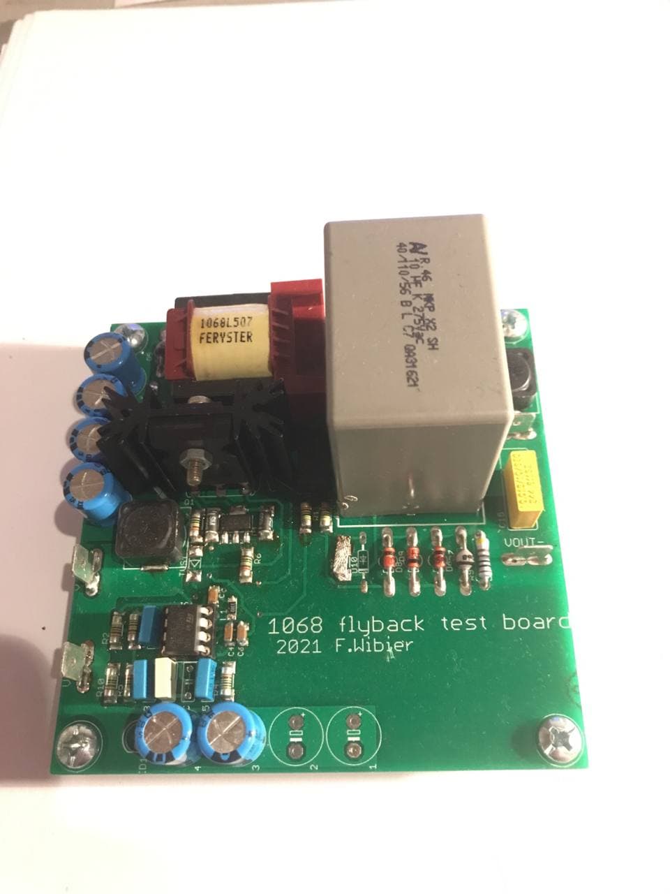

I just recently finished a prototype for a 6-12V or 12-24V to -60V 100mA flyback. For bias purposes. Ripple in the audio range is non-existent. and there is only some Megahurtz ripple that i keep out with some 1206SMD beads. Works really well actually.
And a 10-14V in Flyback to 450V 100mA for well guess the purpose. Im gonna use two cores to go from 24VDC to 450VDC 200mA next..

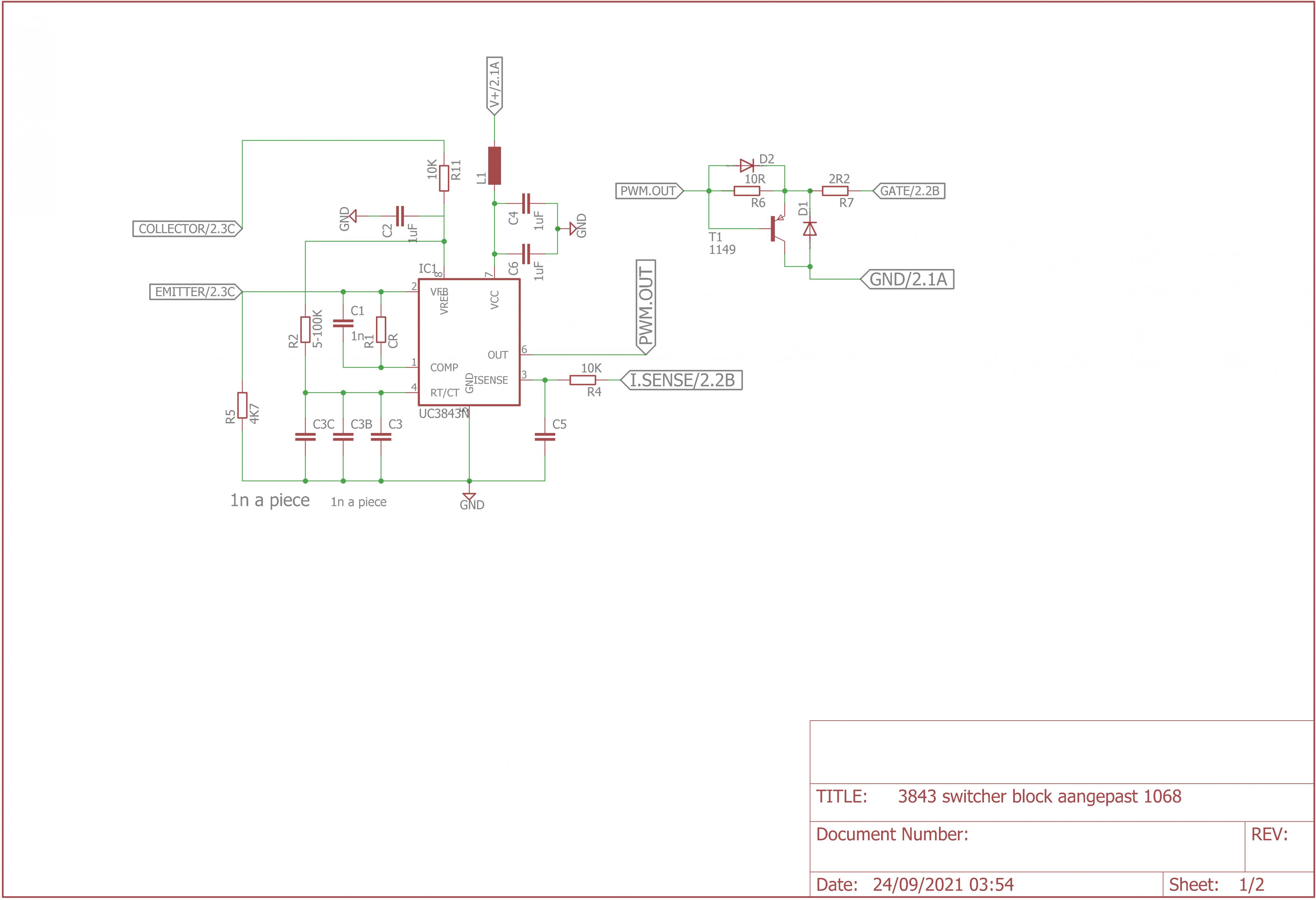

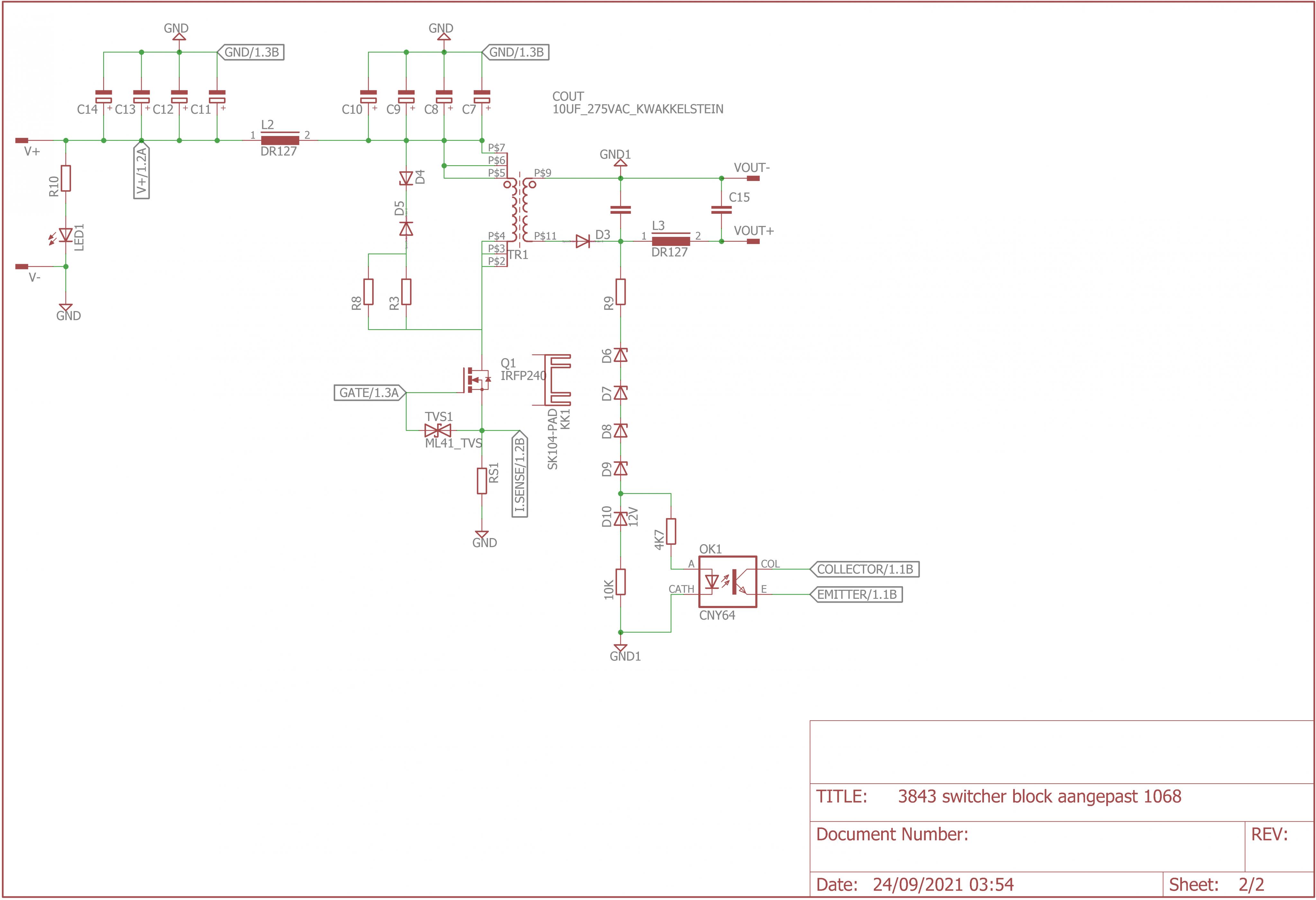

TI-EF25-1068 FERYSTER - Transformer: impulse | power supply; 45W; Works with: UC3843 | TME - Electronic components
Data from Ferryster.
Lprim 10.89 µH ±10%
Ratio 1:10
Ipeak 15.8 A
Isat >18 A
fosc 70 kHz (UC3843, DCM)
Rsc 0.075 Ω (Ipeak = 13.33 A), 0.068 Ω (14.7 A) 5 W
I use IRFP240/UC3843 for my proto nice slow fet, no need to go to LT1243 for the better fall times, just use a 6K/W cooler for the fet. Less garbage in means less garbage out on the secondary. Not that you cannot get somewhat higher efficiency, but most of your dissipation comes from the 1V current sense resistor. I used a TO220 resistor for that, but theres no reason you cannot get away with three 0.22R 2W metal oxides in parallel to get to 82 or 68mOhm
Next thing on my list is to take two of these cores, and put the primaries in series, and the secondary in parallel.
CNY64 has horrible current transfer ratio, a 4N25 will work better. But i wanted to be able to stack this supply on top of something else, into the KV range.

If you want better regulation than whit a zener stack, TL431 is the way to go.

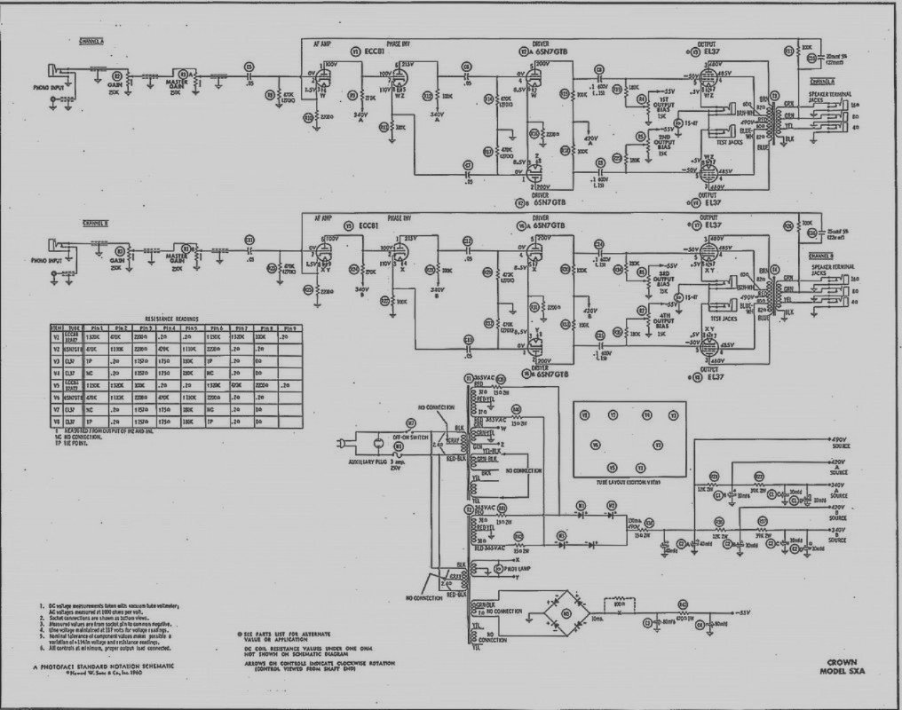

I've got a unique problem here with this Crown. From 1956!! It's a rare stereo amplifier, used for a studio monitors back then... but instead of making dual mono blocks, they combined the power output of the 2 power Transformers to get the 490 VDC... needed to power 4x EL37s the AC outputs at the individual Transformers are about 365AC... So i'm just looking to bump it up.A hundred and twenty five volts. And ideally, it would be nice to get APC b that I could have ready-made. That would give me the standard pre. Amp tube voltage of about 215 to 250... And DC heater voltage, since it's a nice hi fi Amp. 30W per side rms. I regretfully, i'm a little bit behind on some of this stuff, because this rather new... but if it can be done, which i'm sure it can, i would just like to know a little bit in advance from somebody who has a little bit more of a line on this.
