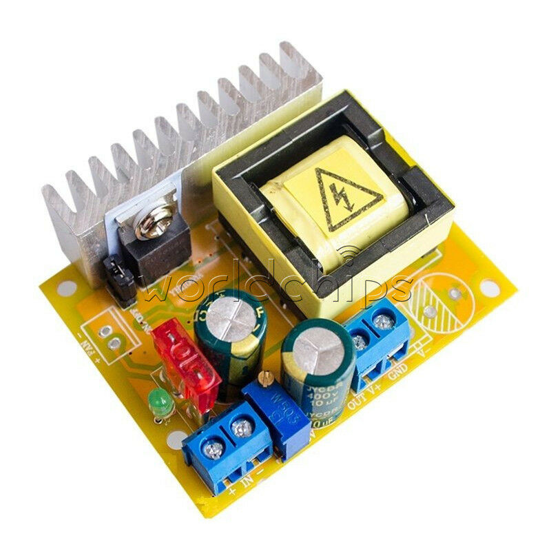

Hi, I'm trying to use a cheap DC-DC 8~32V to 45~390V step-up converter to supply a little tube amp, fed with an ATX 500W PSU. Voltage and current required are 160v/150mA. As soon as powered I noticed hiss noise at the output due to the switching frequency (I don't hear hum at all), so I wondered what kind of RC filter could do the job....can I assume a 20 KHz switching frequency for devices?
Somewhere around there... If you use a large RC filter (maybe like 220R/220uf?) or an LC filter (I use 4H/220uF) you might quench it. Personally, I gave up on that particular type of supply because it's noisy.
The one linked in post #44 would work without the noise, and you can use ohms law to figure out what resistance to use to drop 40V from the 200V you'd set it to.
Yes, I read your old post. In first instance I tried a 22R/220uF filter (I had at hand this one) and things seemed much better with only a residual hiss appearing in a channel. But I think the problem is the cheap SMPS not the best for supply tubes maybe...
This one in particular is marginal. I've used it for a phono stage with success before, but I feel 160mA@150V might be pushing it for this supply. It was struggling with 25mA@330V...

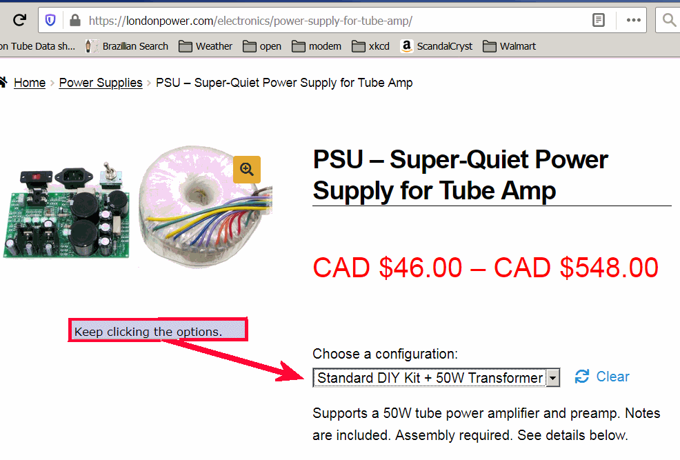

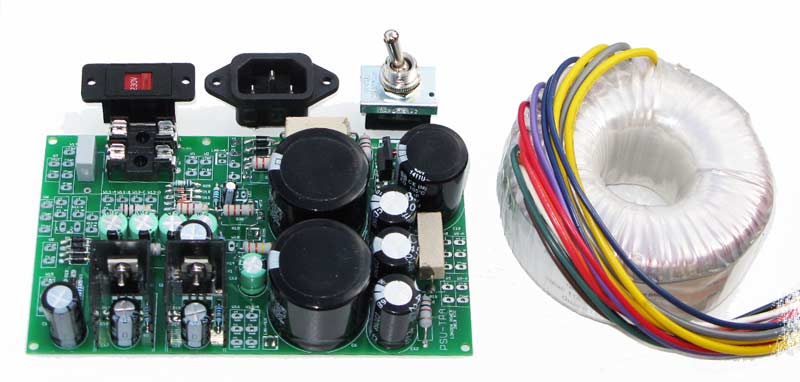

By the way, I found in your country this one:
Quiet Power Supply for Tube Amp - Tube Amp Kits by London Power
Although not so cheap, it would seemed to be SMPS...but I'm not sure.
Keep clicking the options.
It is a plain old linear supply with 50/60Hz transformer.
The transistors on fins are for Kevin's variable-voltage scheme to make big guitar amps distort at less loud level.
Yes, I realized then it by a better reading...with the TX furnished, the big caps and mosfets it could be only that.
