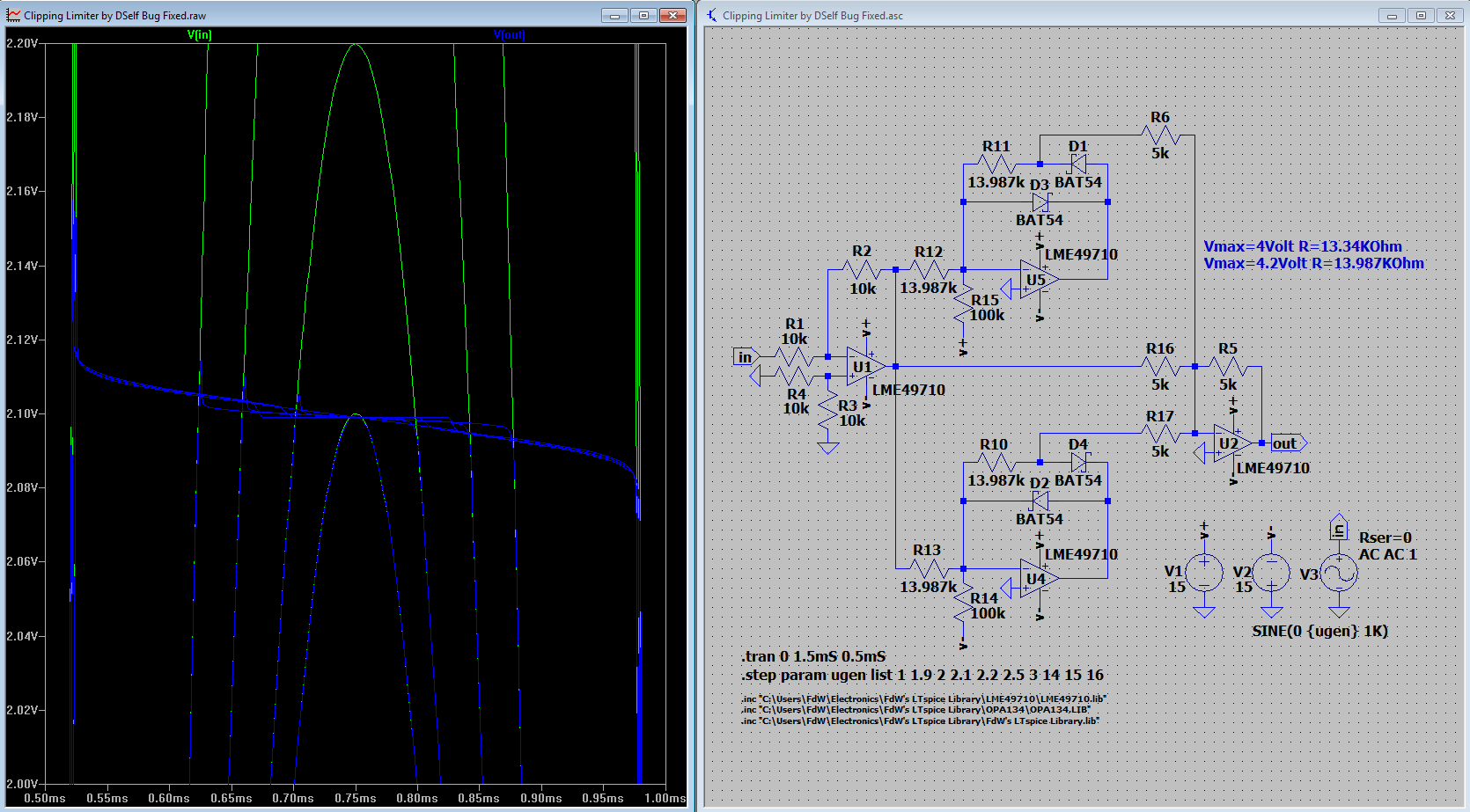

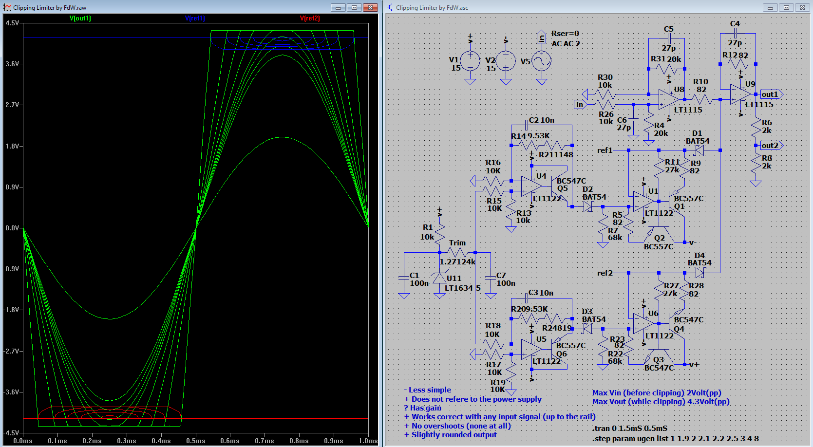

Incredibly complex it seems.... Can you give me some guidance ?
How could I implement that on the Nobrainer ?
I would not 🙂 the first one is a try to outdo D. Self (and it does) and the second one is the D. Self design (from his book (but fixed)) (it adds some HF artifacts that I do not like). Currently I'm thinking of a better, easier and less complex (but still secure and 'High-end' system) 🙂
Frans (Mastermind 🙂)

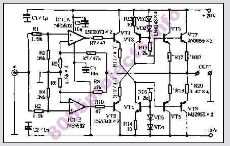

We talked about other ways to put Opamps at the input of a power amplifier.
I find this design quite interesting.
It is a kind of instrumentation bridge.
It gives a 20W class A amplifier.
Sorry for the hard to read schematic.
The original is that poor and i had to blow it up.
