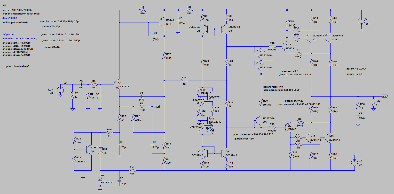

well, to use drivers collector resistors as 22ohm, I also used 22ohm for the same drivers emitters.
It seems almost good, but I do not have exactly the same currents in the positive and negative output collectors..... That might cause distortion due to the different gains of the upper and lower output transistors
I will try to null offset and see if both currents get the same values.
Now I am worrying about stability.... Most CFP output stages I have seen (appart from the original Nobrainer that I have built) use a compensation cap in the negative side driver.
I do not really know why this should be but should I use one of those caps ?
Don't, but do the impedances sufficient low, use base stoppers when needed and after that (when things are not stable) we will see what measures are needed.
Care about the offset, the unequal current will then be taken care of 🙂 (if you can see the logic of this).
Ok, I can null output offset and that makes currents in the output transistors collector dummy resistors almost the same but current in the emitters (positive to negative side) are not the same because current in BD139 is 24.6mA and current in BD140 is 33.3mA.
Maybe this is due to the differences in these transistors spice models..... Anyway the same "issue" exists in the original Nobrainer simulation and it works perfectly.... So we are good to go.

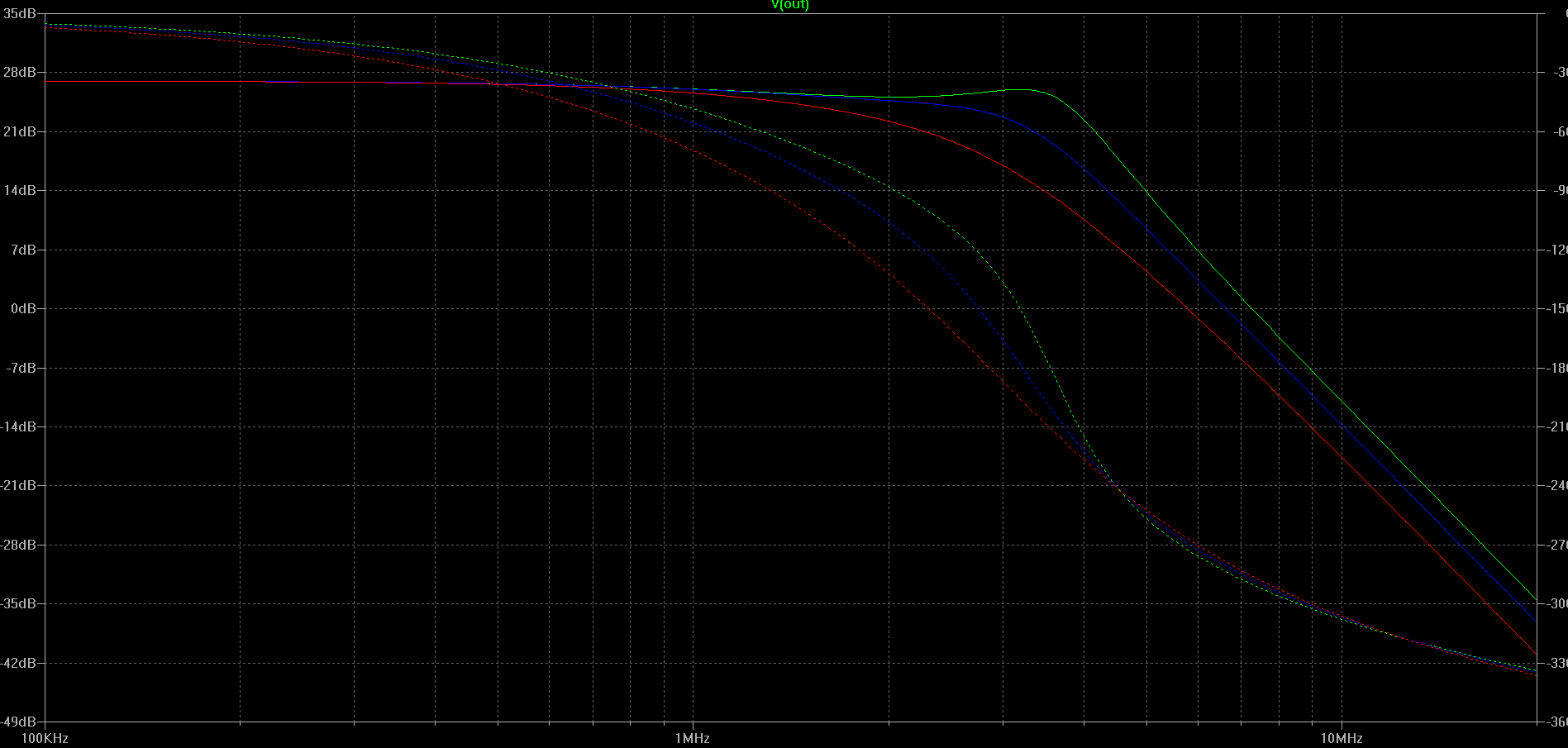

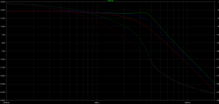

Stability sweep
Finally have time to study this amp again.
I have been looking at the stability and it looks I can use a miller cap as low as 10p as long as I settle with a value of C2 also equal to 10p.
Strangely, if I use a large C2 (30p for example), the amp looks stable even with a very small 6p for miller cap.
Am I doing something wrong or is this amp exceptionally stable ?

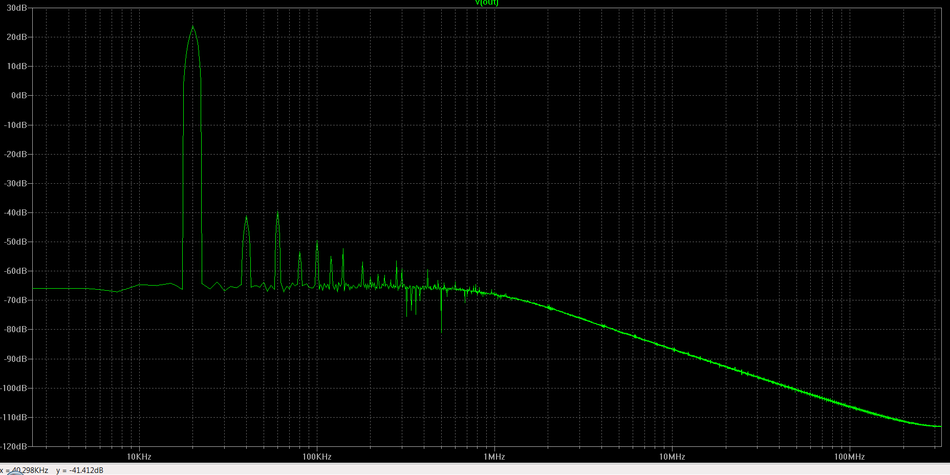

THD is a little under 0.1%, thats what i said.
Anyway, the prove is in the listening. It is more important that distortion is consistent with frequency and power.
In the new Audio magazine in Germany a singled ended tube amp got 140 points ( record ) and has much more distortion then this. Although mainly second and very monotonic.
