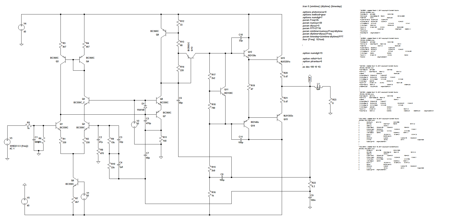

JG´s Nobrainer and Nobrainer Discrete
Output current limiting (shortcut protection 🙂).
Would you care to explain how it works ?
What are those diodes ?
My nobrainer blew one channel (again) when I switched on the manley tube preamp I am working on. (During power on the uge output caps take some time to charge and output offset goes from -10 to + 34v).

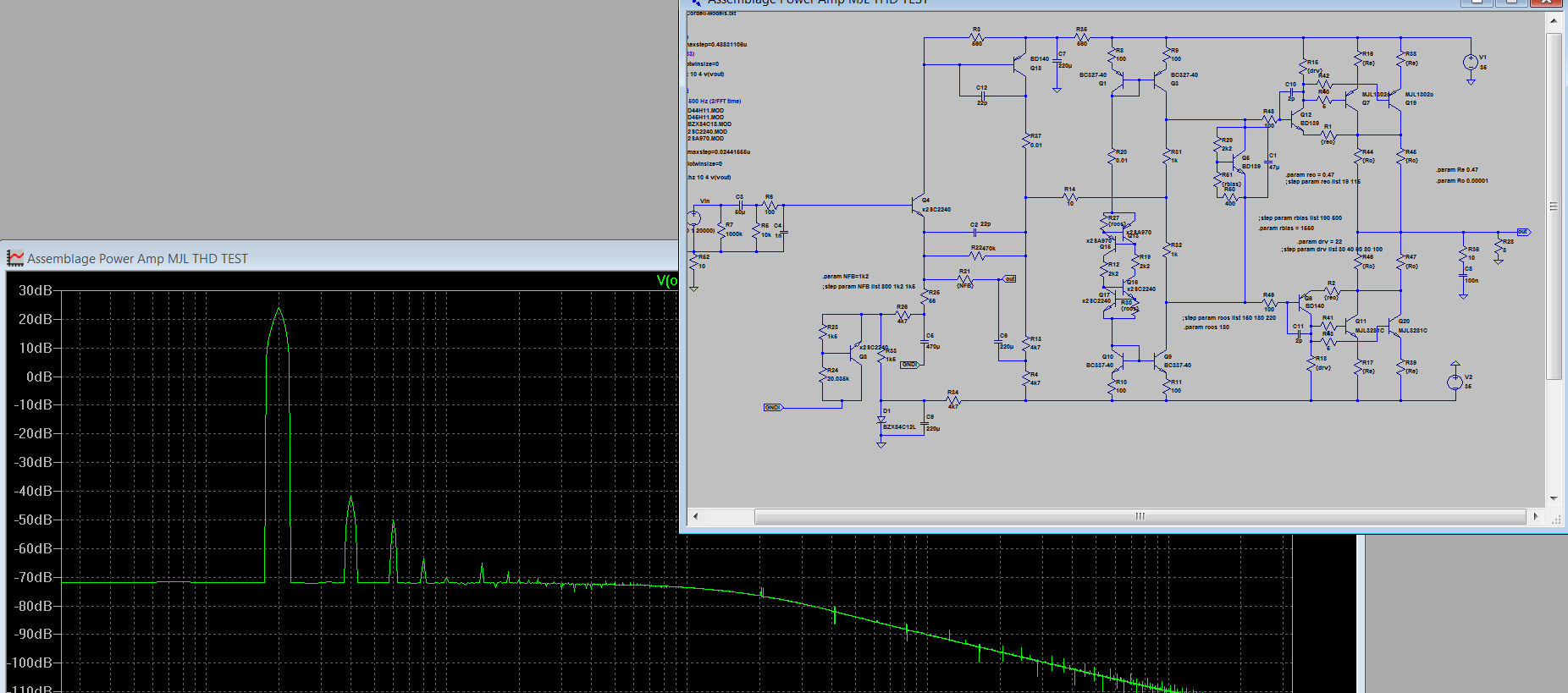

With a new configuration I got a much cleaner FFT at 1v input.
But idling base voltages on the output drivers came down from +-1.4v to around +-650mV
How low can I set the base voltages on the drivers ?

As voltage builds over R3/R4 and gets to Vbe+Vd ( = +- 1.3V) the transistor starts to short (sort of) the base current of the power devices, and directs it into the rail. As you can see this will probably kill the drivers 🙂 (unintentionally, this is not a very good amplifier (as noted before)).

You should not input DC into a DC coupled amplifier! Use a smaller capacitor (that may not work, if the lower frequency is set to 10Hz then the amplifier needs to survive 100mS of the rail voltage into the load) (the load will not like it). Use a output transformer on your pre-amp. Have a relay on the pre-amp that disconnects it from the amplifier as long as there is DC on the output.
There is a uge output cap on the manley preamp.
This preamp must be switched on 1 min before the power amp is switched on, otherwise there is a "thump" on the speakers.... in this case there is smoke in the nobrainer 🙂🙂
Now I have rebuilt the nobrainer and put fuses on the rails 🙂
What do you mean by 'set the base voltages on the drivers', be more specific 🙂
In the nobrainer, I have +-1.4v on the bases of the drivers in order to get iddle at 180mA on the output trannies.
In my new simulation, I only need +-600mV to get the same current on the output trannies.
What I need to know is what is the minimum base voltage on the drivers that keeps them conducting.
